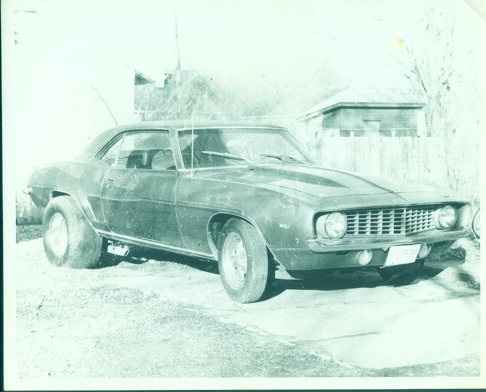

I have a 69 Camaro that I am trying to verify 100% that it is a COPO. I have been told that all of the COPO's were built in batches. I would like to see if anyone has a body number on their car that would be very close to mine. 12437nor369193 Thanks Ronnie

Ronnie,
You posted the vin. Look at the trim tag on the firewall, driver side. It will have a Fischer Body number and other pertinent info.

J. MacNeish's '69 Z28/SS/COPO book shows a COPO trim tag on page 172 with body #NOR369756, X44, 07A build, 50-50 paint & 715 trim.

That is the body #, the VIN # only has an 'N' not 'NOR'....

JUNKPIECE, what is the build date of the car from the trim tag?

I have been trying to get my car documented as a COPO.I have talked to Ed Cunneen ,and he doesn't have my cars vin nor body number on record, but will keep my info for future use.If anyone has anymore input , please let me know. My vin # is 124379n668711 , trim tag st69 , 12437nor369193 bdy 51 51 pnt, x44 , tr727 07a The trans is a m22 19n668711, p9d30c, 3925660, the rearend BE0620G1 12 bolt, big block heater box, ZL2 cowl hood, plate welded on the drivers side frame , no ac, no factory power steering, the tach is 7000rpm with a 6000 rpm redine the car does not have the original motor, I have a 327 in it.If there is any other info that can help, let me know. Thanks Ronnie

Ronnie, my copo is a 07A car and is undocumented so far. anyway heres the numbers. N665520,NOR366656BDY,BE0620G1. I see we share the same axle date. Hope this helps a little. anyone with any info please pass it on. Thanks, Tim. [img]/ubbthreads/images/icons/grin.gif[/img]
