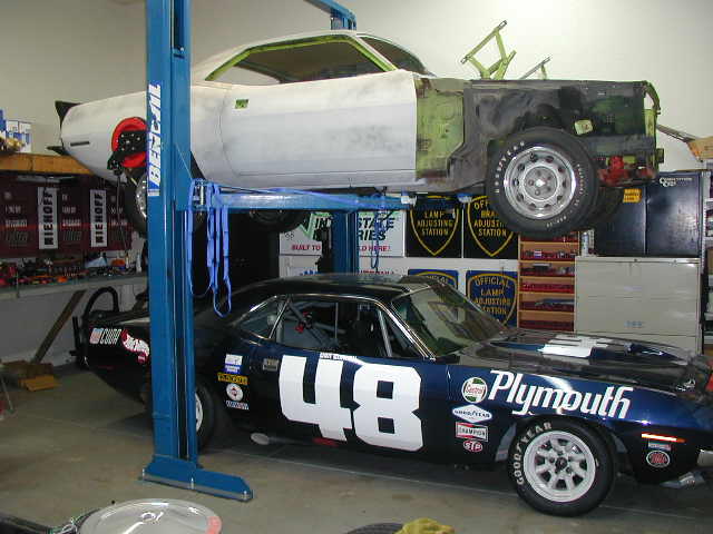

I am looking into buying an auto lift (probably 4 post) for my future garage. I plan on using the lift to store one of my Camaros & also give me the ability to do underbody detailing & some light maintenance to them.
I have done some Internet searching to see what's all out there for auto lifts. And boy, there are quite a few companies & models to choose from.
Any advice (do's, don'ts, recommended brands, etc) & info that anyone on this board can share with me on auto lifts would be greatly appreciated.

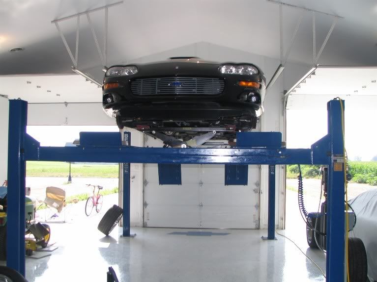

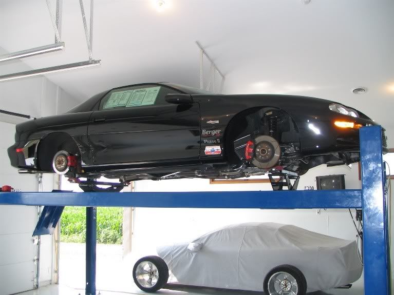

Well...........as Brad already knows............I decided to go with a Bend Pak 12,000 lb. four post lift similiar to the one I have at my business. I have four 7000 lb. two post Forward lifts, one 12,000 lb four post lift and one 9,000 lb. Hunter sissor lift at my business.
I have had the Bend Pak four post lift here in my shop at home since March, 2006 and have been happy with it so far.
Again, it is a 12,000 lb lift with two 6,000 lb. rolling jacks so I can pretty much do whatever I want here at home without going to my business (shop) to work on my stuff there.
J.D. Le Blanc

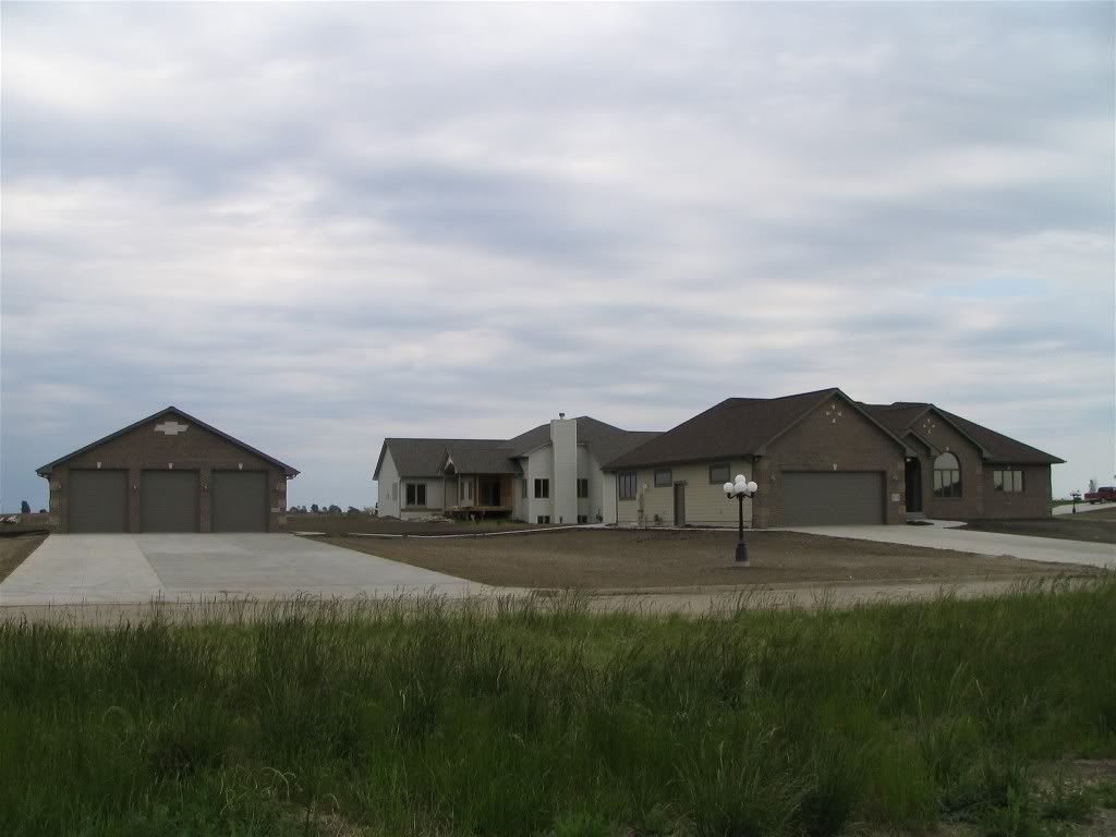

The shop is a detached from the house...........we built them both at the same time. The shop is 36'X44. My concrete guy wanted to know what kind of airplane I had as my driveway up to the shop from the street is 110'x36' and the approach at the street is 42'.
