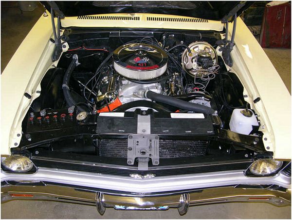

If you have a 68...then use a 68 setup. We run a hi-perf Stewart water pump and stat...4 core factory style radiator and a hd 6 blade steel fan. US Radiator makes a really good product...their Desert Cooler models work well.

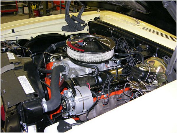

But the 68 setup is icky looking [img]<<GRAEMLIN_URL>>/smile.gif[/img]
All kidding aside, i've also heard they're prone to throwing off belts with the longer generator bracket used???

you can run a long W/P and 4 core rad, just cant use the clutch fan. The orig howl of the direct mounted fan is a blast (IMO) when you wind it up. The 68 long arm set up will work fine as long as the arm is straight, belt aligned and the nut is adequately tight on the bottom of the alt. good luck with the project
