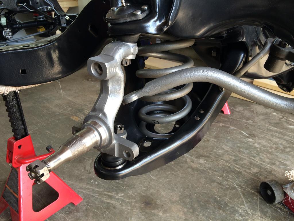

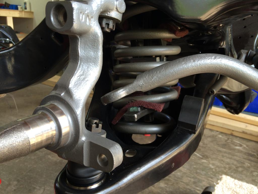

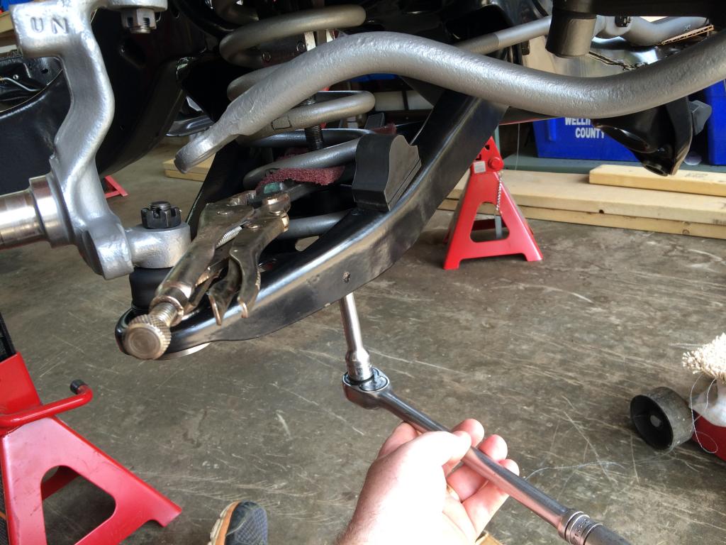

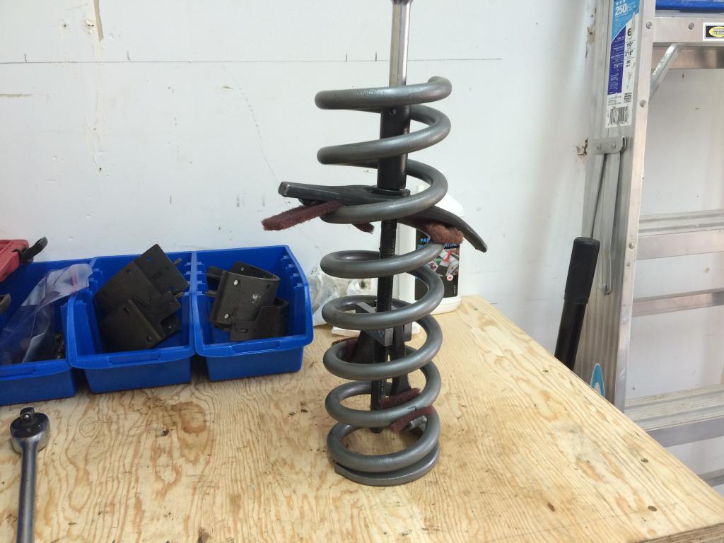

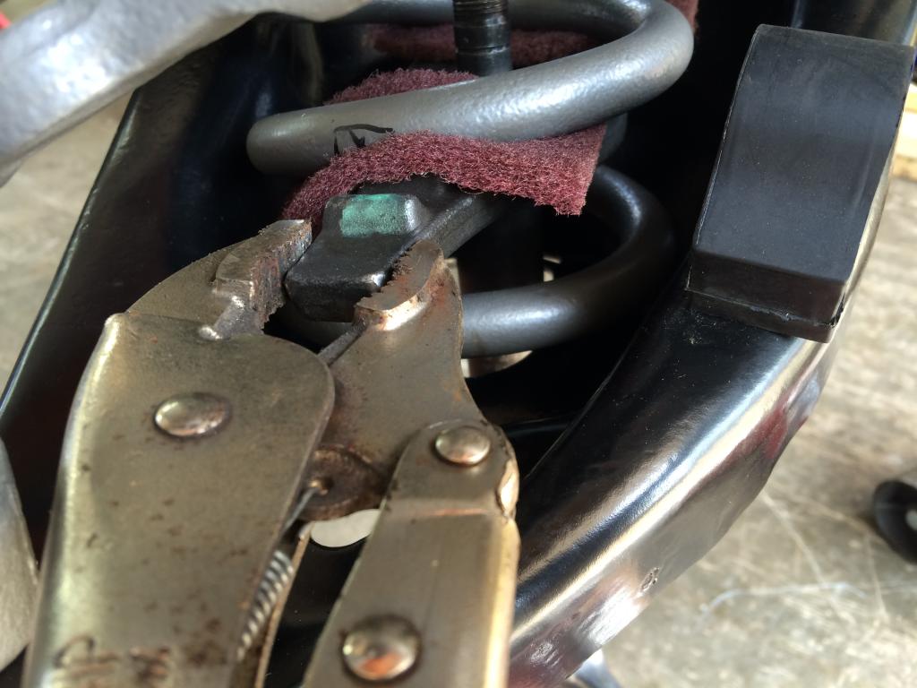

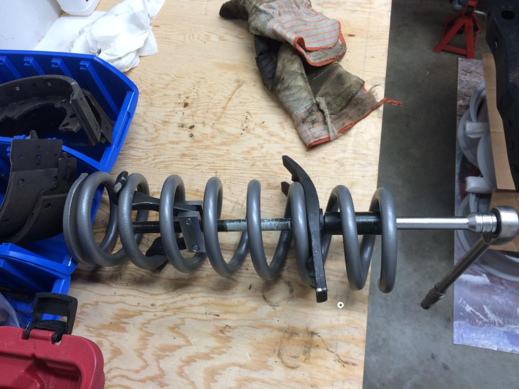

Passenger side coil spring install:-)

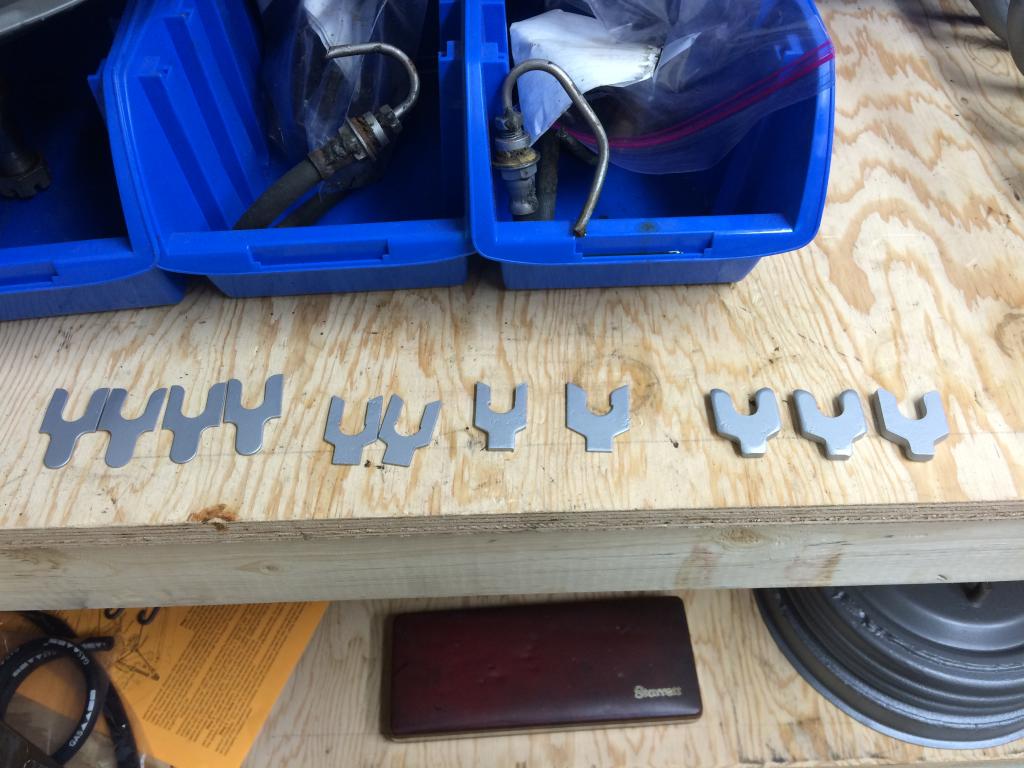

I media blasted my original shims and painted them, the inline tube shims don't really look like the originals:-(
It took a bit of trial and improvement to get the spring compressor located in the spring perfectly so I could compress the spring enough to install and yet still remove the compressor, and not interfere with the upper spring pocket, or lower control arm....... I took the pictures to try to replicate the set up for coil spring number 2:-)
My only issue was that the powder coating is slippery and the compressor spoon wanted to slip/rotate up the coil and the hooks wanted to slip/rotate down the coil. (If that makes sense?) (basically the compressor wanted to rotate on the axis of the coil spring instead of compressing the coil spring) so I added scotch brite for traction on all contact points and it did not slip at all after wards.
I wish I had time to do the driver CS today but lots of other fun stuff planned, only time to post a few pics and go.
Ryan

have the same compressor, i've used heater hose on the flat end to keep it from slipping

Good idea, that would work nicely as well.
Ryan

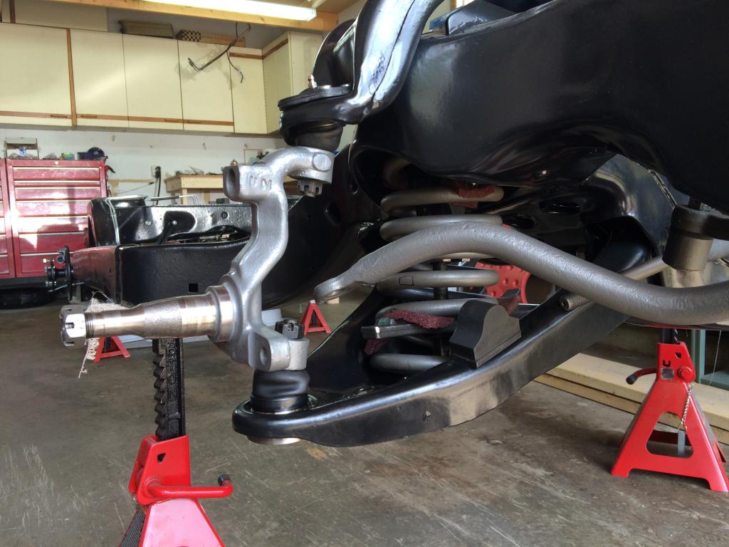

Drivers side coil spring installed &quot;I can't believe it's not butter&quot;
Smooth!!!!!
Ryan
PS: Now started to put the stabilizer end links on just because they were handy, but hard to get the thread started, put them together and tightened them up a bit out of the car to get them squeezed a bit.
