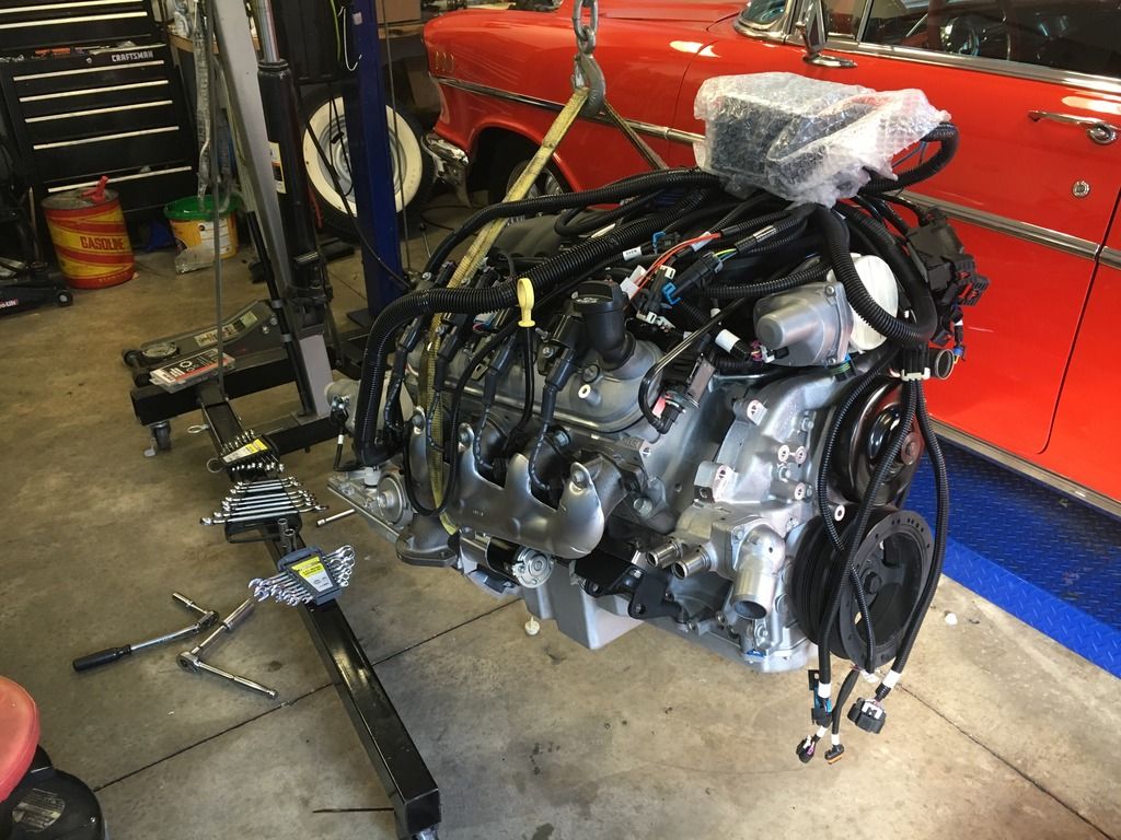

I met Andy at the Elkhorn Swap meet a year ago and we were talking about the LS swap into the 66 Impala Convert.....We got hooked up again in early summer this year and were talking about the Ackermann issues these "B" body cars have........Ended up Andy had the GM Service Bulletin from 1966 resolving these issues .........Anyhow......Here we go again........LOL......

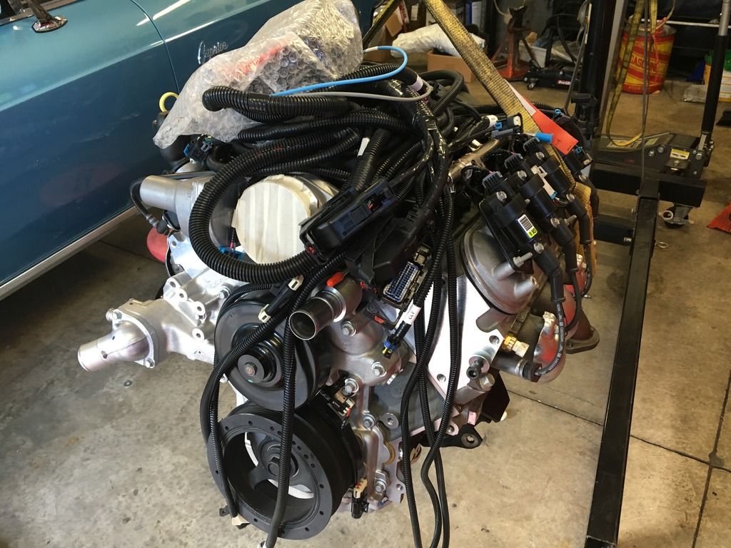

Staring point is a pretty nice rust free Caprice.........Putting in a LS3 480 HP/4L70E GM connect and cruise set-up just like we put in Gary and Keith's cars.....

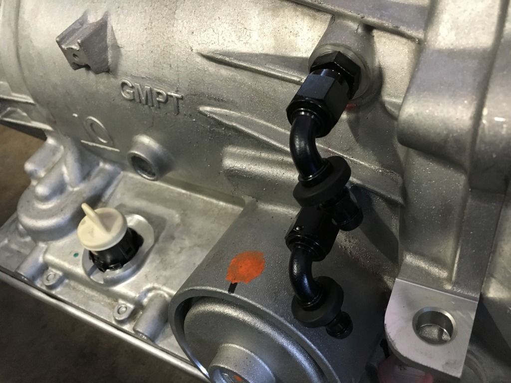

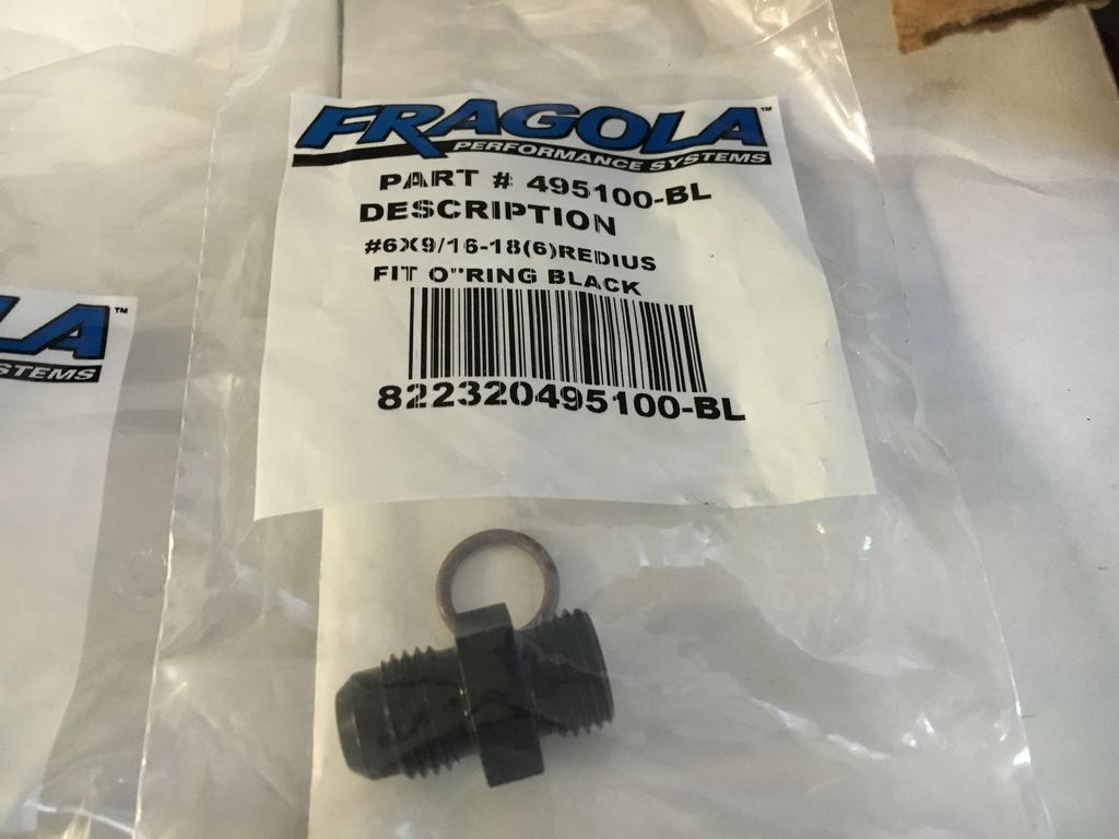

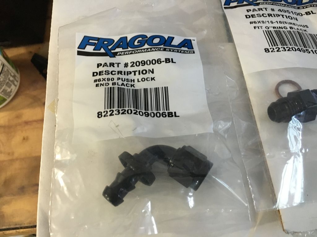

The trans tunnel is tight in these cars and getting the cooling lines out to the radiator is simplified by getting rid of the factory fittings and going aftermarket with trans rated rubber hose......

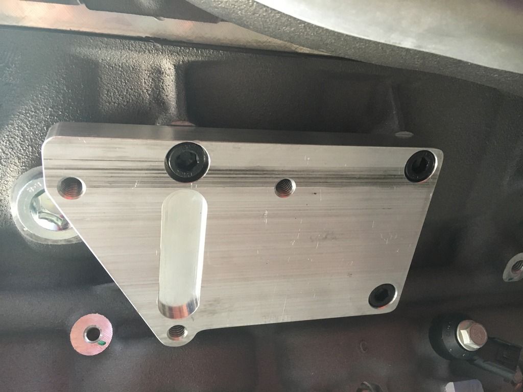

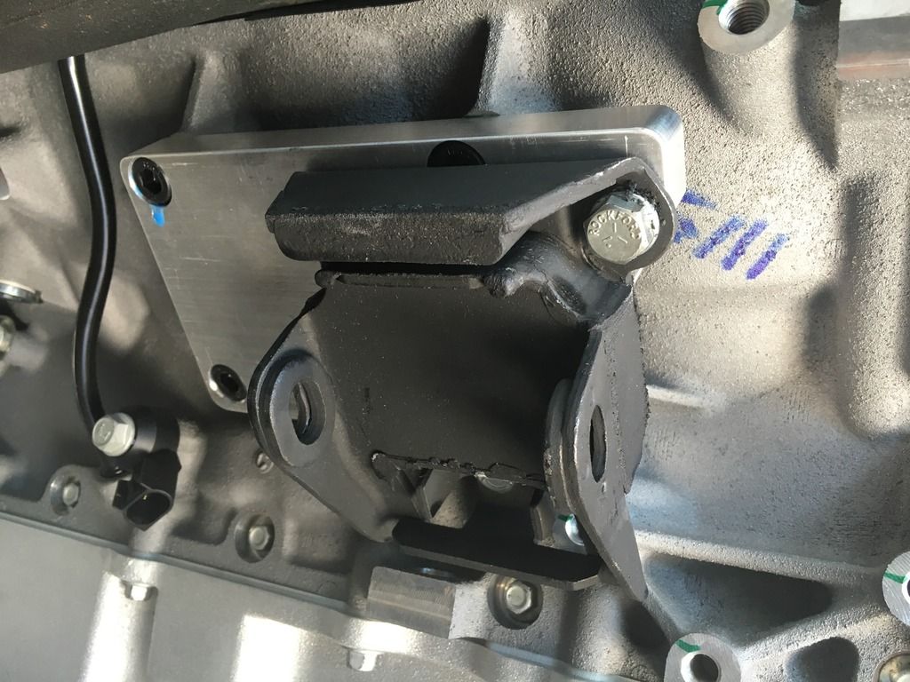

The next issue is the Holley 302-1 pan contacts the front cross member.......I made up some engine mount adaptor plates to raise the engine a 1/2" to resolve that issue...............

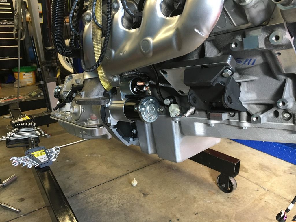

Got the starter and converter bolted in.......Then the wiring........LOL.......Probably get it in the car tomorrow
