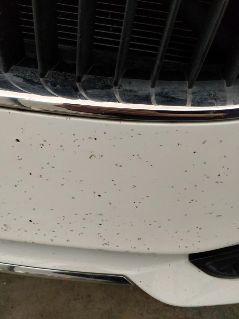

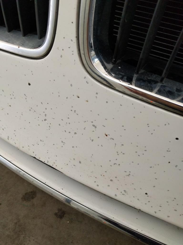

Good luck. Here are the pics, pretty ugly.
