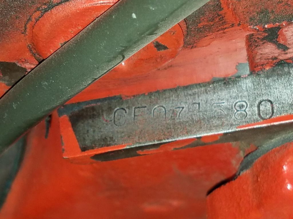

Old 11-04-2018, 12:47 AM
Pat_Dilling's Avatar
Pat_Dilling Pat_Dilling is offline
Join Date: Mar 2015
Location: Olivehurst, CA
Posts: 82
Thanks: 7
Thanked 1 Time in 1 Post
Interesting, and good to know info. The L72 in my Biscayne is also a 512 block, CE071580. Not that far apart, brothers or maybe cousins? Any idea how many of these engines were made to be sold? Were warranty replacement engines also CEs? I notice the stampings are also faded the same way.
