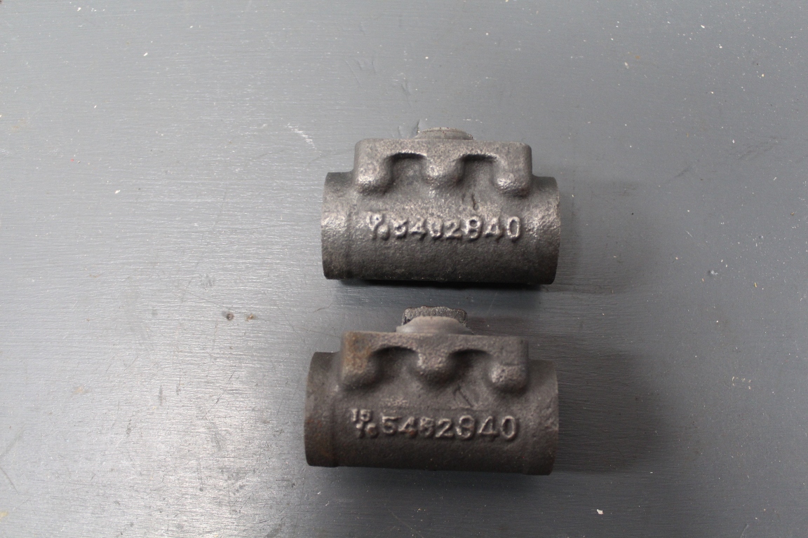

In that case if it could be somehow authenticated I would likely restore it how it SHOULD be not how it was. If I hear from other COPO owners that have the 68 then I will leave it. However, as so many of them have been previously restored that may not be the answer either.

Heard from another 69 SS396 owner and states the same as you Sam, 15/16".

I'll confirm what Sam has said about the wheel cylinders. I pulled these original cylinders from my '69 Chevelle, KK 4.10 axle and they are 15/16.

Maybe that 3/16" rear brake hose is somewhat standard too. I just have not laid hands on enough 69's to know.

I have seen them on "early" 69 chevelle SS cars like the black chevelle Ryan has described in an earlier post. Not sure about COPO's or Yenko's.

My June built Baltimore 69 SS vert had the 940 15/16 rear brake cylinders and the 3/16 inch rear brake line
