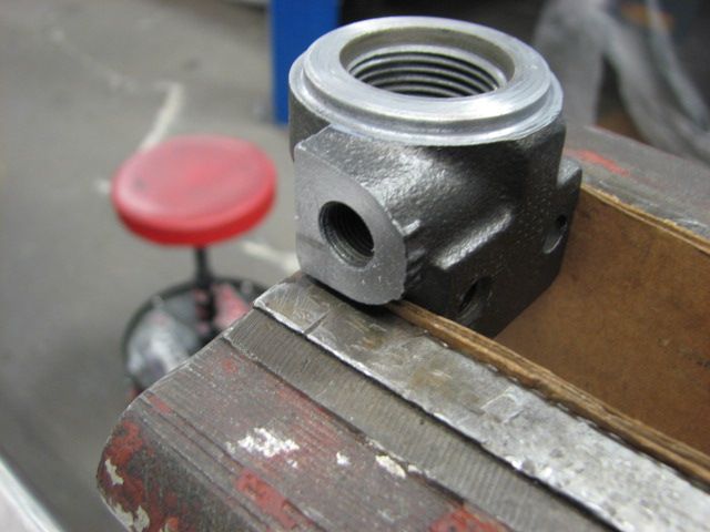

Last night we worked on the hold off valve, master cylinder and lines. Some minor detail work left to do such as stamping the front brake hoses and adding the "S" clip to the lines. The clip that holds the lines to the master cylinder is natural steel and has the part number. The bolt that holds the cad plated bracket to the master is one that I have never seen before so it was reused. After coming across a photo from the disassembly I saw that the brake booster was held onto the firewall with nuts and NO lock washers so I need to go back and remove the washers.

Where the master cylinders not painted black and then the machined surfaces would be natural? I know Camaros they were from the factory although it didn’t last no time. Just gaining knowledge.

My experience has been that they sometimes but not always put a flash coat of black on them. They were then machined on the front where the code was stamped as well as the two flat surfaces where the outlet lines were attached. I restored ours with a light flash coat of black and then machined the surfaces as can be seen in the photos. Our original hold off valve showed no signs of any paint on it so I restored it as such. I found no date stamping on either piece.
