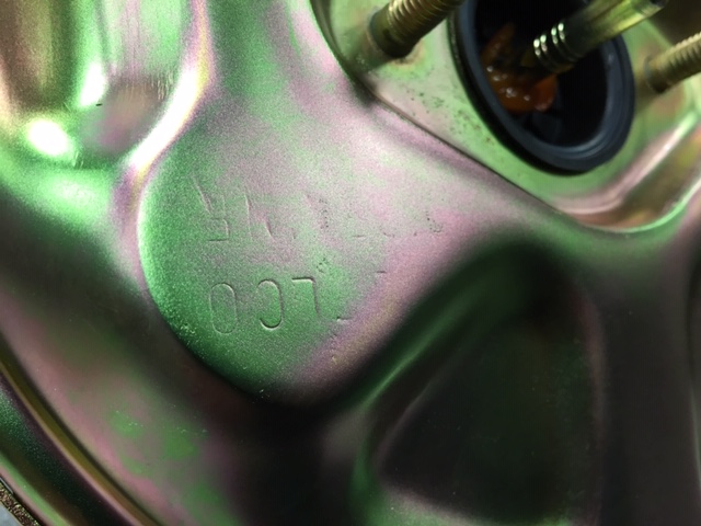

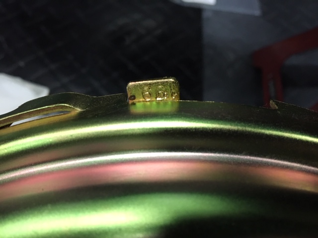

Received my parts back from Steve Gregori @ BrakeBooster.com - they turned out awesome! Booster (before/after pics) and related components are original to the car. Booster is a 9204 dated the 199th day. The ZL2 / horn relay covers and turn signal housings are also original to the car. ZL2 coil bracket is an original piece from Bentley B. Steve also did my hood hinges and latch components - also turned out great.
