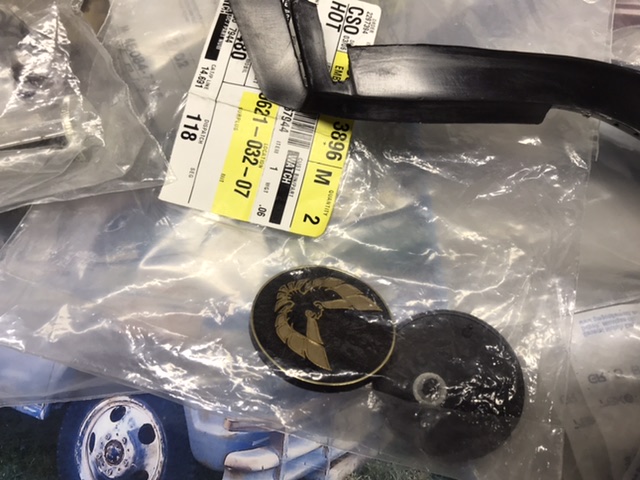

The strap is the same used to hold on the emblem to cover window crank hole. Ames still sells the box and the strap. Boxes have the jute glued on. Boxes may not be OG these days. May be repop. The bracket pop rivets on the speaker. I may have one on a bad speaker.

Burd, you lost me with the strap being the same that holds the emblem cover to the window crank. I’m not familiar with Ames, either.

Lol, speaking F body, if you have power windows, there’s a hole in the door card, they put a emblem in there to cover the crank hole, The retainer is same as speaker box.
Go to the Ames perf and look up the parts you need.

Here’s the emblem I’m talking about. Same retainer is used.

Burd , now I understand.
