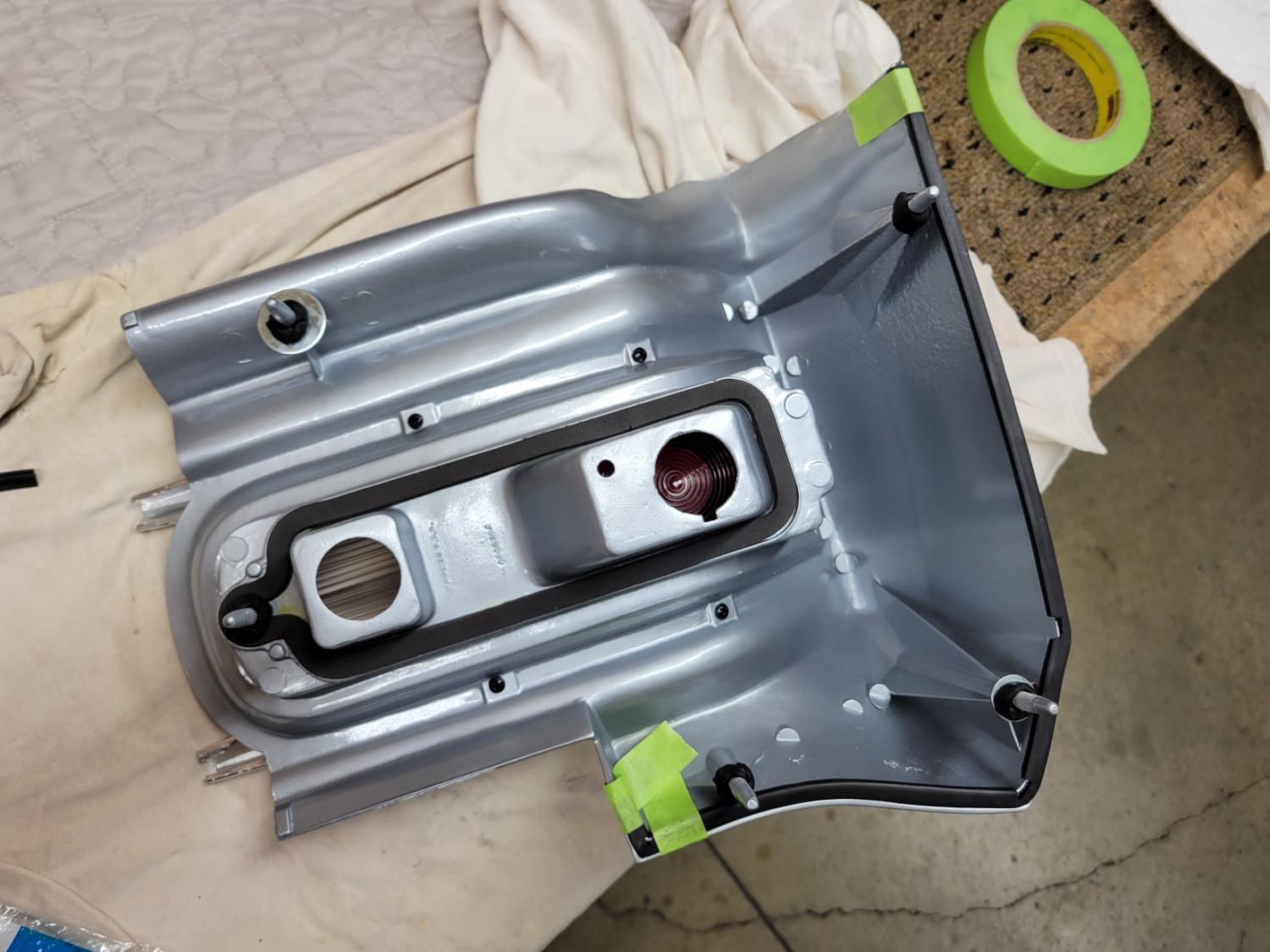

Finally back working on the car. Tail Lamps were recently assembled because I finally got my aluminum trim I stripped and polished back from anodizing. Most of the parts looked good but I finally spent time over break working a few grills and the ever hard to find eyebrow moldings. Will be sending those off in the new year. In the mean time here is the tail lamps. Alot of time taken to put it all together, put in the correct seals, hardware, and spacers. They fit the car very nice with even gapping all around.
One other thing I think many miss, there is a very small but useful edge gasket that goes around the outside of the bezel to keep a seal between the tail lamp extension and the quarter. Soft seal has a pretty nice reproduction piece to match the original.

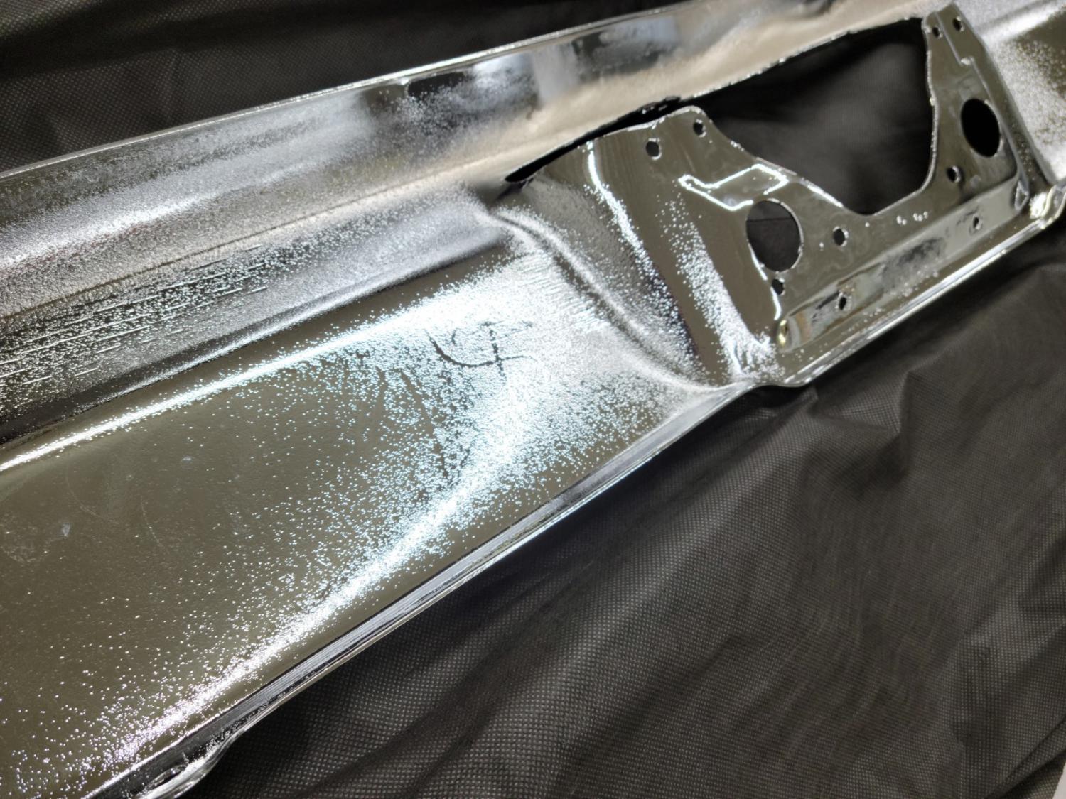

I still cant understand why the Flint assembly plant sequenced and marked the bumpers. I found it amusing that the 28 mark on the rear bumper could be seen post rechrome. Pretty easy to trace. I will probably be the only person in the cars ownership to know its there.

Thanks for the great pics, especially the correct headlight bezel painting. Glad you got back to this car. Guess you have another 4 months before decent driving weather to keep working on it.
Where did you find the correct tail light bezel gasket at the body ? All I ever see is the solid ones, with no cut out relief for the bend and they buckle. I cut mine and it isn't very noticeable, but it's still there and bugs me.
