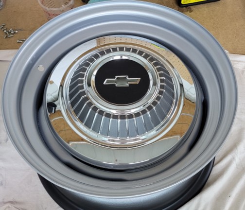

Default Rims and Tires
Ive decided to depart some from original on the rims and tires. The original size of rim and tires on these cars is laughable at best for a muscle car. Because of that I went with some new 14x6 rims, and redlines from the 67 model year. Im going with body colored rims and dog dishes.

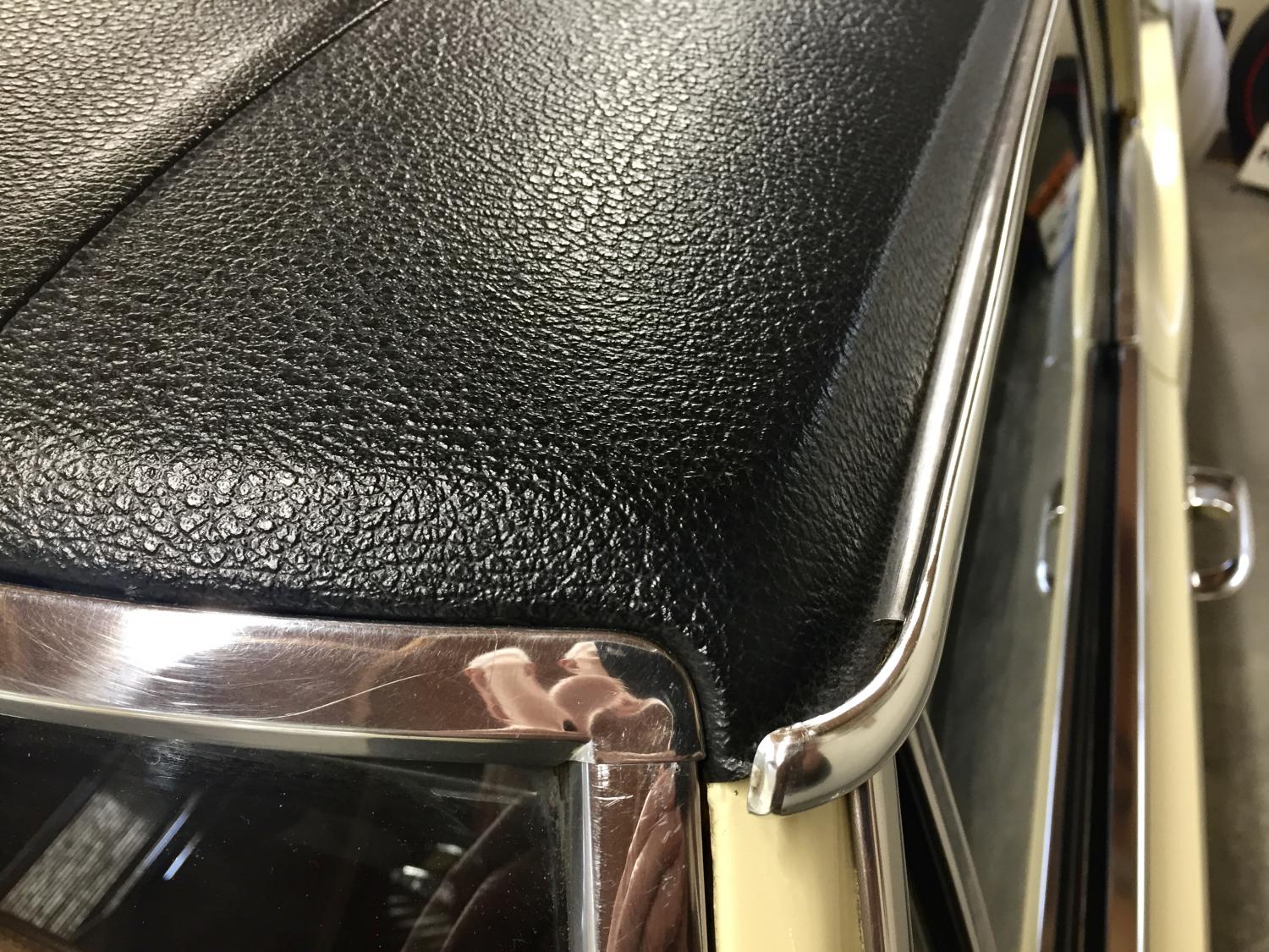

Factory vinyl (Cordova) top.
I’m a GTO (65-67) guy and the Cordova tops on these cars always received a flexible retainer. I’m not sure if the Chevrolet models used this item?
Shown below is this retainer on my ‘65 GTO Survivor.
This retainer was also used on the 66-67 Tempest Series cars with this fabric top, but in a different translucent material opposed to the chrome retainer on my 65.

Hi Chris,
Really appreciate the comments. I have noticed that for those that really get into the hobby, passion and obsession become a blurred line.
So my car did have those inserts when i was in the disassembly process. I have heard/read that some others have had success in removing them for reuse. I was not one of those people so i just glued the top down and installed the drip rail moldings.
Where did you get the page from? That something produced by Body By Fisher?

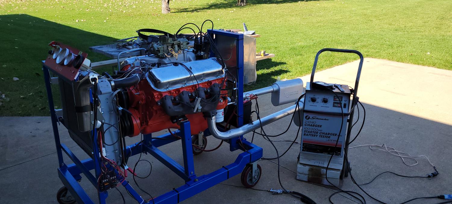

Default Engine Finally Back In and Running
After the flat tappet fiasco, thankyou Comp Cams. I yanked the engine put an erson roller and started the engine on a run Stand. I have determine engine run in stands are the only way to go from now on. All worked out great. The erson cam is most to the stock specs with just .010 more lift on both intake and exhaust. Opening and Closing valve events plus duration are pretty close and it sounds Excellent! As soon as the hood is on and i square away an alignment i will post final pictures for this project.
Engine running in the car
https://youtu.be/4_kYUOM9U1Y?si=bCC3UKCk0J3PiQTM

  #200
Old 11-11-2023, 10:54 PM
scuncio scuncio is online now
Posts: 14,084
Thanks: 2,880
Can you share the source for your engine run stand?
