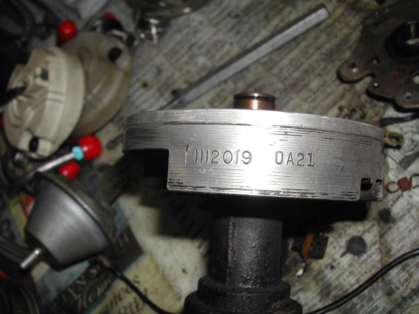

I will post some pics of my "shelf" 480 and 2019 (no Marlin, you can't have it ). They have the exact same housing finish.
It is impossible to certify a COPO or Z/28 as authentic without verifying that it is not a rebody...

Hylton, that ebay 480 looks like it may have been a 481 at one time. Tough to say for sure with the bad pic. *Edit: the vertical line in the middle of the 0 isnt where the one would be in the 481
Here's a 480:
