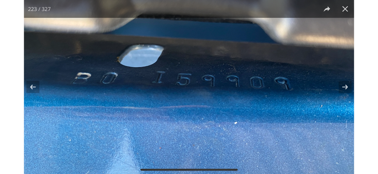

Attractive color combination, body number stamps on cowl and core support look good to me (with no typos-I've seen a couple). I've never seen engine/trans VIN stamp characters like these on 1970 Hamtramck built cars. They're typically gang stamped with narrow, squared off characters as shown in David Wise's book. Has anyone seen this style of characters/stamping on a 70 Mopar? https://www.mmcdetroit.com/Vin_Codes/
Attachments - The Supercar Registry IMG_8932.png IMG_8931.png IMG_8930.jpeg IMG_8927.jpeg
