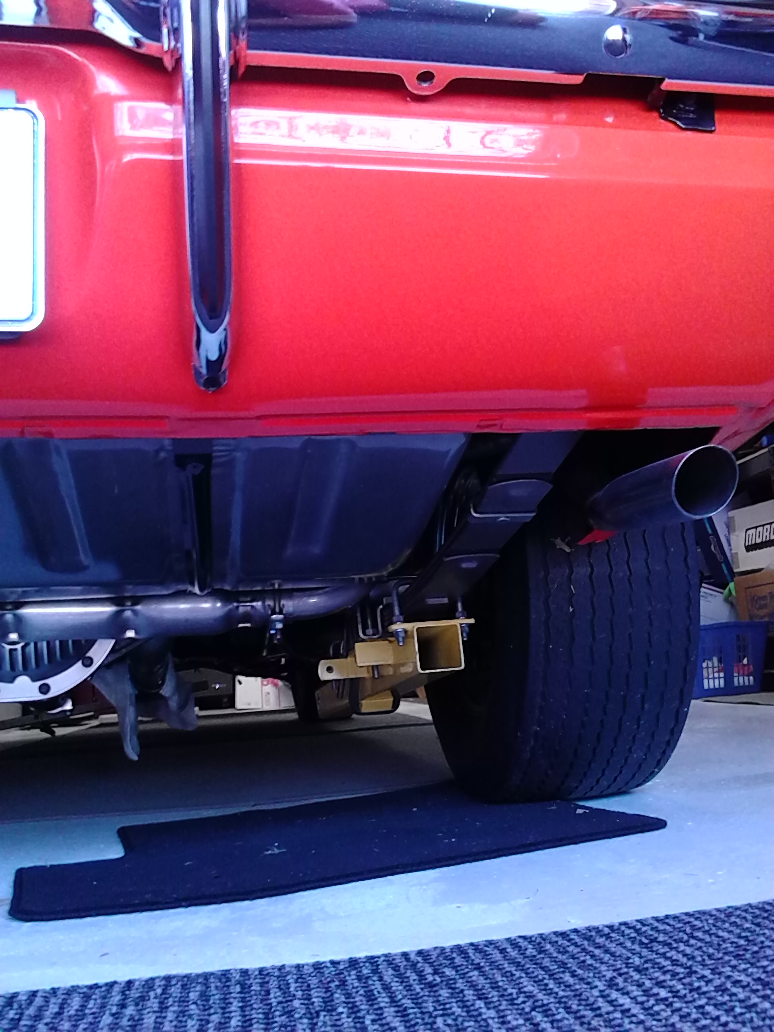

I have New Cragar S/S Direct fit 4 3/4.
8 1/2 "x 15 " with 4 1/2 " back space.
L60 -15 GOODYEAR. Poly Glass GT
YES. 8 1/2 " Width W/ 4 1/2" B S.....
In Direct fit from. SUMMIT. Bought them 2 Summers ago.
5 inches of Back Space on a Stock suspension is preferred with L60 -15./ 275-60 , 15's. If You Have the ORIGINAL REAR SPRINGS ......THEY HAVE SETTLED ,,IF NOT FLATTENED OUT.....
CRAGAR OFFERS. A 5" B.S. For Almost double the cost....
On the Front if you want a More Muscular Look
15 x6 /15x7 with 3. 1/4- 3 1/2 b.s. will kick the wheel out 1" max....using F-G 60's . should clear
everything...

8.5 wide? special order? All Chrome Cragars I have seen is 15 x8

In Stock @ Summit....I hand picked a pair out of 6 wheels... Direct Bolt Pattern...Not UNI -LUG
EIGHT &amp; A HALF &quot; WIDE. with 4 1/2 &quot; B.S....
2 summers ago.
