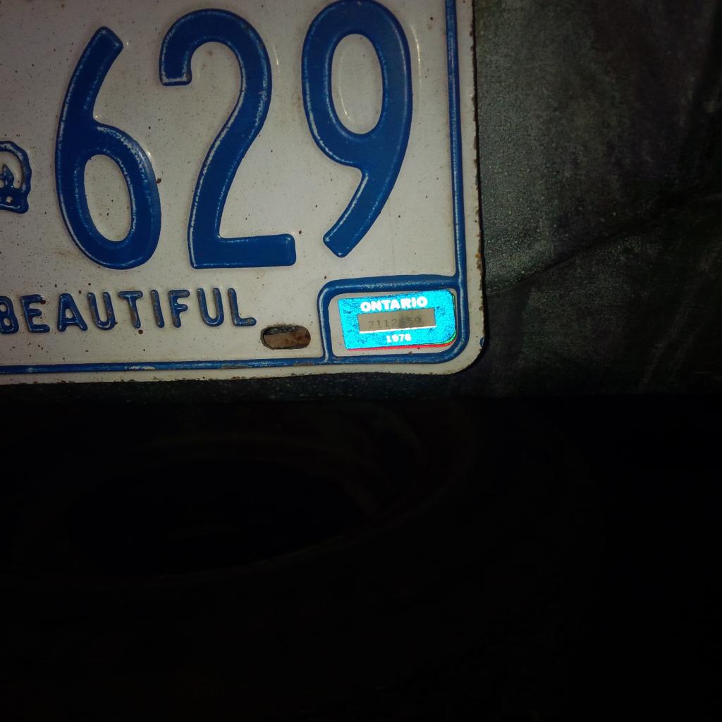

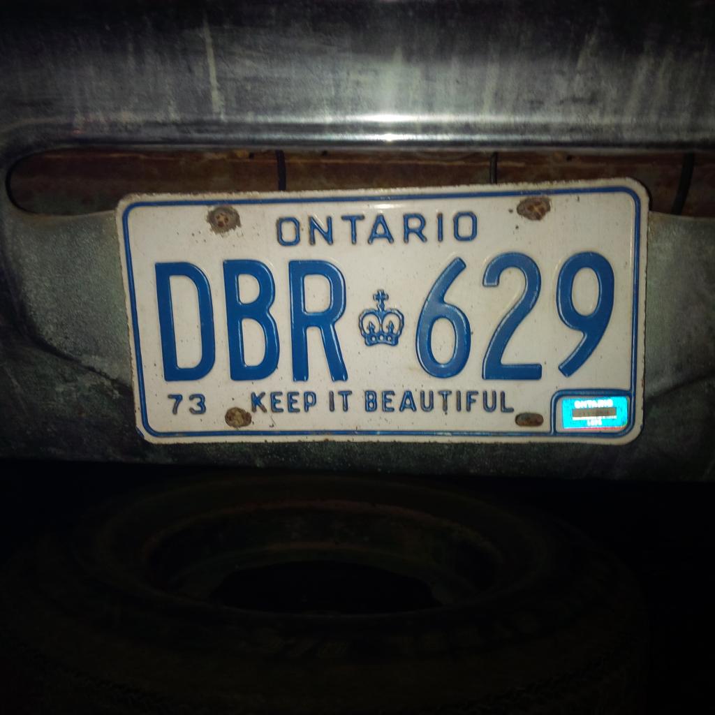

The first two pictures are from the MTO Ministry of Transportation, they show the 1969-1972 plates without the sticker, then the 1973 plate got the sticker and no longer had to be replaced every year.
The next two pictures are of the 1973 plates on my car with the last sticker purchased in 1976. I have Al's insurance slip but it is for 1975, so somewhere in there was her last drive:-(
