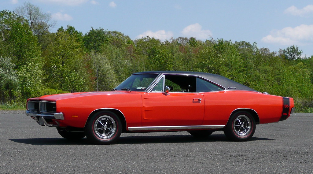

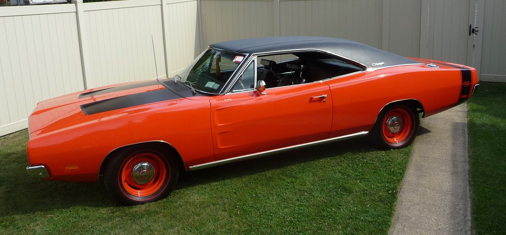

OP...very cool 69 R/T you have there! Mine was originally R6 as well. (Black top, interior also but V88 stripe delete) One day ill go back to the original color
Mine was originally an AC car as well. Curious as to the reason you made the discharge hose 2 pieces instead of the original one piece design? I see you had the hoses replaced...were they not able to keep it one piece?
Heres a few pics of mine...I took the liberty of adding a few factory options to mine over the years (V21 hood treatment & J45 hood pins, electronic ign, charging etc) Ive had her for over 20 years and after a while you get bored of just putting gas into her LOL Swapping wheels etc only goes so far!
I enjoyed the pics of your resto and it looks like a lot of care & attention to detail went into her! Good luck!
