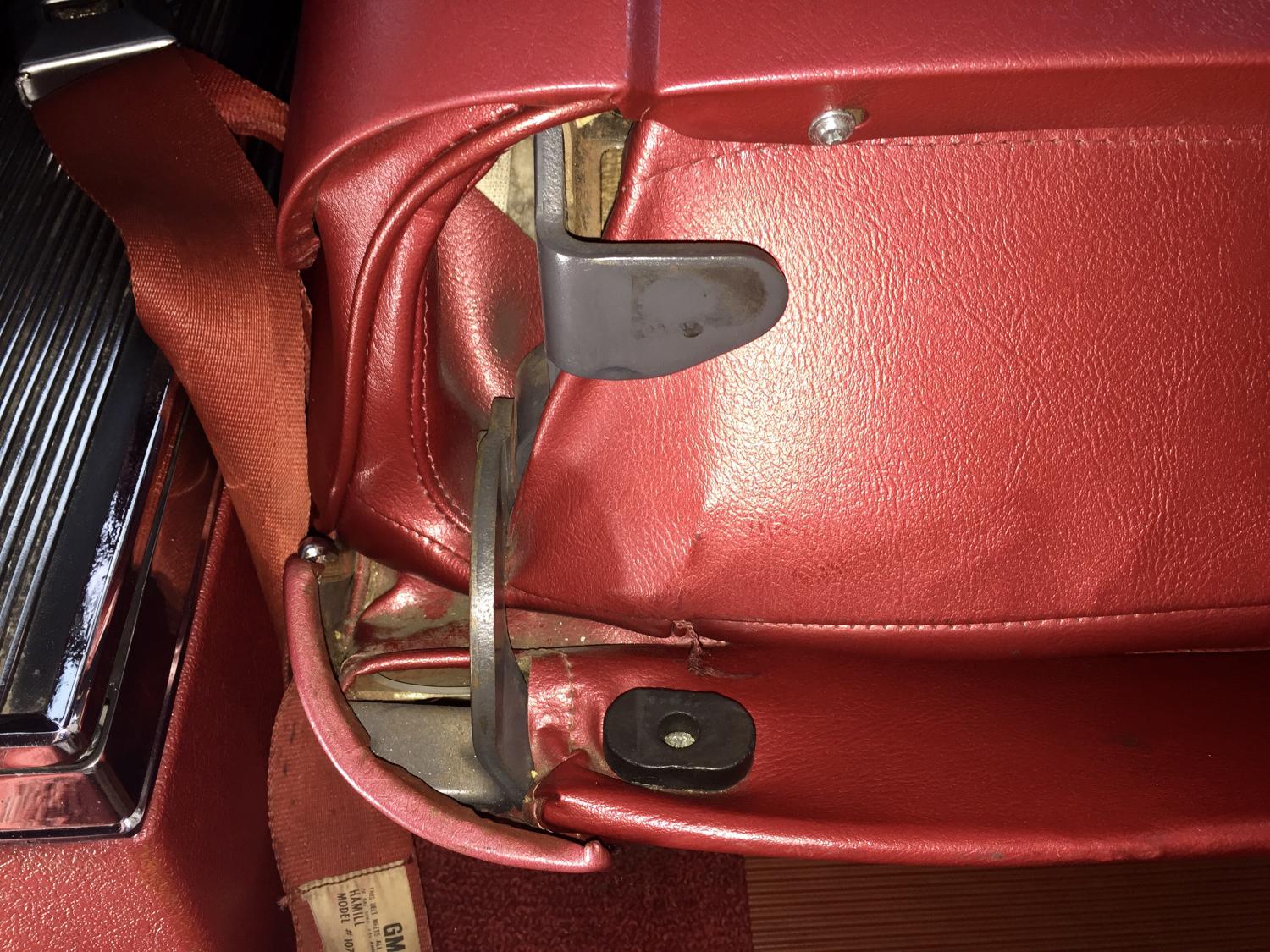

Hey Bruce,
I have a question on the RH bucket seat back in your ‘66.
When you fold the upper seat back forward is there a odd bumper with a spring steel catch device?
My ‘66 GTO Survivor has this item.
Some type of safety feature (won’t allow the seat back to fold forward when unoccupied in a panic stop) before the 67 seat back lock came out.
It seems not all the 66 GM cars have this.
LMK, thanks, Chris.

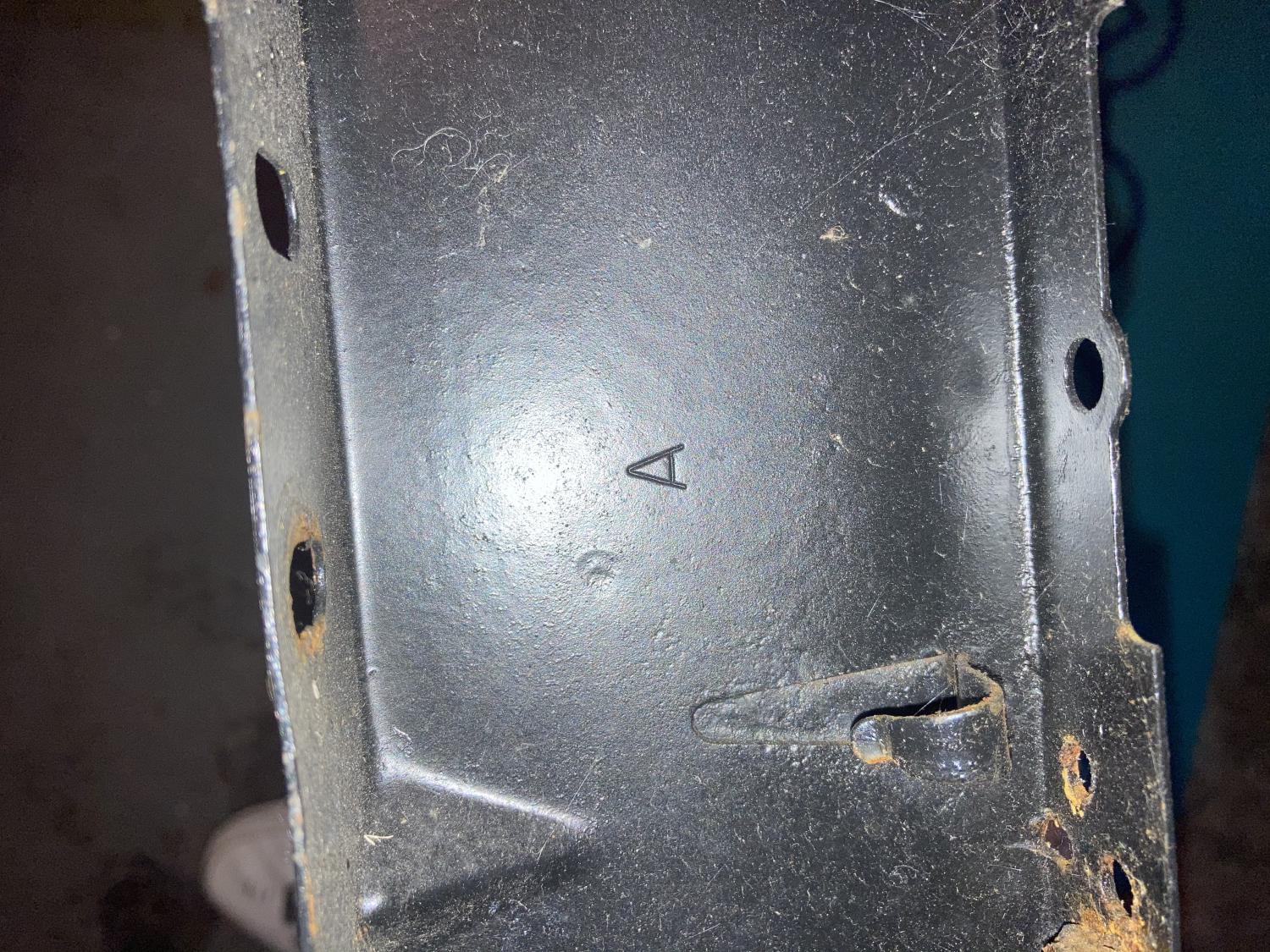

Note the Upper Tank code in your photo.
Letter G That’s a July rad. Probably of 67. Over counter replacement. Hence the filled/capped holes.
Side of Rad. on strap. Driver side. You will find a stamped letter code also. Likely F G or H
Example of letter A here
