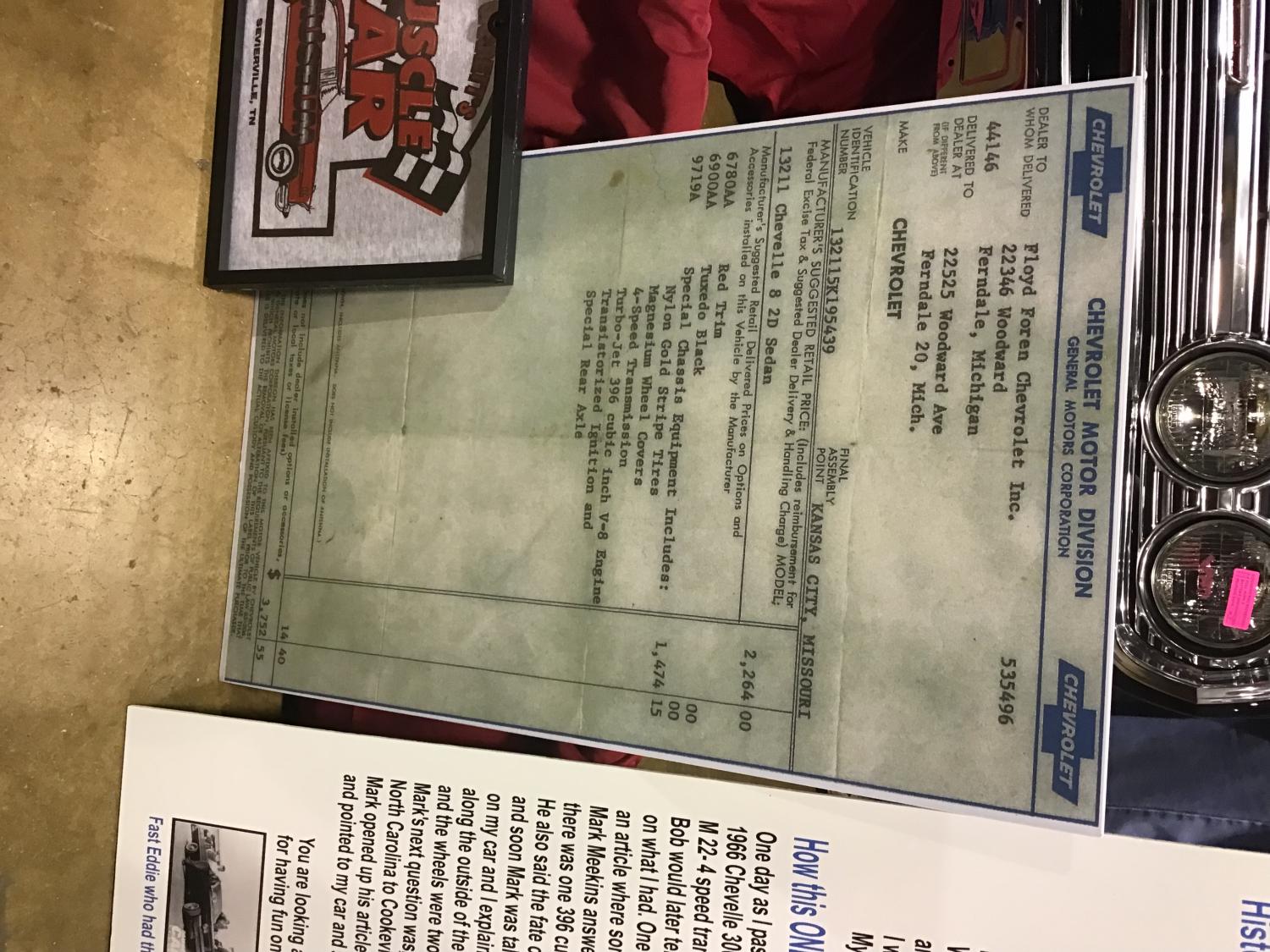

No one purported that the photo with the race car was in fact this car. Bill just found that pic searching around and sent to the current owner. I was asking if that car in the pic was in fact a 64 because I did find the attached ads, thinking this may be the car.

Given the fact that the photo and the email from Jim Mattison to Floyd are displayed together in the back window of this black car, I think most everyone would assume that they are indeed the same car.

This car has been discussed before and I always asked to see the paperwork that shows it was factory built on a COPO order. The document shown looks like a window sticker.
From what I have seen documented, the first known use of a COPO to build a high performance car are the 1966 Corvairs Yenko ordered to build the Stingers.
Including COPO 9513A (3:89 posi gear) and COPO 9981A (wheel cover deletion) and other COPOs.
There were high performance Corvettes and full size Chevrolets and Chevelles built before 1966 but they used RPOs.
Including RPO Z06, RPO Z16, and RPO Z11

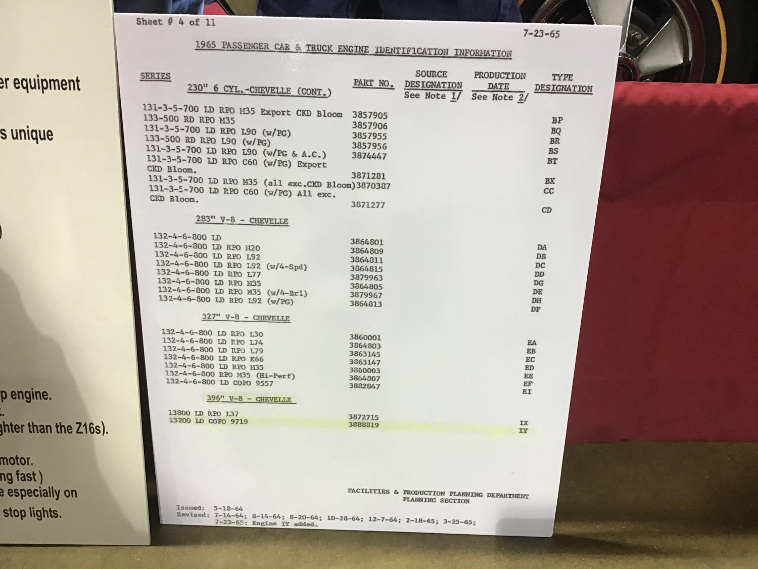

Here are some more picas including the story on the car. Also attached is a document provided by Jim Mattison showing the Copo motor installed in a Chevelle 300. Copo number also appears on the window sticker. As information, all the original drive train was missing when this owner bought the car in 1968 and has been replaced.

Interesting this about this Copo, uses some of the same components from the Z16, Boxed chassis, riveted wheels, Mag caps, larger brakes.
