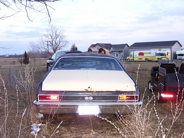

here are a few bad pics. i'll get more soon. if i can figure this file thing out.

Awesome!!! Nobody is faking anything on that car - sure looks like an L78. Since it's an October car, no rear sway bar (not available until Jan of '70). I see the TCS switch hanging on the firewall wiring gutter - last 3 digits of the part number stamped into the top should be 573.
Car looks good, great color!!!

thanks . my origional thinking it had a white vynil top was wrong. the a i was seeing is in the 3rd row meening black interior trim. and the color is stamped twice 28-28 so i was even happier to learn it was all fathom blue.
i want to thank everyone for the help in researching this car. it has been a blast just finding it and researching the mistery.
now all i need is some pics of a 70 fathom blue bench seat 4 speed 396 car. thanks again.
