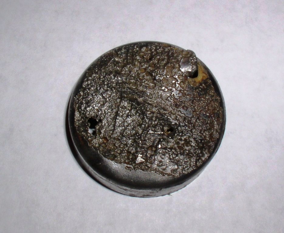

Tap water is typically loaded with dissolved solids that will boost conductivity. As a result, you can create a galvanic corrosion cell within the cooling system.
The stainless freeze plugs referenced in here (US Tool) have been great for us. Stainless has a lot more strength and is stiffer than brass so they tend to stay in place better as well.
