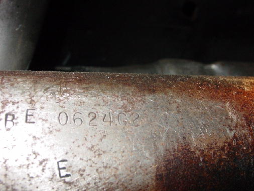

CJP, Does your BE stamp look like this? Do you have a picture?

Shor,
The characters are just like that with the date being 06 11 G2. A buddy of mine will try to upload a copy of a few digital photos he took before his battery died. You can just make out the BE and the date with the E underneath for Eaton posi.
