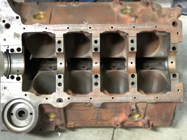

hi guys
sorry.........had to restart the thread as i could not see how to add the pics of the block to the original thread
so as started it is:
- a 4 bolt main
-0010 casting
-010 020 nickel block
-prefix stamp T0606CTB
1970 nova
car retains its original key fob and trunk dealership emblem
sbc
with 2110 intake
202 #186 heads B.19.0 AND B.18.0 dates
4 spd M21
12 bolt 4:10 posi-trac
i could not find any date casting number on the block?
thx
chris
1970 citrus Yenko Nova

Chris - Sorry to say the block has been decked and the T0606CTB re-stamped. You can faintly make out the previous stamp code "YZ" under the CTB.

100% a restamped block. 1 No broaching on deck 2 also a YZ shadow from past stamping 3 machined lines from deck being resurfaced. Who ever stamped it didn't do their homework on fint and tonawanda built engines. Sorry it turned out this way. To many people think they can get away with stamping blocks and a lack of knowledge.

Man! I agree that when you see the stamping distortion over a decked block it seals the deal.
I do have to say that the characters themselves probably would have fooled me, had it not been for the obvious decking.

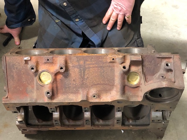

The casting date is in the same area as the 3970010 GM casting on the top of the bellhousing area, but on the other side (passenger side) of the block. Its in the form "Letter"(letter of month, A=January), space "two digit number" (day of month), space "single digit number"(last number of year).

Definitely a restamp, No way the stamp fonts would be that “crisp” after decking, looks like it was decked on a Storm Vulcan block master . A lot of the fonts are incorrect too.
Does it have the small 1/4” front square head plug above timing cover on pass side?

Possibly a truck block from 1975 TYZ ? The decking machine may have dug down deep enough to take out the T maybe? St. Catharine's, Ont. foundry truck blocks have the date cast on the side of the block in large casting digits.
Nope, urban legend, those are just mold identifiers.
