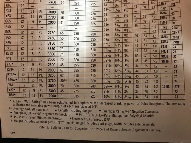

Didn't the late 69Z use a Y77?
Doc.
Old 12-03-2019, 12:20 AM
427yenko 427yenko is offline
Join Date: Feb 2009
Location: Minnesota, USA
Posts: 124
Thanked 11 Times in 6 Posts
It did use the Y77. The Y89 is what I believe to be one of the replacements for the Y77 and may have been a production line battery for later/different models? The Y77 had two different size terminals. The Y89 is a standard 3/8-16 terminal size battery. The negative battery cable or bolt had to be changed when the Y77 was no longer available. I think the Y89 came out around 1974? The Y77 was a one year only battery. Very rare.

also believe the Y87 was another replacement for the Y77. Again uses both 3/8 terminals.

Seems to me that the Y87 was a different physical size battery but I may be wrong on that.

well the Y87 has a length of 9" height of 7-1/2 x 7" wide . Is the Y89 the same?

I believe the Y55 was replaced with Y77 later in the year. Also R59 was replaced by the R79 later in the year.

Delco Dimensional Group Sizes: The Y-77 and Y-87 were Group 72 where as the Y-79 and Y-89 were Group 74. See chart for all battery specs...
