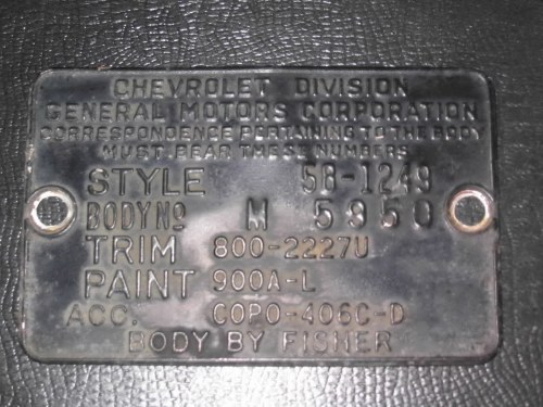

‘58 Delray Tag below Verne F. shared years ago w/ Copo on ACC line.
RIP Verne, sure miss your input around here brother.
