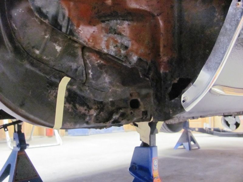

The passenger side lower area of the three panel sandwich was as we thought: the outer piece was rusty and the inners were pretty good. The problem was that the inner sections were rather mangled from the tie downs used during the transport so the inside section had to be cut out and redone to make it flat again. Here's some photos from earlier in the week.
Here's the bad area prior to trimming:

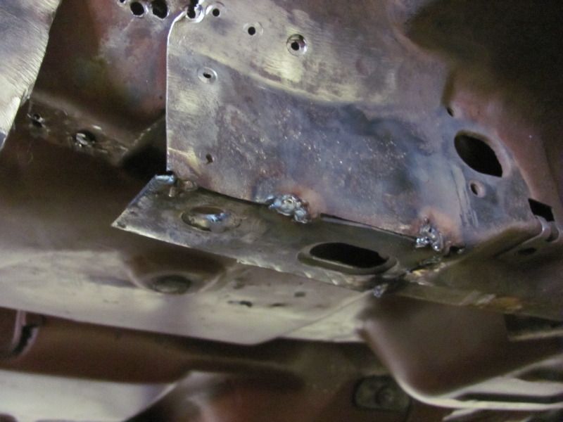

And the mangled bottom of the inner rail/spring bucket that has the tie down holes. They were pulled and ripped out of shape.
He ended up cutting the section out and remaking it so it looks correct once the new section of rail gets welded back over it.

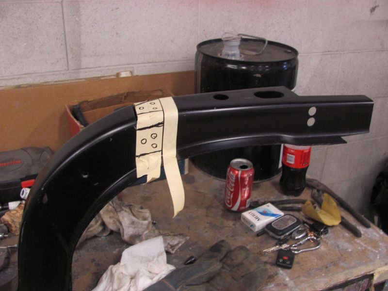

And the portion of the replacement rail that will be used:
