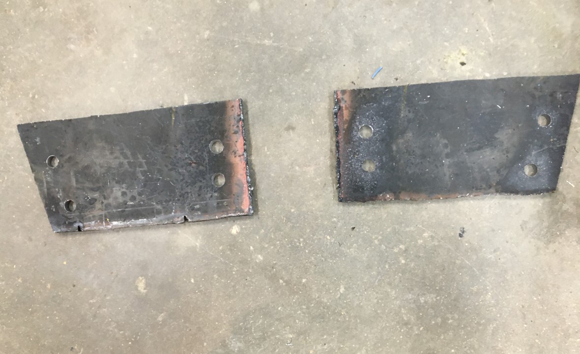

A friend with a small CNC plasma machine cut some "patch" washers.
Cut out the rusted areas and fit the washers.

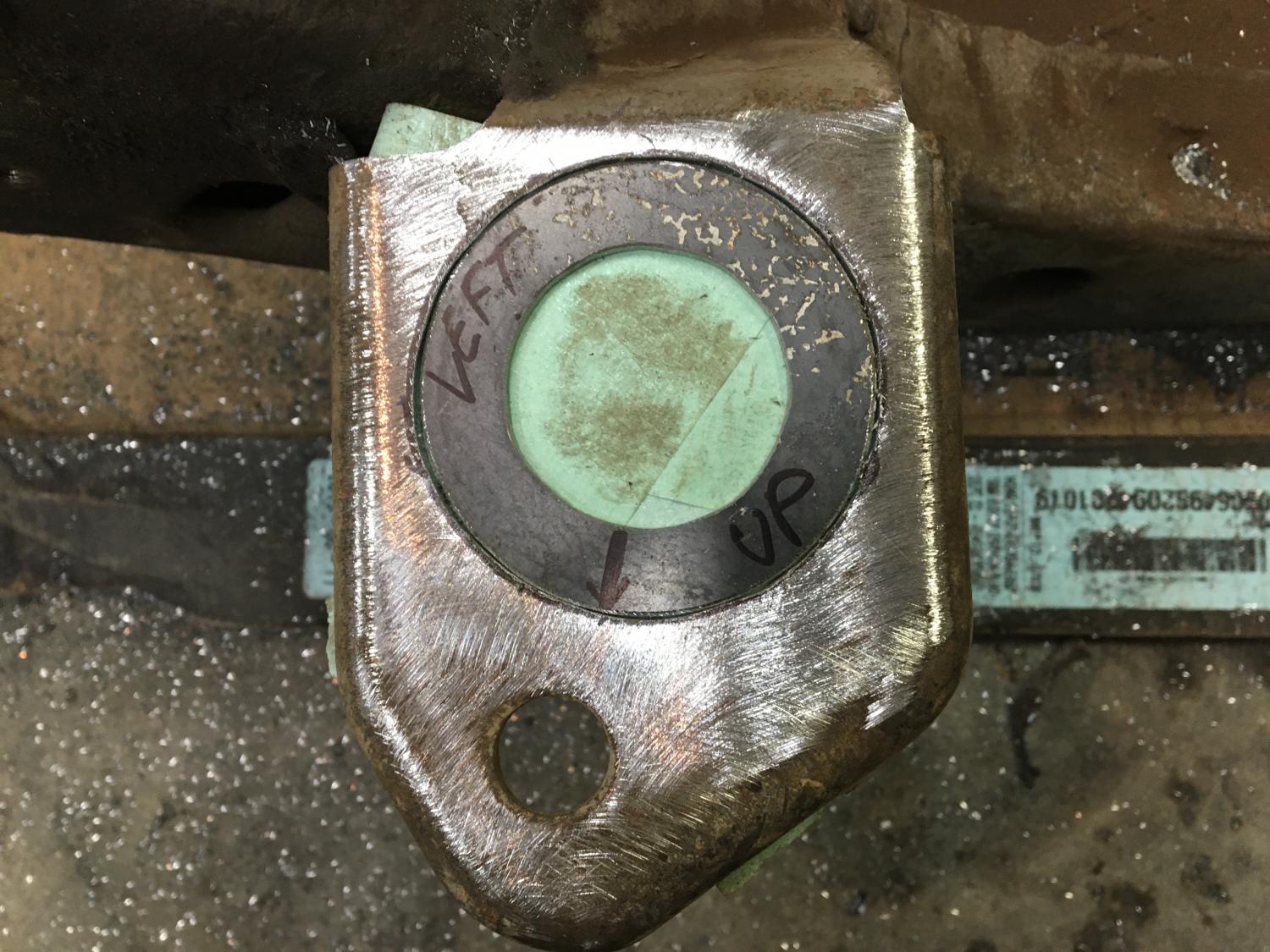

Patches were Tigged in, finished both sides.
RH
LH

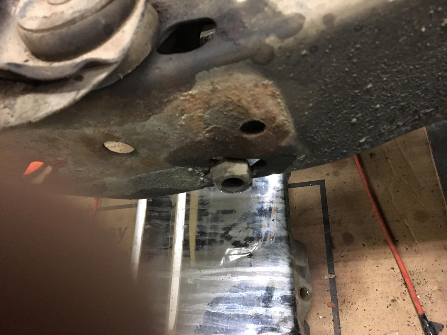

It would appear something was hacked into the bumper mounts (both sides) with a nut welded to the frame. Perhaps some sort of home built tow bar ?

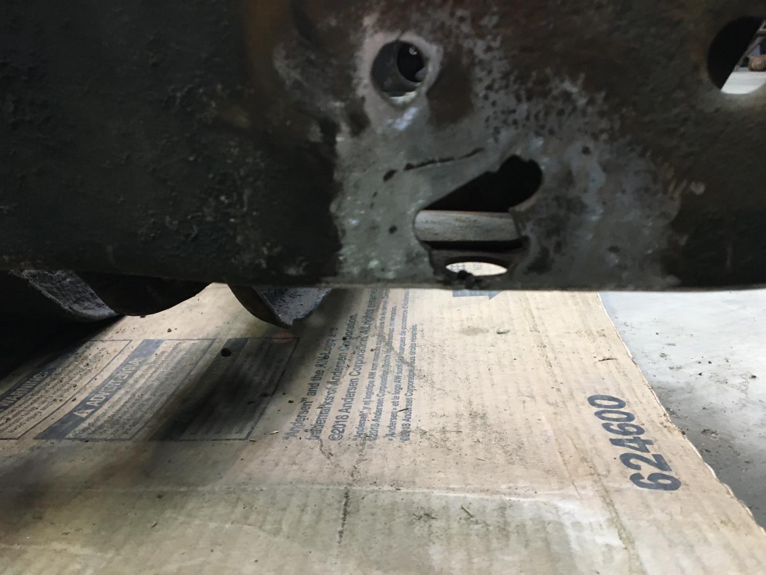

The lower slot was hacked open to clear behind the welded nut. Another Green Bastard repair issue.

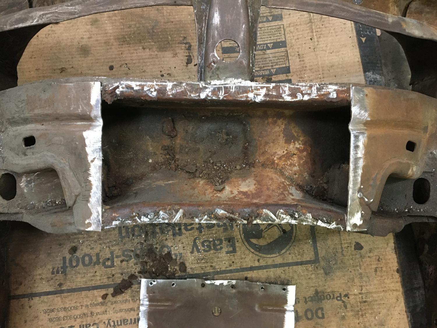

The underside of the crossmember has met the fate of the floor jack like so many before it.
No Easy fix except cutting it loose to hammer flat.

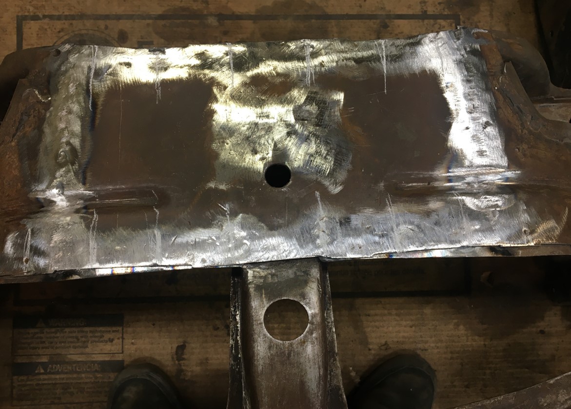

Ground and cleaned up. Chalk marks are for positioning the spot weld dimples. The dimples on this piece were a small diameter very defined shallow hole easily duplicated with a drill
