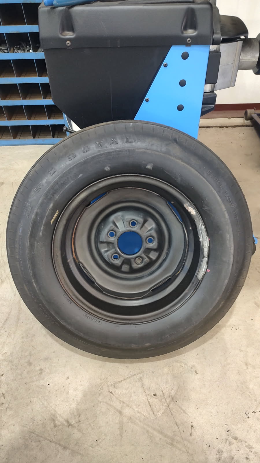

[QUOTE=olredalert;1671800]----Great! As usual on this great sight, this transaction between Tim and I went so smoothly. It was a pleasure finding a great home for this unbelievable spare. That's all I hoped for when I saw it at B. Gold. So hard to find any U.S.Royal 66 only whitewall in any condition. Can't wait to see the judges eyeballs when this spare tire is displayed!....Bill S
