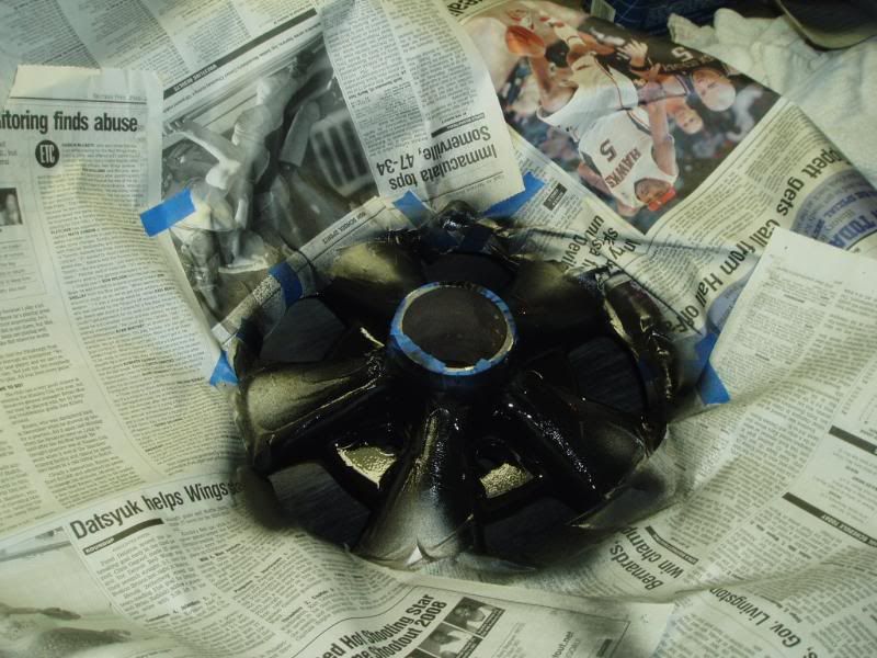

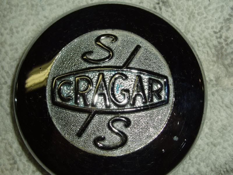

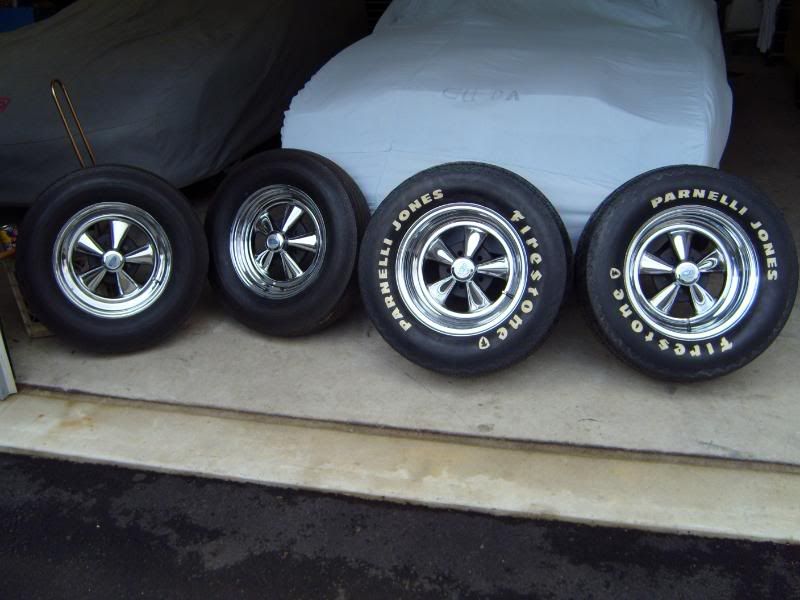

I spent the past few days cleaning the old rims. They are not in the best of shape, they are rather "patina-fied" as most Cragars are. Since I can't seem to find anyone that will rechrome them, I figured I'll just run them as is. I used a lot of Simichrome and cleaned up the chrome (where I could find it) as much as possible and then masked off the center lug nut areas and sprayed them flat black. Works for me. So I guess I am returning her to her "Rat Rod" beginnings.
Here's the extent of the masking and spraying. Not too high-tech:

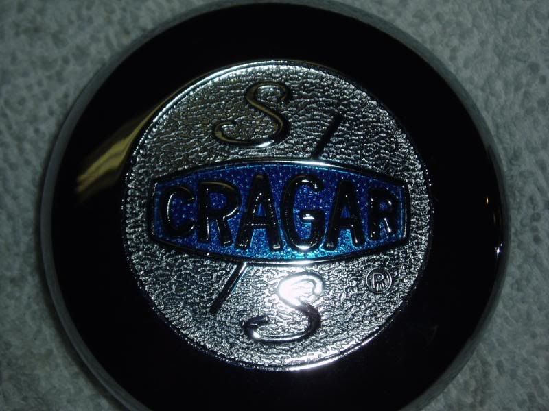

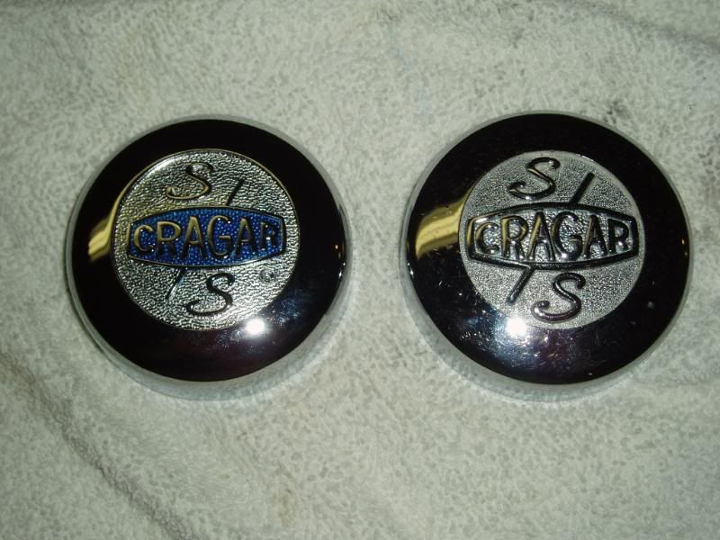

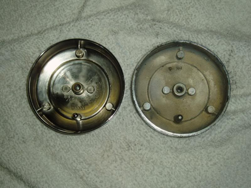

Oh, in case anyone is wondering: The original 1970 vintage center cap is on the right. Note the heavier design and thicker walls. The cap on the left is the later 1970/80s cap (made in Taiwan -it figures)...
The other way to tell the old style from the new is that the old style has a slightly thicker font to the letters and no circled "R" trademark under the name. THere is also a noticeable difference to the background "wrinkled" area.
The finished set:
  #96

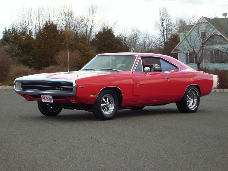

Here's the finished product. While the 38 year old rear tires are not safe to drive on, they look good enough for show. For the fronts, I ended up using those NOS F78x15s that came with that wrongly described set of front skinny cragars I bought last month. So they ended up being useful afterall.

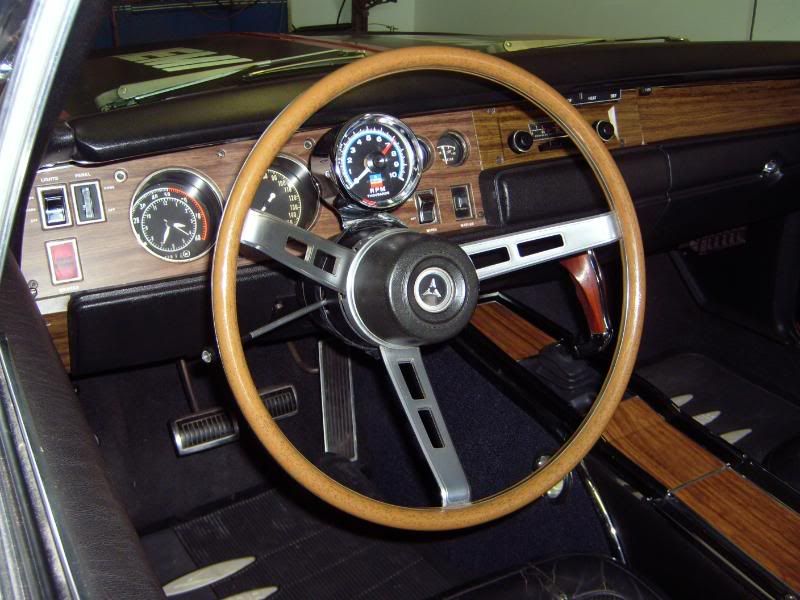

I also gave the car a present: I installed the old, NOS 1972 Mopar tach I had laying around for the past 25 years or so. Since the factory tach is a little on the wild (and inaccurate) side whne you hit the gas, this tach provides a little better estimation of what the engine is actually doing.
