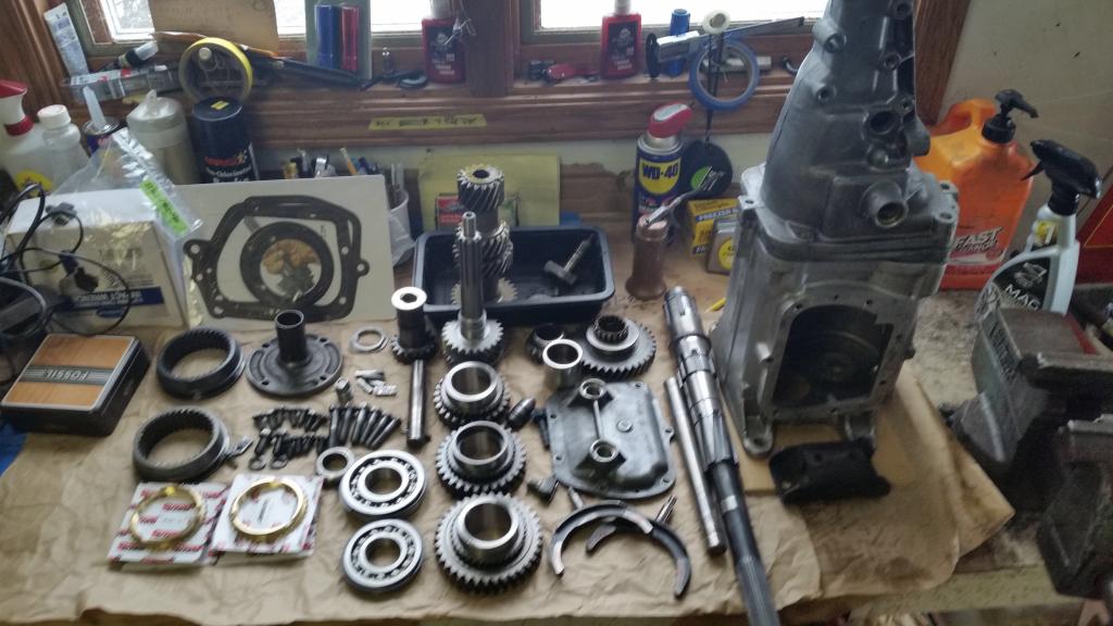

I finished cleaning everything, measured all components that will be reused and laid out everything for assembly. I am just waiting for a couple of items that, as luck would have it, goes on the main-shaft first. That would be the replacement “wide” hub that I found and ordered on e-bay. Attached is a picture of the components that I have ready to go.

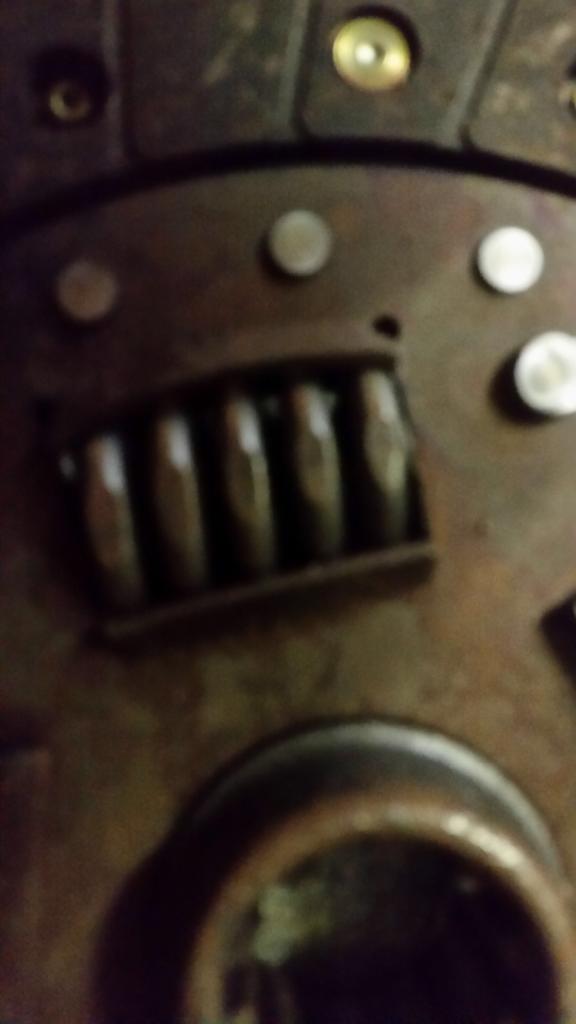

The second picture is what I was telling you about the clutch disc and the “depth” of the flywheel mating surface. I found the disc I mentioned to you that came in contact with the flywheel bolts. You can see the flat spot on the spring where it made contact with the flywheel bolts. The clutch never fully disengaged and took out the gear drive teeth eventually. It never ground, but was very hard to get into reverse.

You're missing a pile of roller bearings ...

<div class="ubbcode-block"><div class="ubbcode-header">Originally Posted By: earntaz</div><div class="ubbcode-body">You're missing a pile of roller bearings ... </div></div>
Saving a few dollars:-)

Default Re: Ryan Weaver's 1969 Olds Cutlass S W31 Club Coupe
Their a pain in the south end to install anyway ... LOL [img]<<GRAEMLIN_URL>>/headbang.gif[/img]

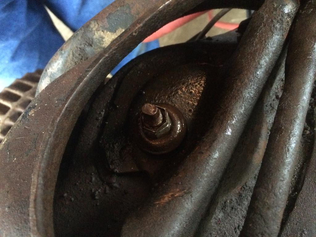

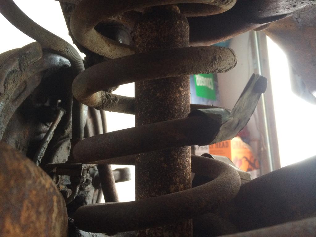

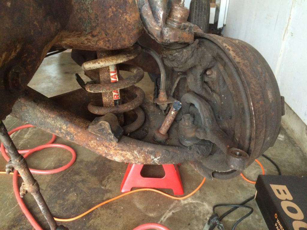

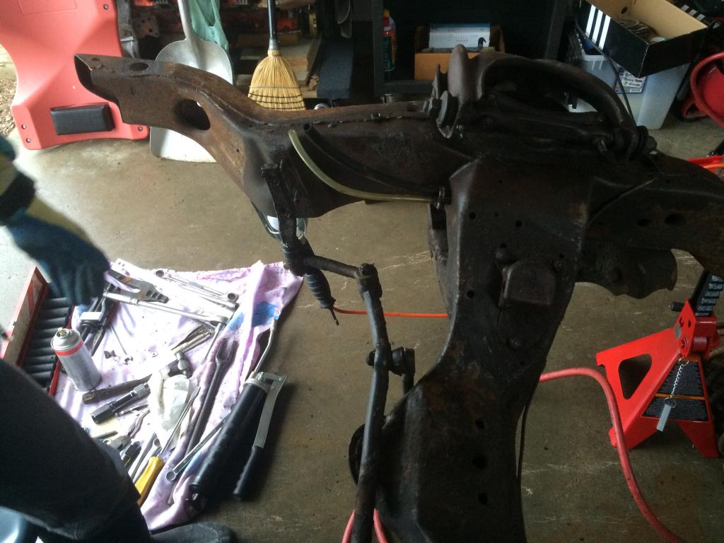

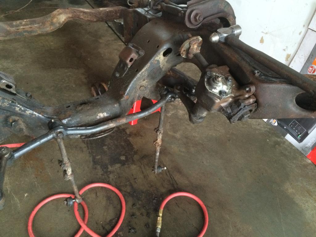

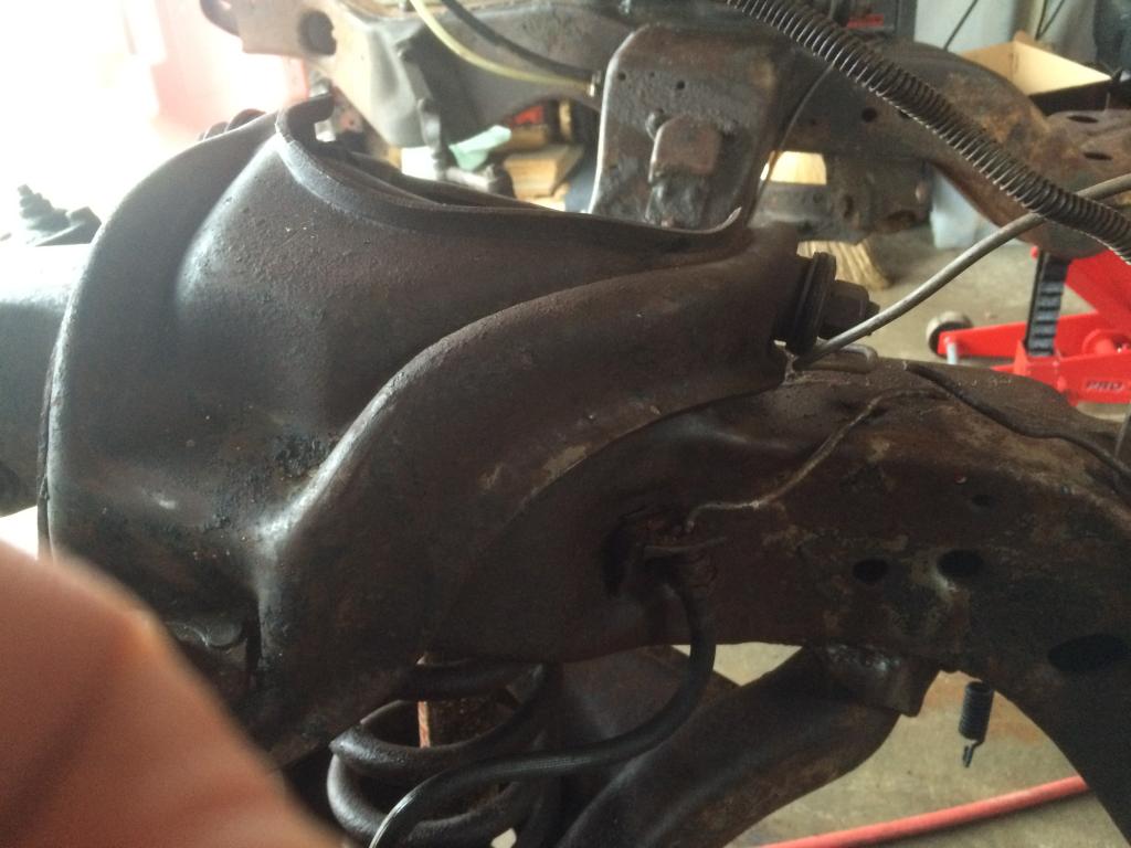

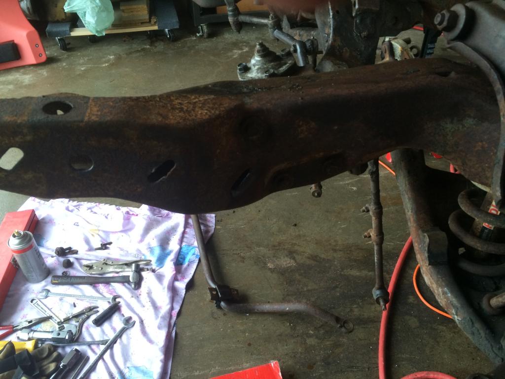

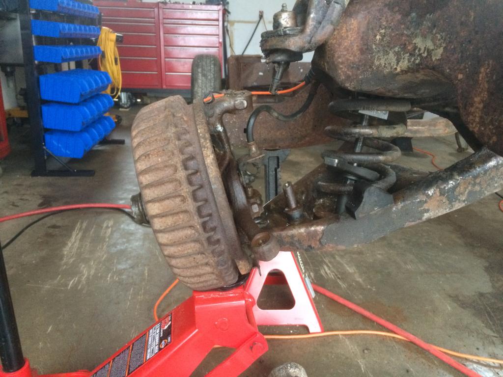

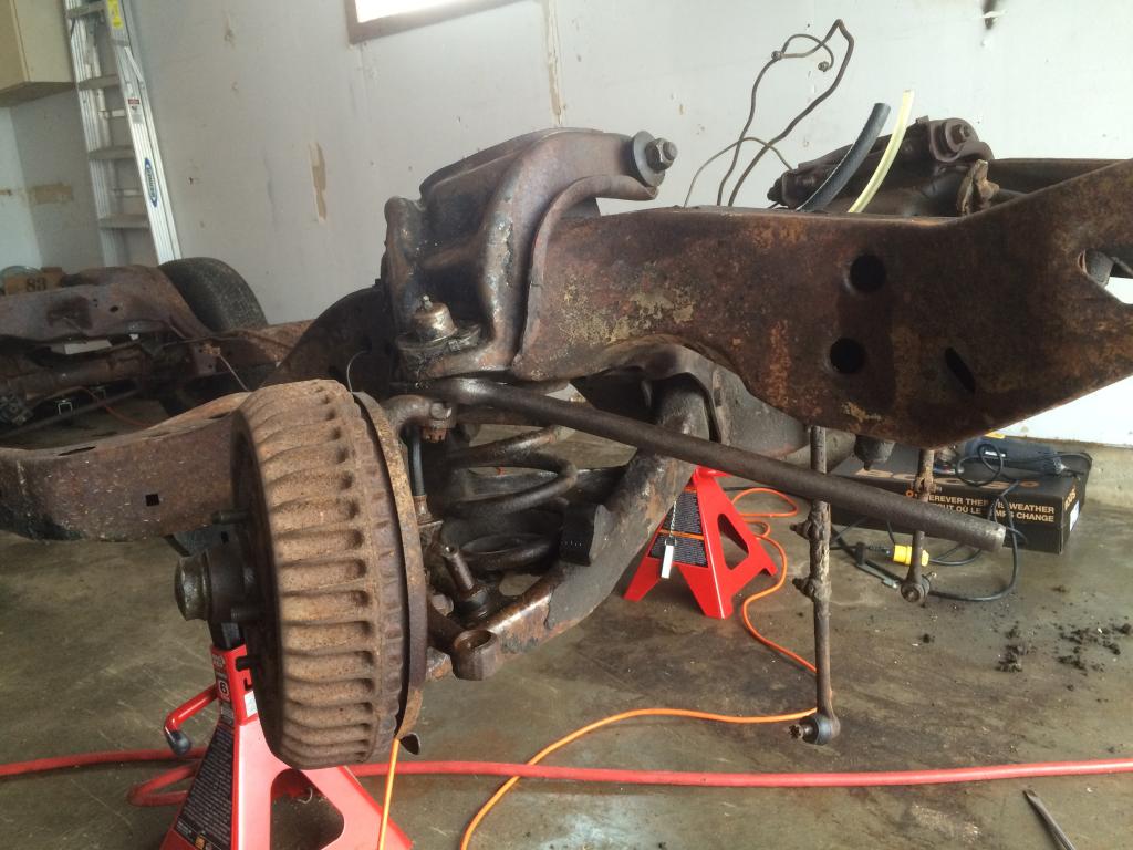

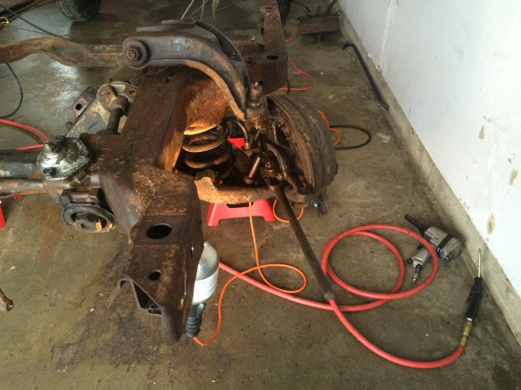

Progress update:-)
Got a good bit done today, Jamie and I removed the front suspension.
Dan Vasic coached me ahead of time offline how to go about coil spring removal, and we did a perfectly safe controlled removal (no fuss no muss)
Thanks Dan, I am leaning pretty hard on you;-)

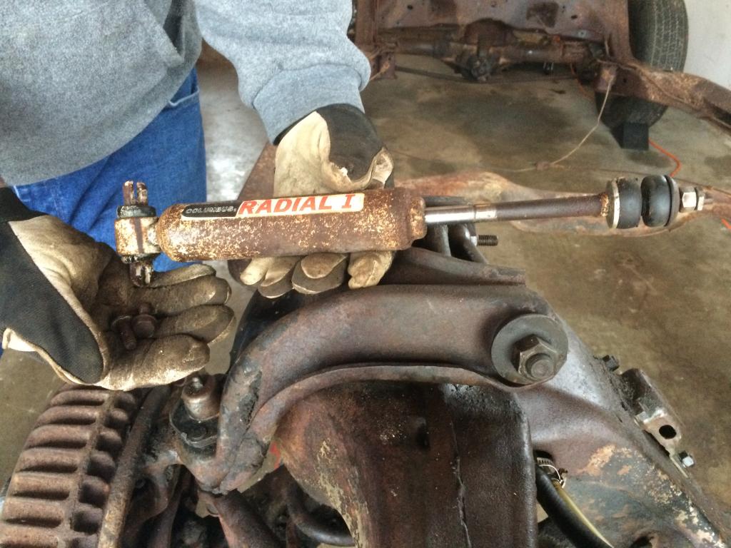

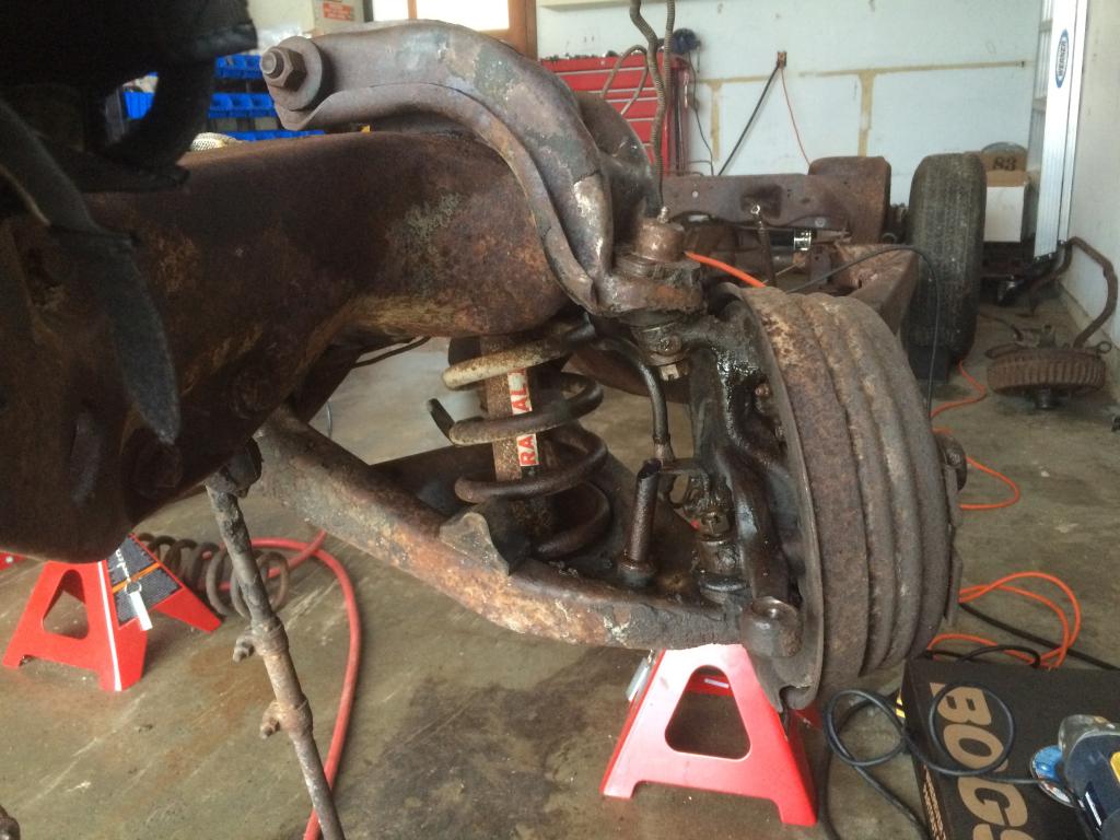

Some aftermarket shocks from back in the day.

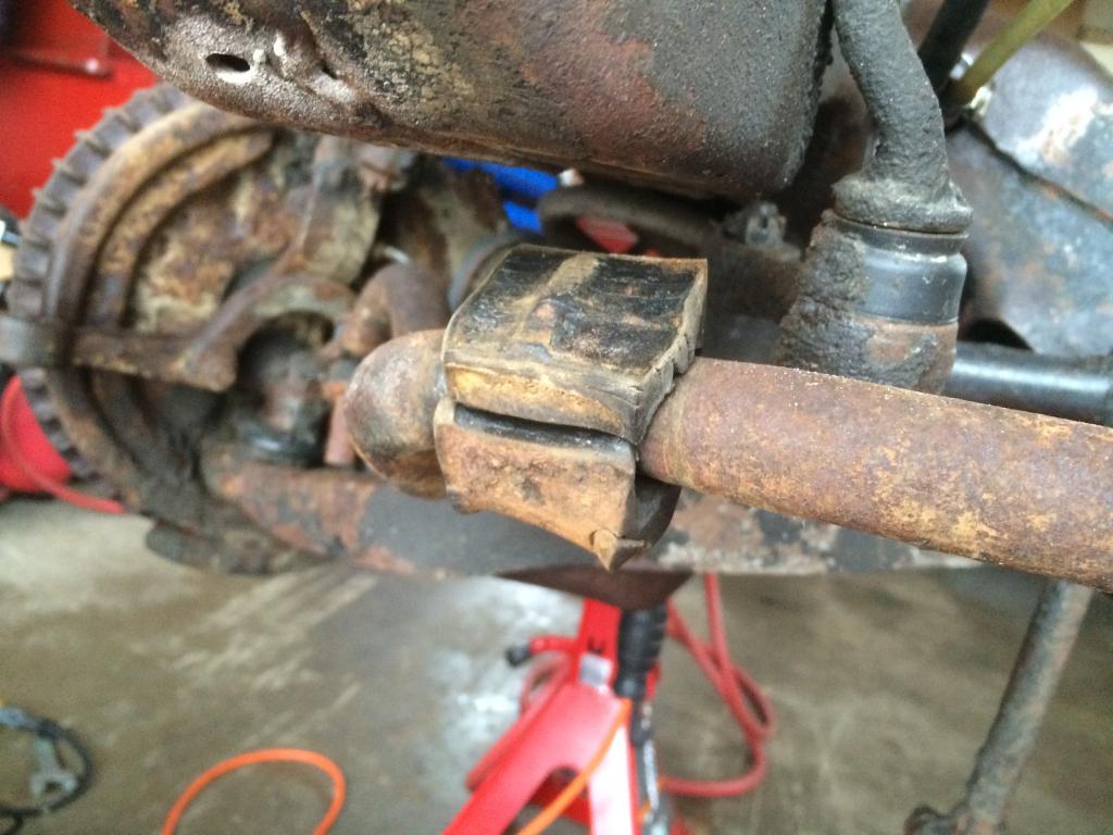

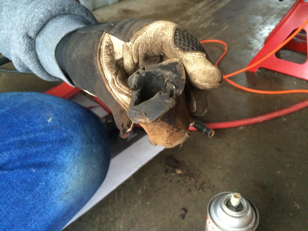

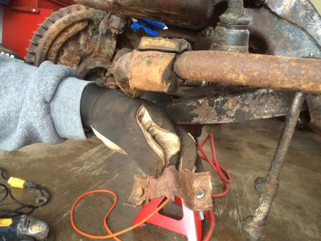

The sway bar bushings were riding where the sway bar has bend in it? They are kind of twisted up.
Ryan

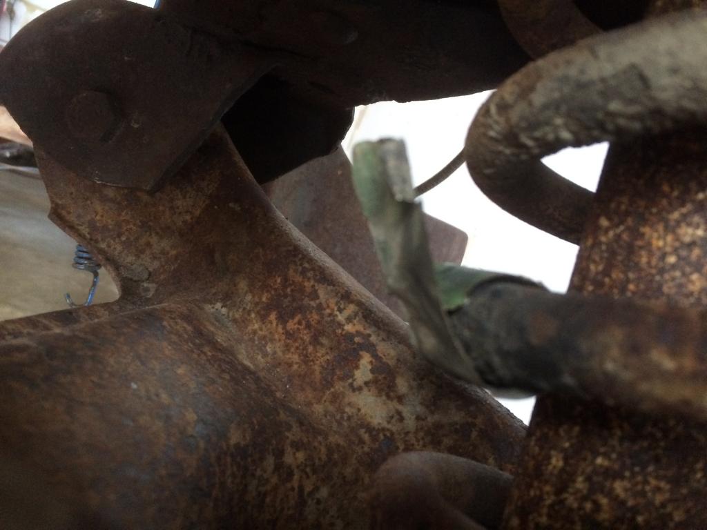

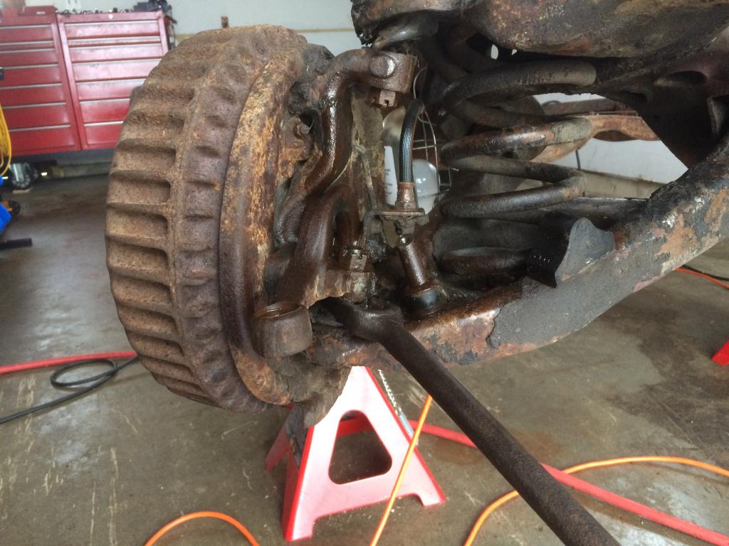

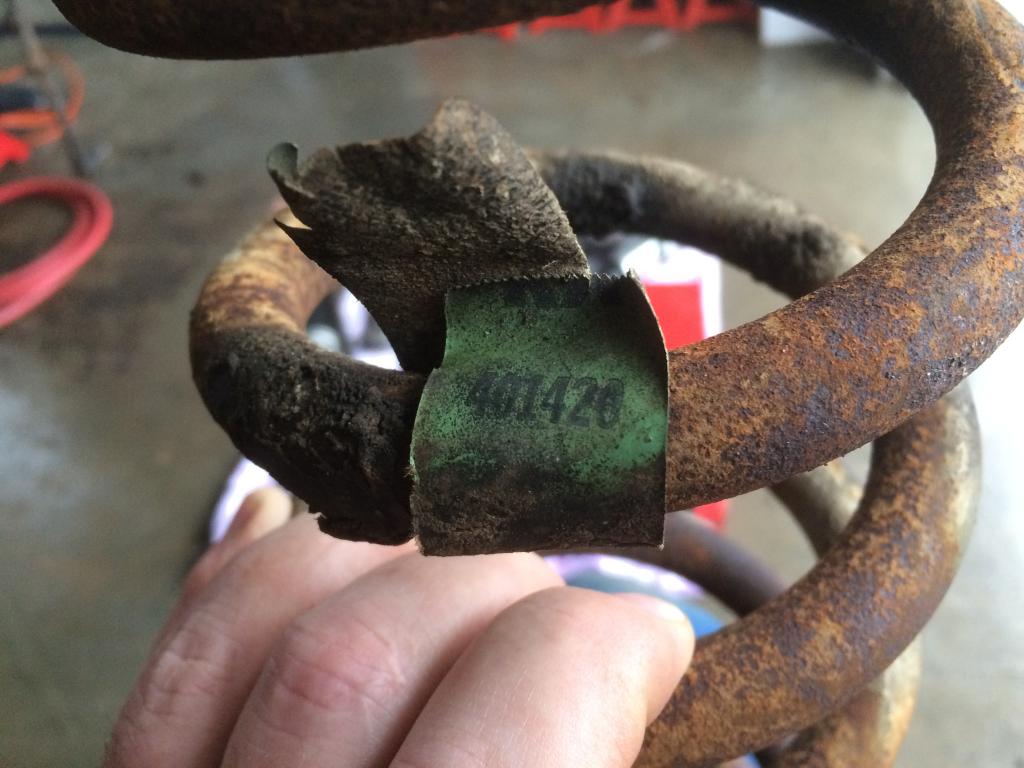

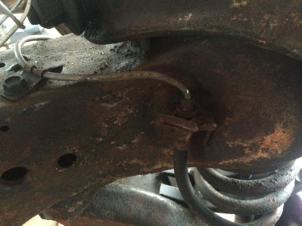

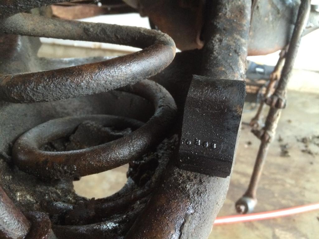

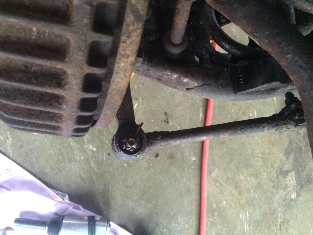

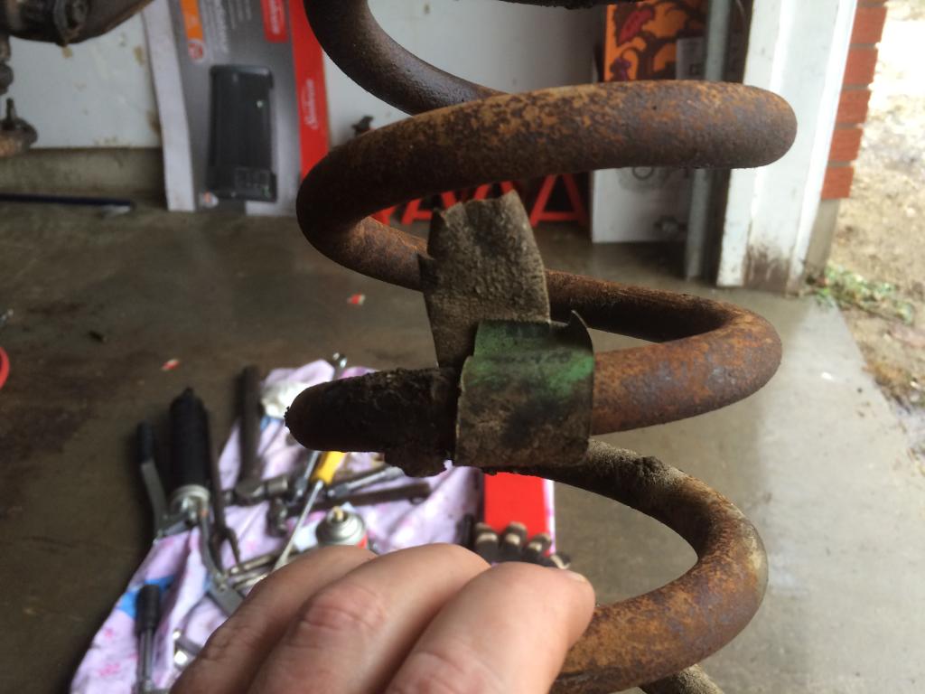

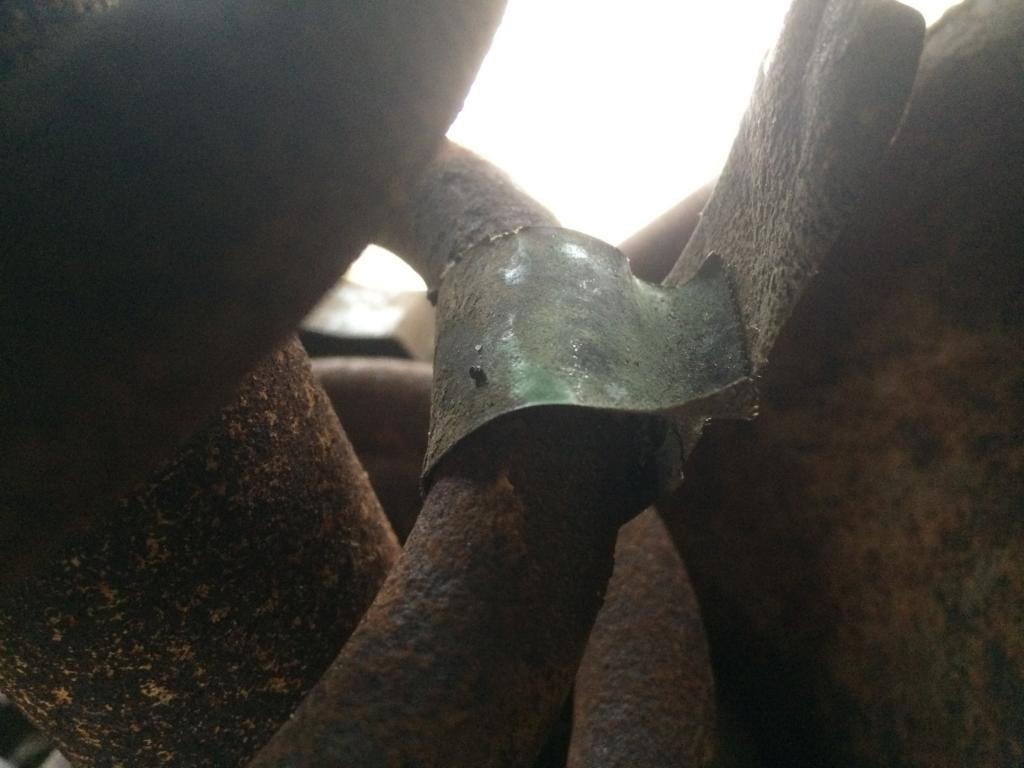

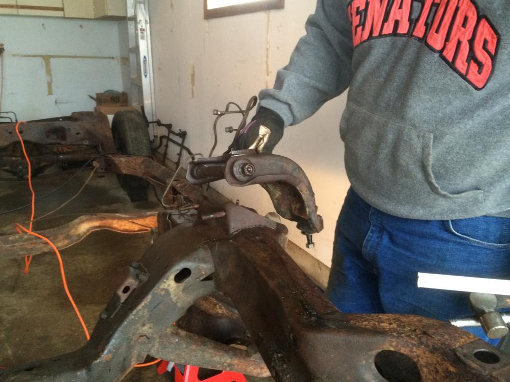

We got the tie rods disconnected, and found a cool spring tag.
I am absolutely overwhelmed by how original the car is:-)
Every single item I learn about as i study the assembly manual I find exactly as described on my car (plus or minus a few items here and there)
Ryan

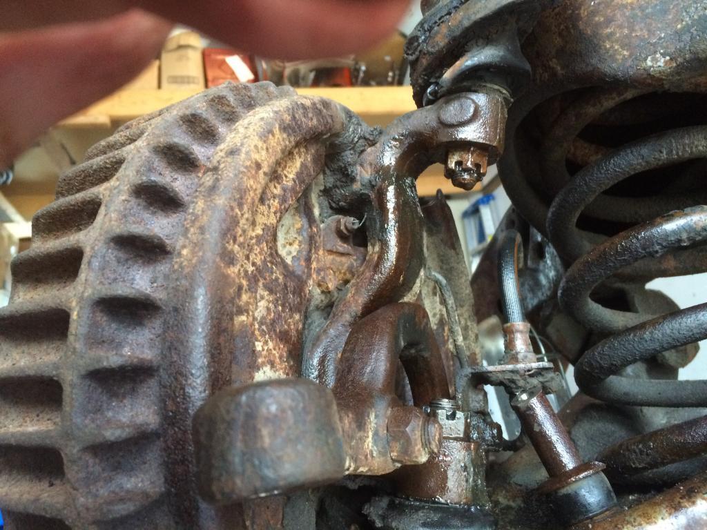

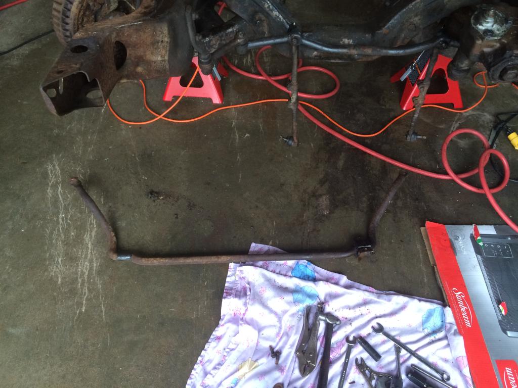

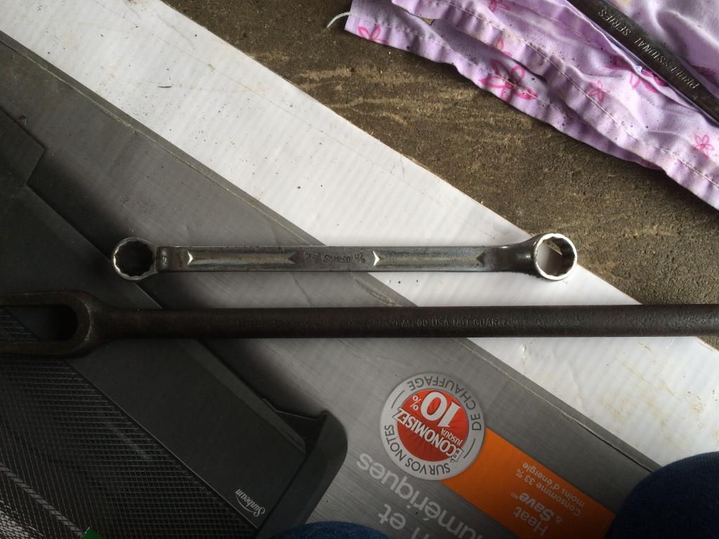

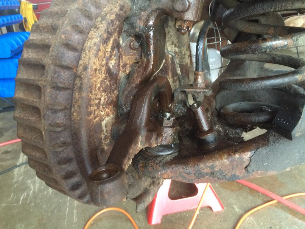

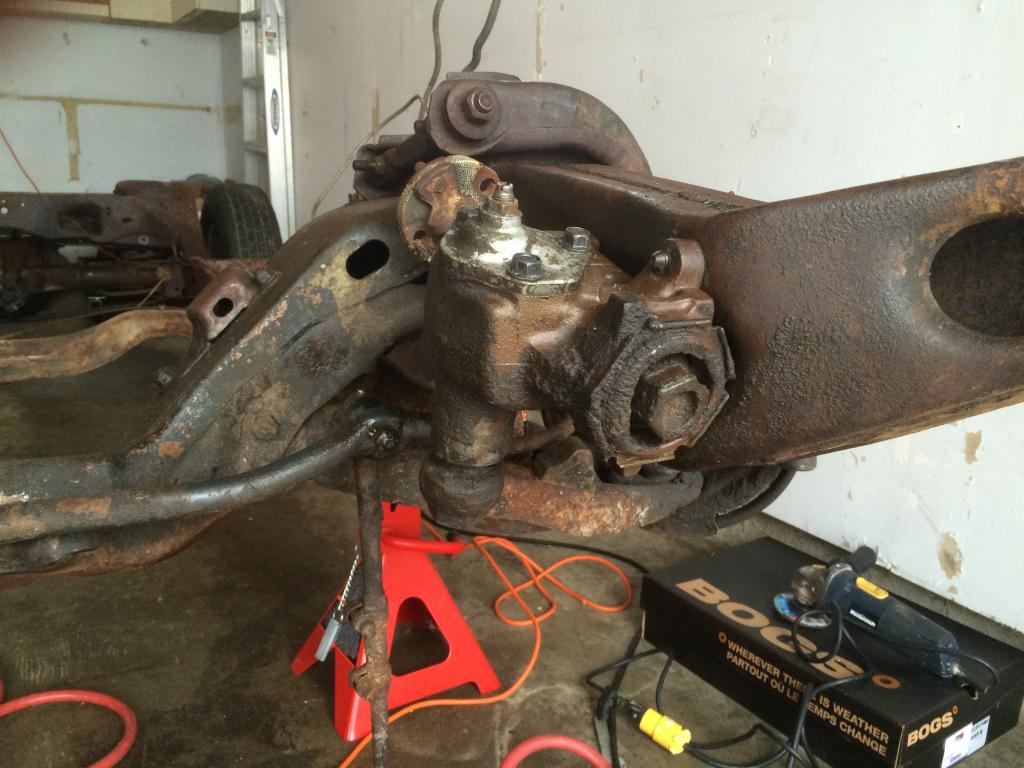

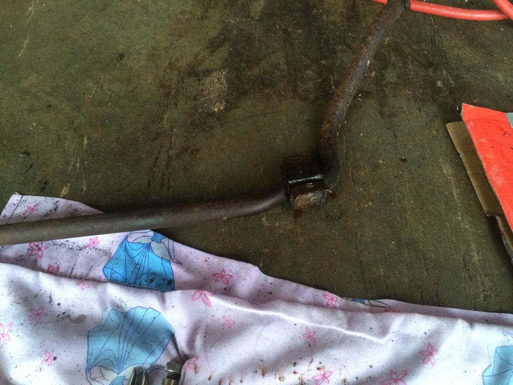

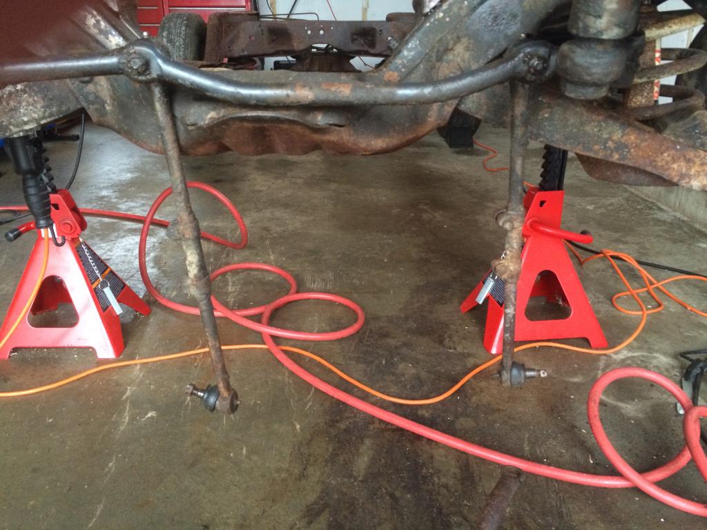

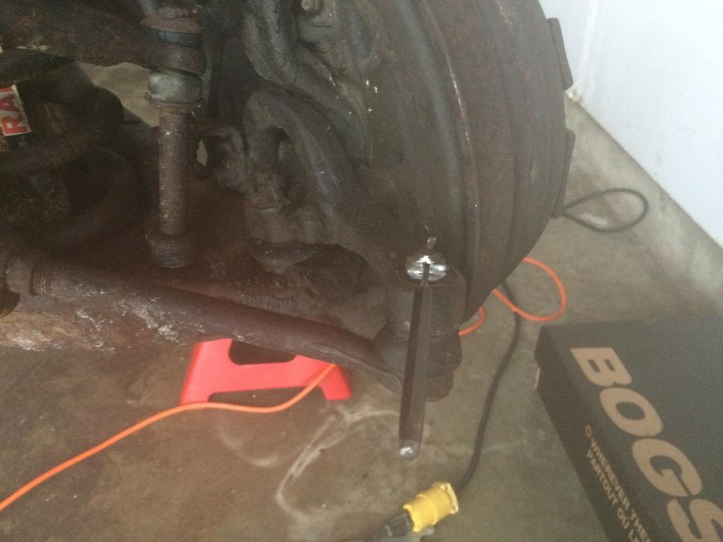

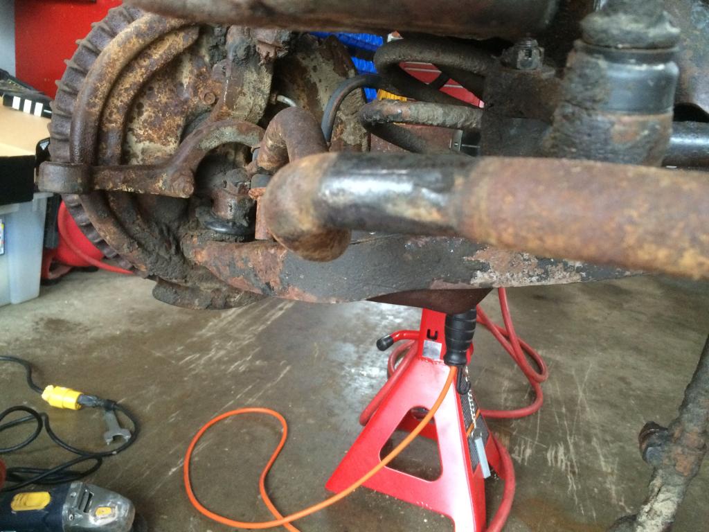

We dug out the old cotter springs and loosed the upper and lower ball joints.

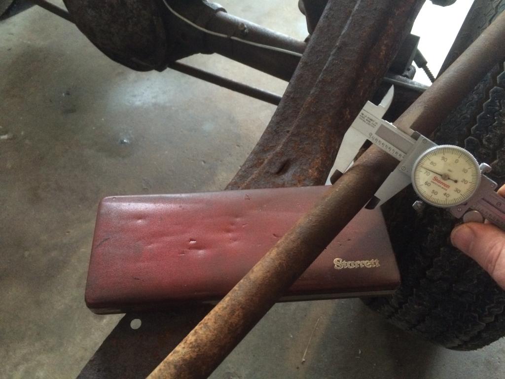

Check out the sway bar 0.973&quot;

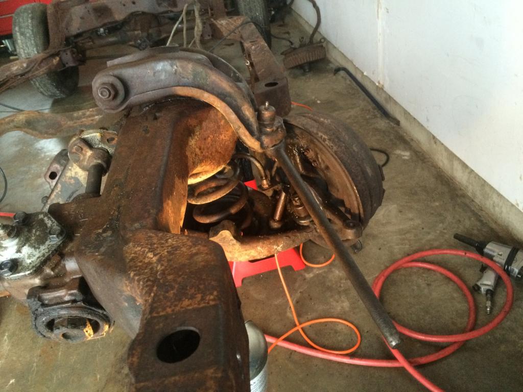

Then I used some hand me down Snap On tools Dad gave me (he was a Ford Mechanic.........oopsy shouldn't have shared that story here:-)
Check out the old pickle fork, worked like a charm, boom,boom,boom, pop!!
Ryan

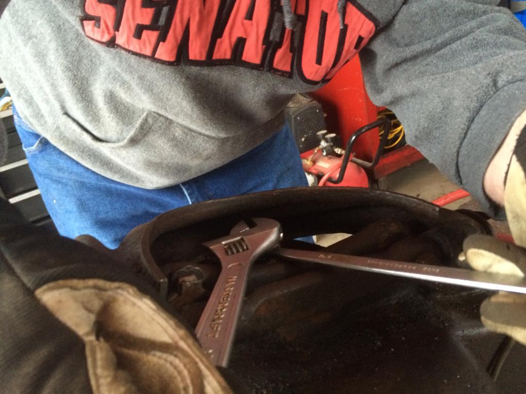

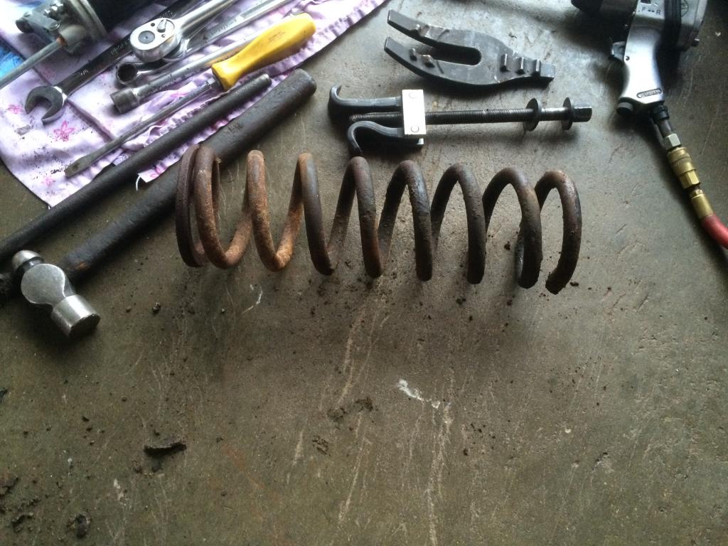

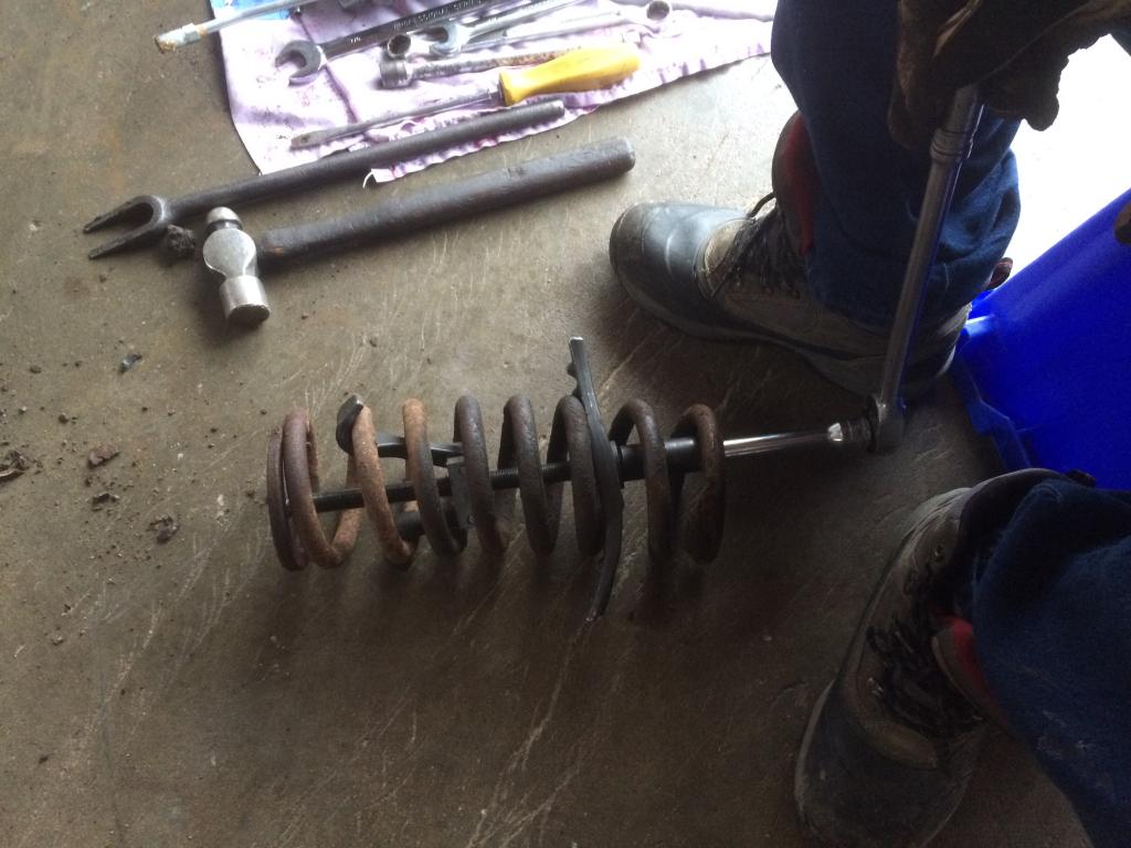

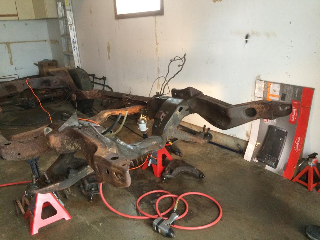

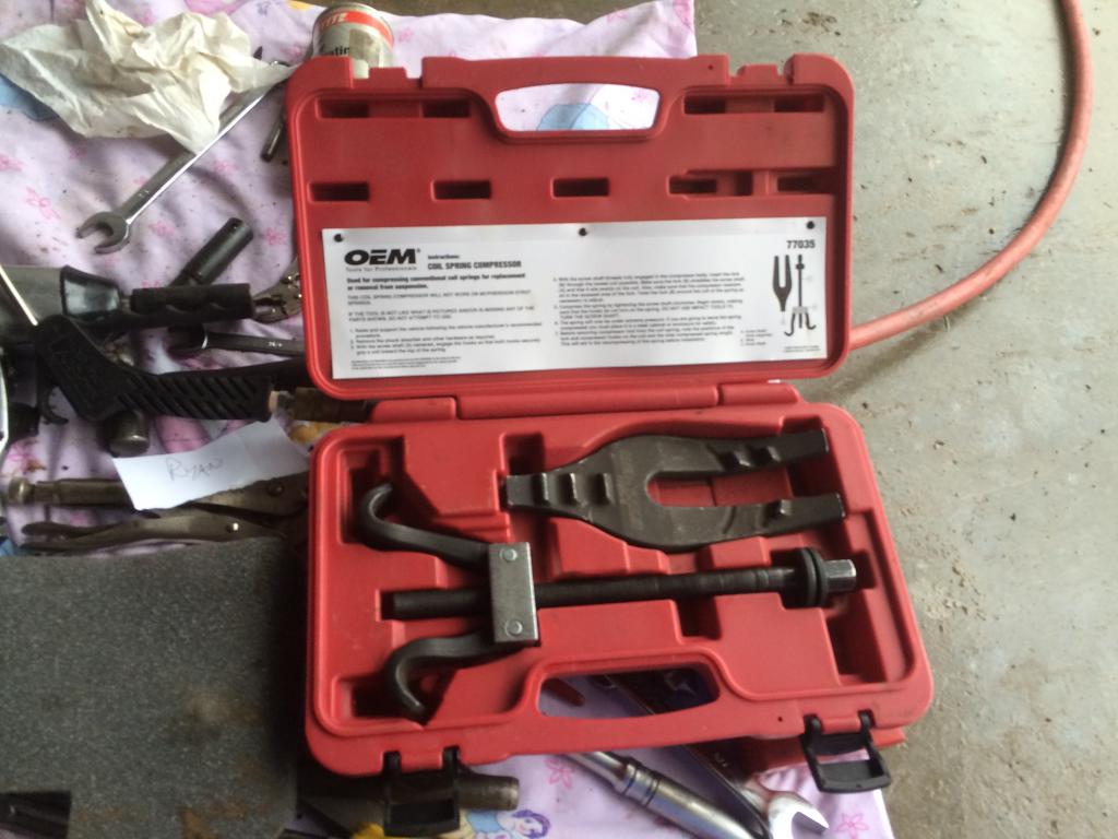

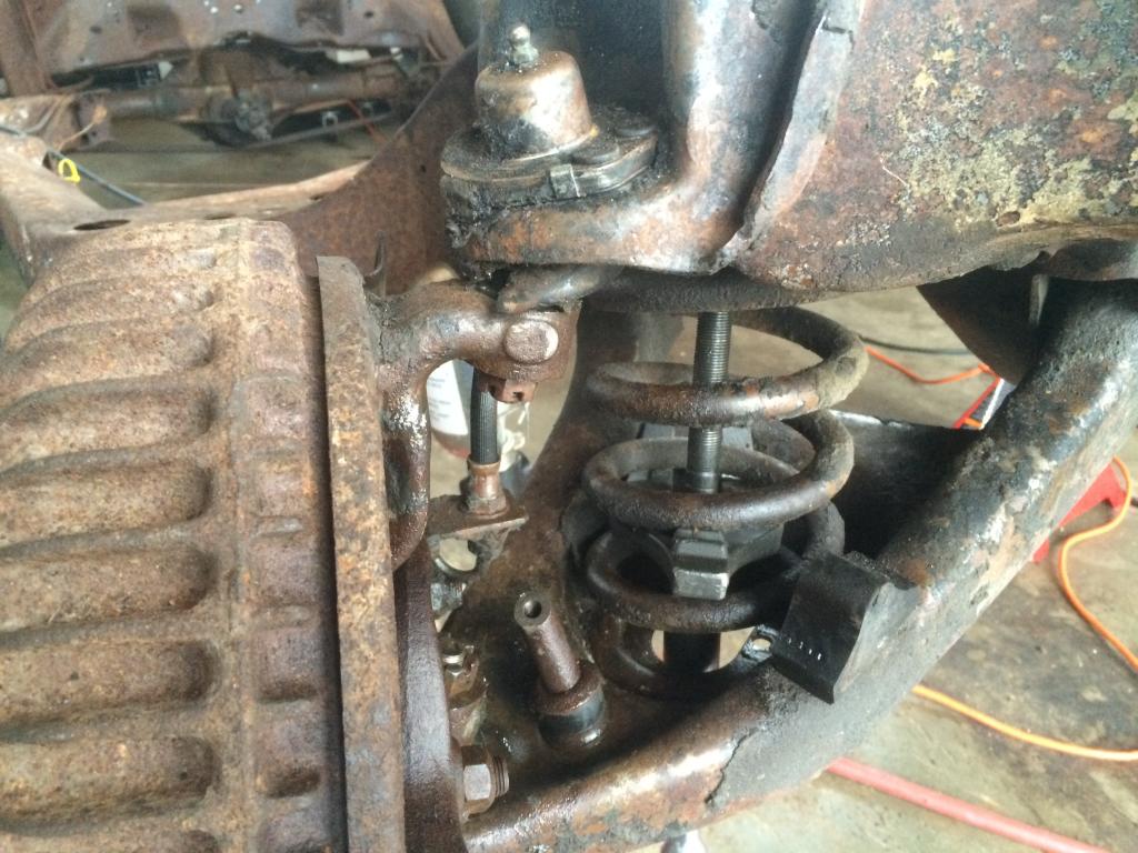

This spring compressor worked very well and very safely!!! (Thanks for teh tips Dan!!)
Ryan

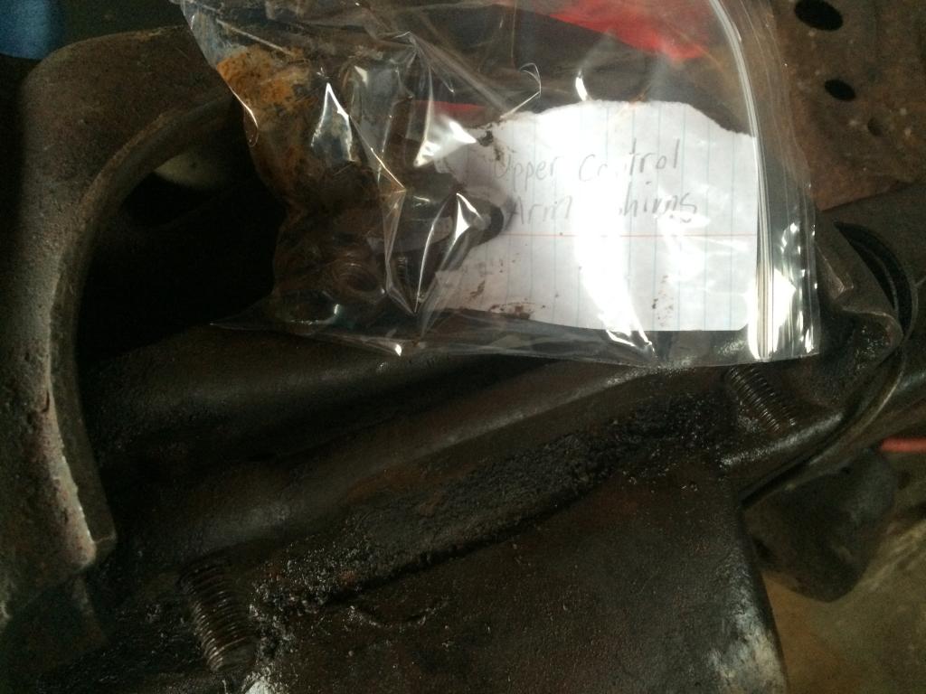

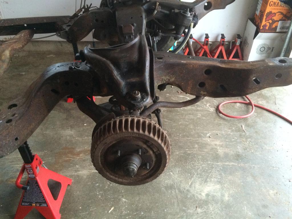

We bagged and tagged every bolt, clip, etc.
Ryan
