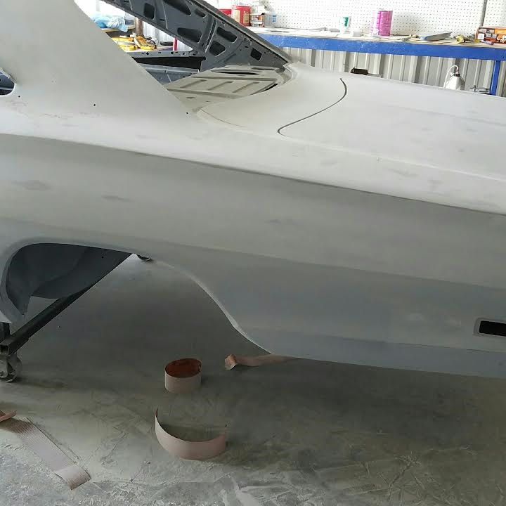

Yesterday I got the soft bodyline above the driver's rear wheel well nice and crisp and the rest of the car is alomst there. Better pics of that later today. I seam sealed all the areas that needed it: door/trunk skins, trunk drip rails, quarter panel/door jambs, etc. I'll shoot another primer round this morning, and then start with 320 and the guide coat (a second time) today. And I'll be back for more trunk work this afteroon too! I wasn't happy with the front wheel lips, so I spent yesterday redoing those as well. Did I already mention I'll never ever ever NEVER EVER EVER NEVER do another Coronet agian???[img]<<GRAEMLIN_URL>>/thumbsdown.gif[/img]

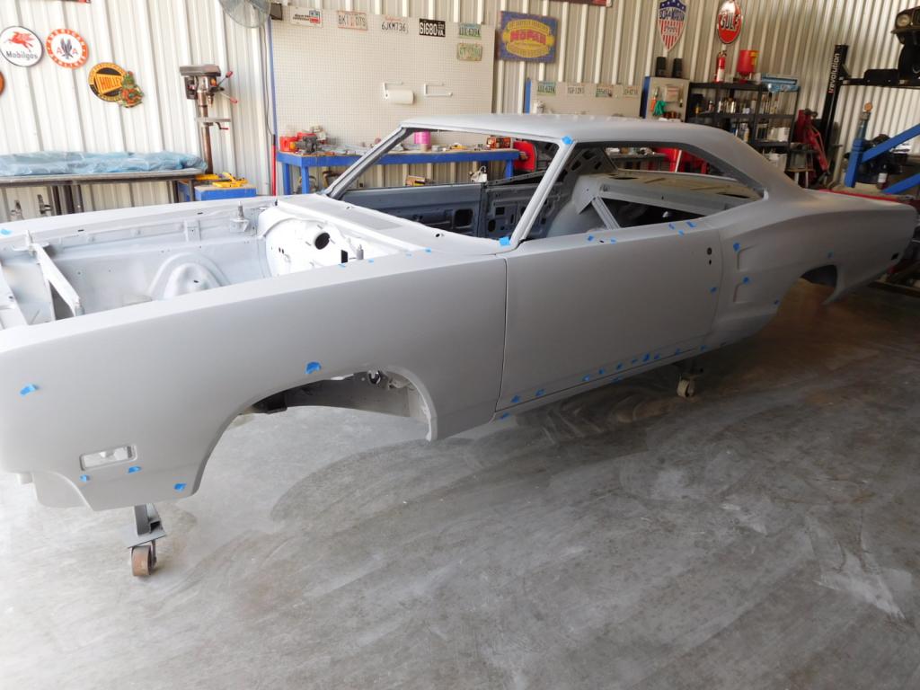

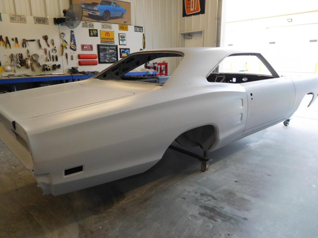

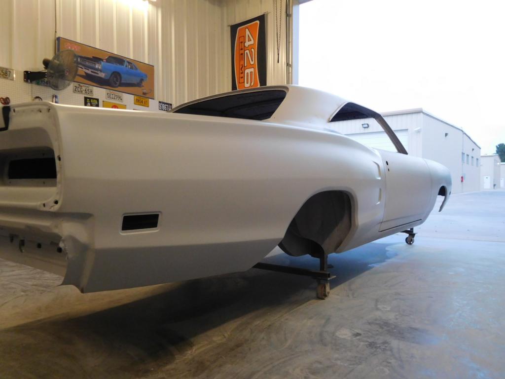

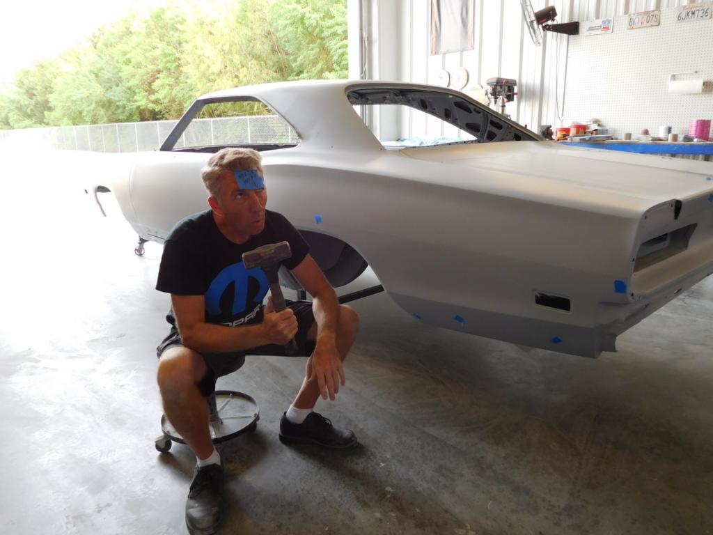

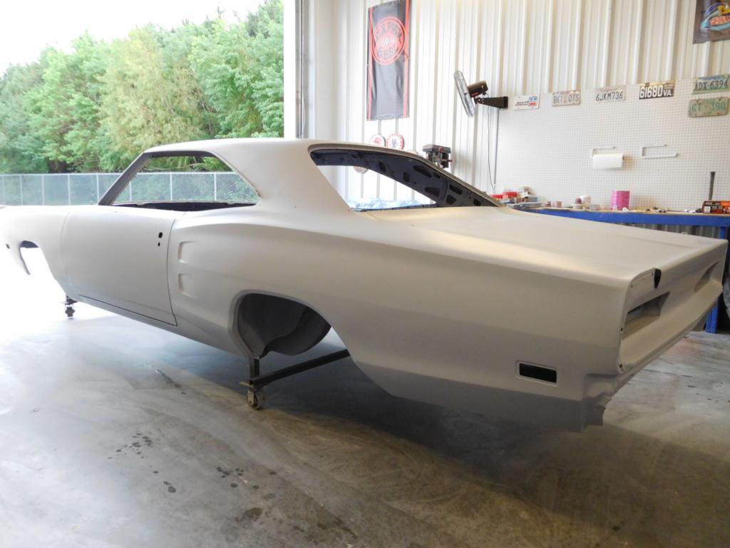

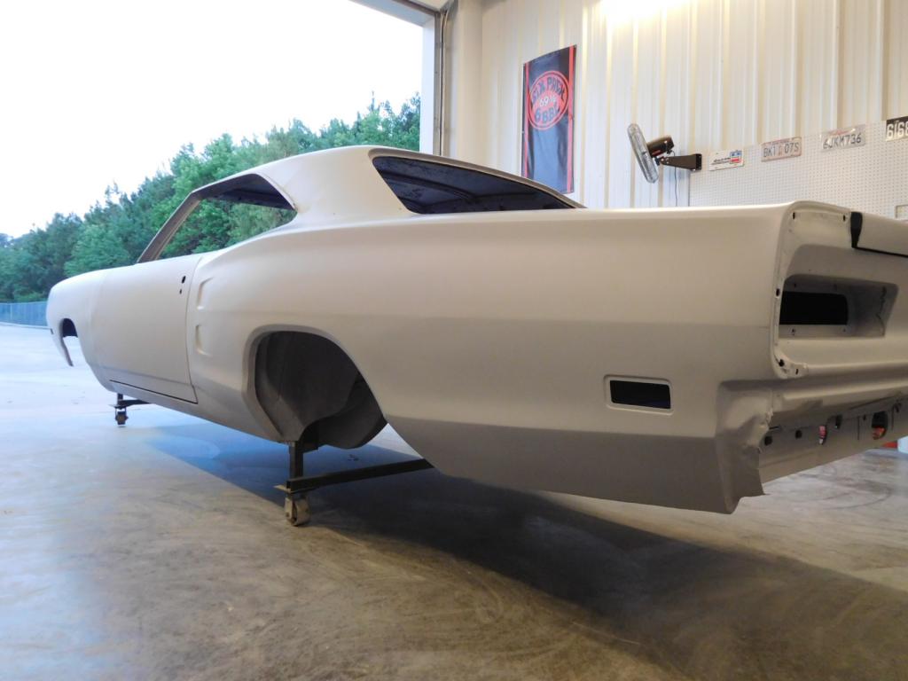

OK, so to wrap the week up, I sprayed out the car in another round of DPS3055 to check the lines.

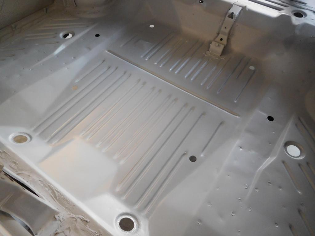

I'm about 95% done with the trunk. What looked like the surface of the moon now resembles more of the Desert SW with an occasional Meteor Crater. Almost done with this!

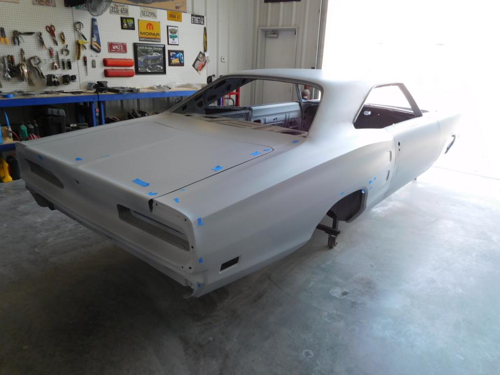

Also, after about 6hrs, I went back and used some blue painter's tape to mark any dimple, scratch, flaw I could find and as you can see. I found a lot!!! [img]<<GRAEMLIN_URL>>/thumbsdown.gif[/img] [img]<<GRAEMLIN_URL>>/thumbsdown.gif[/img] Someone at the shop complex asked me what all the tape marks are for and I said, &quot;Flaws that I need to fix.&quot; His comment was, &quot;Where? I see the tape, but what's it marking?&quot; I had to show him what I was seeing with my flaw eyes and he laughed. He said I was nuts then put a &quot;Needs Help&quot; sticker on my forehead. And, I agree, I do need help. But I still need to fix the flaws!!! [img]<<GRAEMLIN_URL>>/biggthumpup.gif[/img] [img]<<GRAEMLIN_URL>>/grin.gif[/img] [img]<<GRAEMLIN_URL>>/laugh.gif[/img]
I did figure a way to minimize this problem. Put a nice 5lb sledge hammer blow into the side of the quarter panel. People will be so shocked at that, they'll look past all the other things!!!!! Hmmm [img]<<GRAEMLIN_URL>>/hmmm.gif[/img] Maybe I better not do that....
More next week!
Cheers [img]<<GRAEMLIN_URL>>/beers.gif[/img]
Dave
