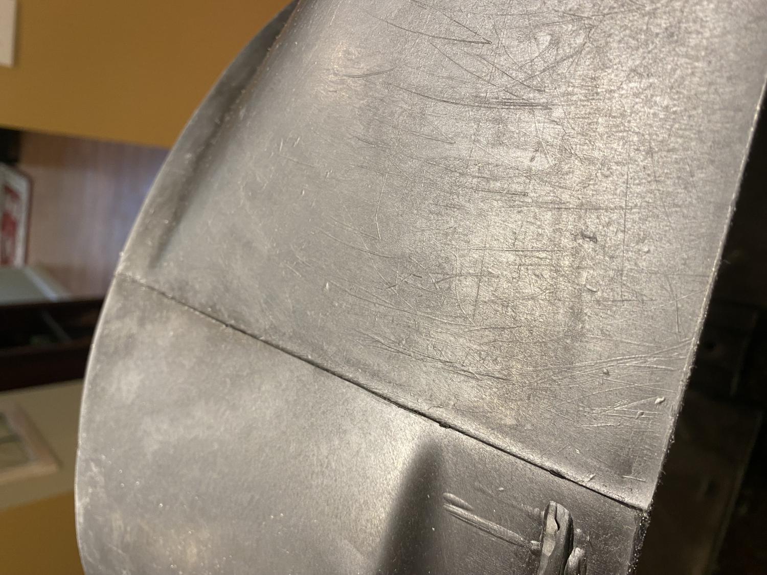

Looking for some ideas on my fan shroud. No damage other than scratches. Has anyone had any luck with reconditioning these?

I would try successive fine grades of wet dry sand paper on a block to attempt to smooth the gouges however I think you can not remove enough material to eliminate them.

I'd try that on an old part first. I don't think you'll be able to duplicate that molded finish.
Thinking the same thing. I've tried to "clean up" plastic parts in the past and it never turns out well. The gouges are part of it's history and should just be left to live on with the car. If it needs to be concourse for show, find a mint used, or NOS shroud.

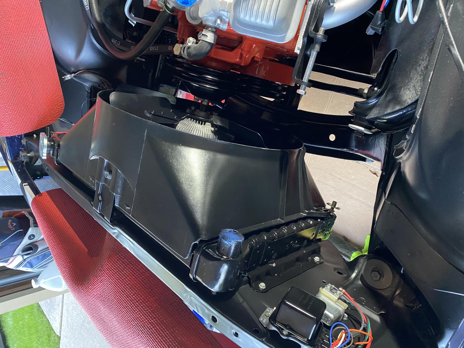

Okay, sanded many of the scratches out of the fan shroud, experimented buffing with various compounds and was not fully pleased with the results. I then thought about the black trim restore stuff for exterior trim. Tried a spot on the inside of the shroud….not bad. Here’s the results (sorry for the dust/schmutz from installing).
