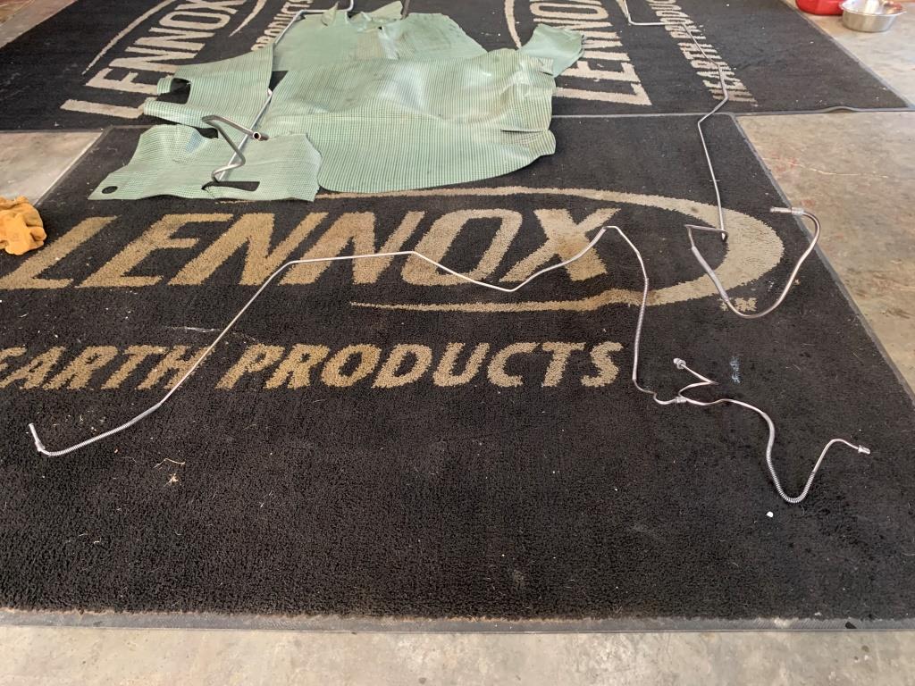

Same process of wire wheel grinder & Wenol blue & red compounds.
Photo 341 - 343 - Main brake line before cleaning
Photo 344 - 346 - After cleaning and polishing using Wenol
Photo 347 - 348 - All hard lines are now preserved.
