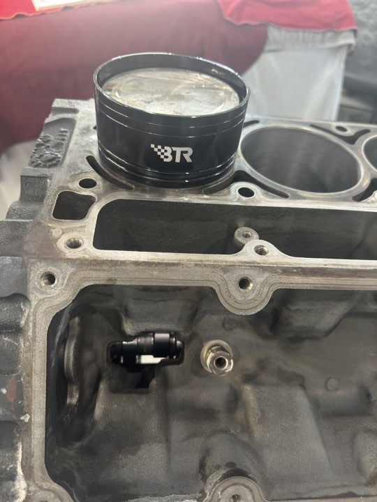

Next up rods and pistons ............
Along with checking Rod side clearance.

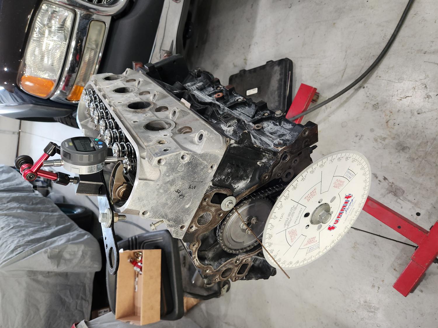

Cam installed and being degreed in to verify cam timing is correct .
Also time to check PTV( actually did this after the 1st piston was installed although I've done enough camshafts now to know this cam would fit beforehand)

Time to add some heads . We used a Cometic .045 thick MLS gasket on this build. A OEM head gasket would have been cheaper, as these are overkill, but I wanted to set the quench at .040" since the pistons sit out of the hole .005", and there are no GM gaskets that thin.

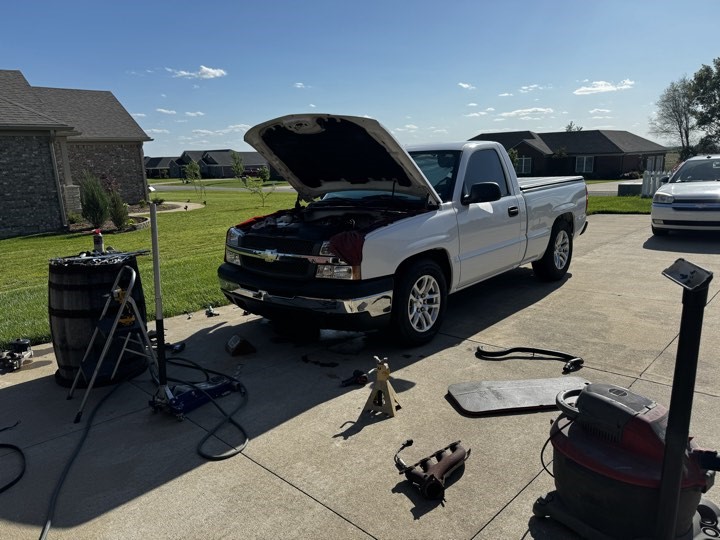

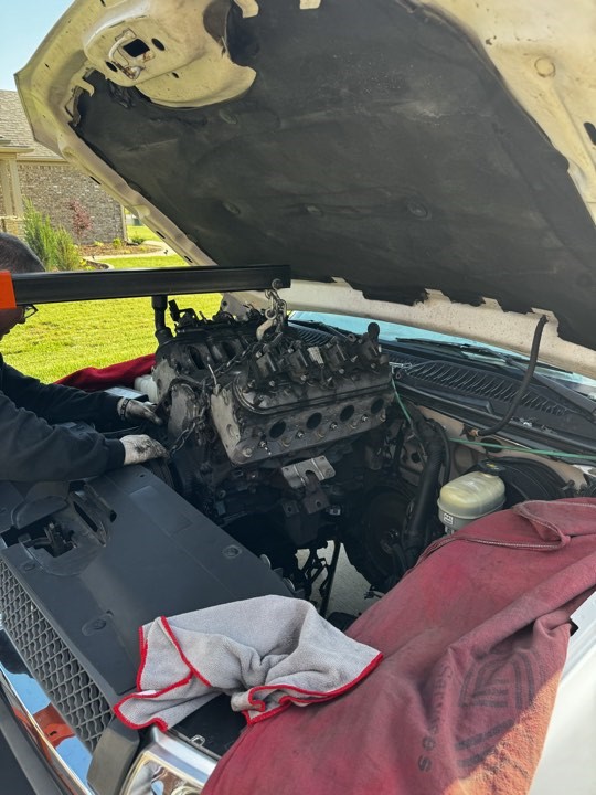

Didn't get pictures of the oil pan and timing cover installation , but we just used the old stuff after some clean up of course. Time for the removal of the original 5.3 and the addition of around an extra 150 rwhp !!!

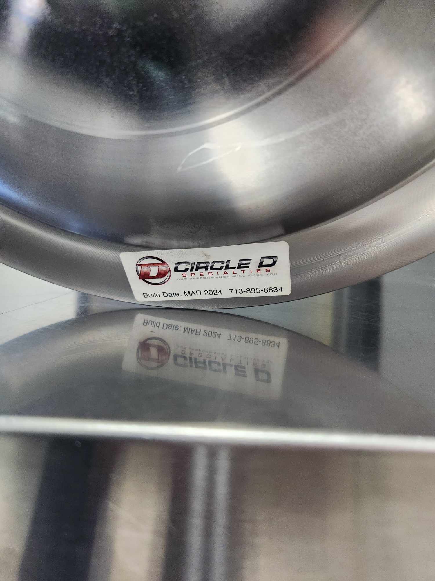

We also ended up adding a Circle D 3200 stall speed and some 1-3/4 ; headers, Y pipe w catalytic converter delete pipe . We also used on of my Borla mufflers for some added airflow and louder HOT ROD sound of course .

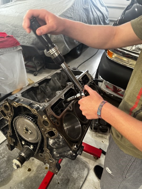

  #120
