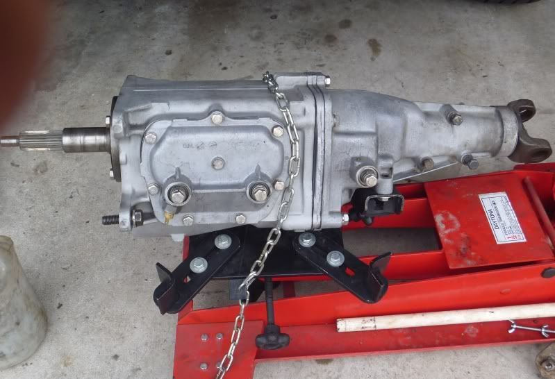

I scrubbed the M22 to get the all the engine oil off from the leaky rear main seal. The bellhousing got a scrubbing, too. That took a a day of soaking since the clutch dust combined with the leaking engine oil really soaked into the pores of the aluminum housing.
I had to order a new clutch fork since I noticed that one of the clips clips that retains the throw out bearing was broken off.
