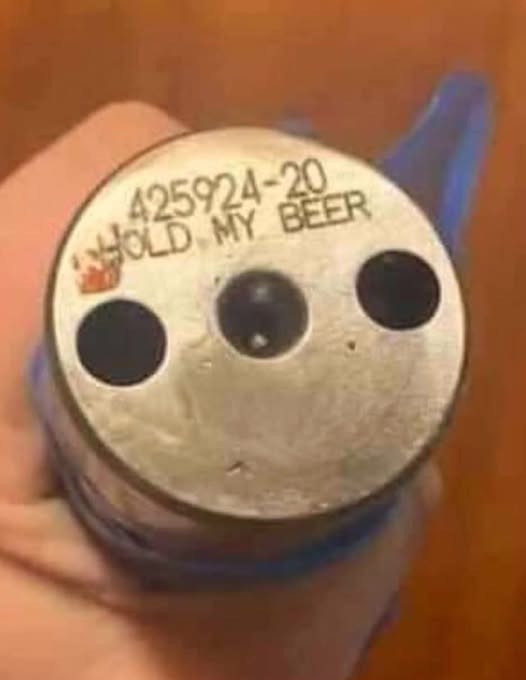

As my last side note in this post....I think Dave Dykstra found the secret cam grind that's in the 565
