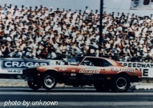

I have made several posts concerning this car and mentioning the different paint configurations and failed to post pics to document them I am goint to attach them to this message. one the red/black,all red and the tri color
last config.
Again best to you
Dave

second pic is all red against Limefire (Clare Sanders)

Last is the tri color it that is my personal fav
This was taken at NY National I dont know by who.
BTW if anyone wishes to claim credit for any pic I might post I will be glad to aknowledge that. credit where it is due. This not a really good pic sorry
