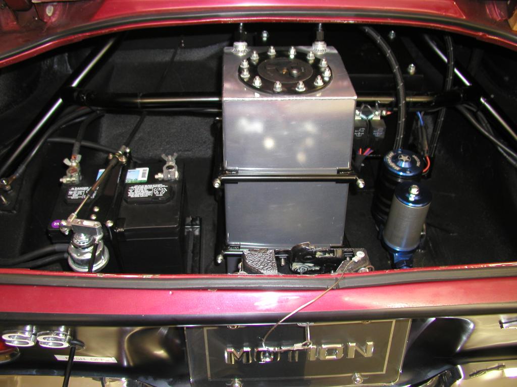

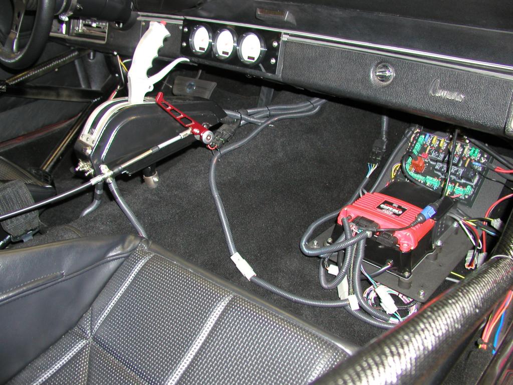

<div class="ubbcode-block"><div class="ubbcode-header">Originally Posted By: bigsixman</div><div class="ubbcode-body">Gary, what length cables do you use for the chute and battery shut off? I checked with Lokar and they show a 8' cable for the shut off. The 8' seems like it may be a little short. The chute cable would need to be longer.
I am doing essentially the same thing with my 67 Camaro and it will may save me some headaches if you know the lengths. I just ordered my PPP shifter today and I am at that point with my build.
Thank you. </div></div>
Big Six Man,
I just measured the cable in the 1970 Camaro and it is the 8 foot cable and it works fine at that length. Obviously, depending on where you put the shifter, the ON-OFF switch in the trunk will dictate how the cable works. When we built this car, we had all of these parts, so the battery and shifter were located based on those locations. I really don't remember how long a cable I used on the 69 for the parachute, but all those mountings will have to be determined before ordering the cable length.
Good Luck with your 67.
GM

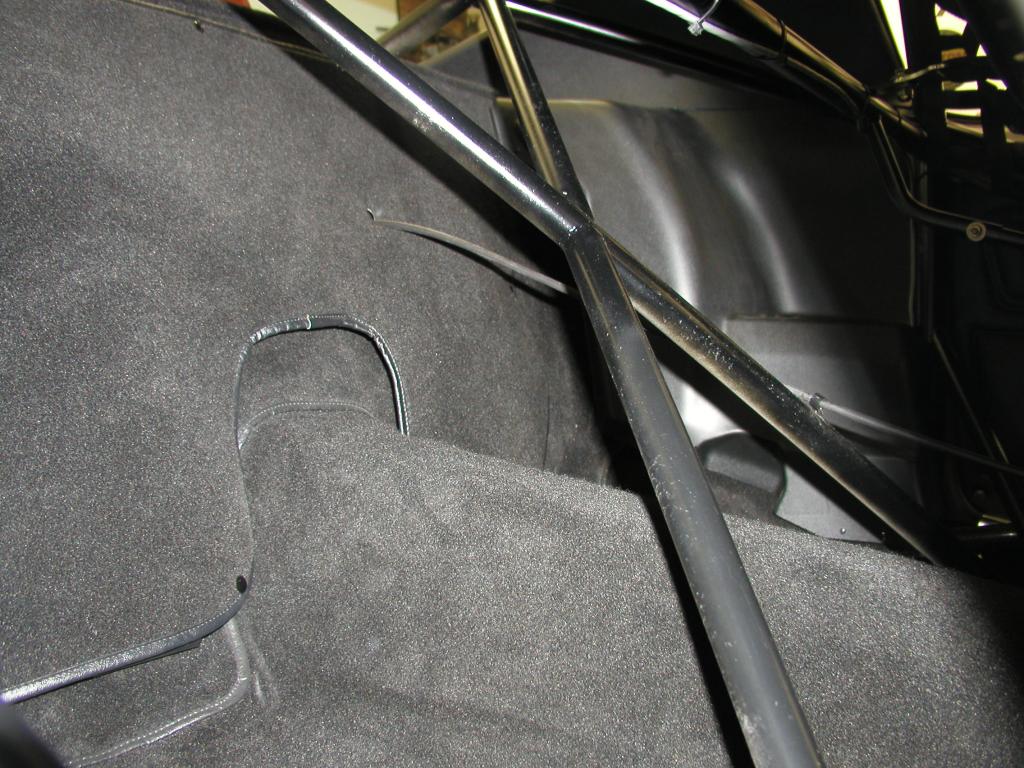

Pictures attached are trunk area where bracketry attaches to battery hold down area, Lokar lever on shifter, &amp; where cable goes through back seat area to trunk. Hope this helps.

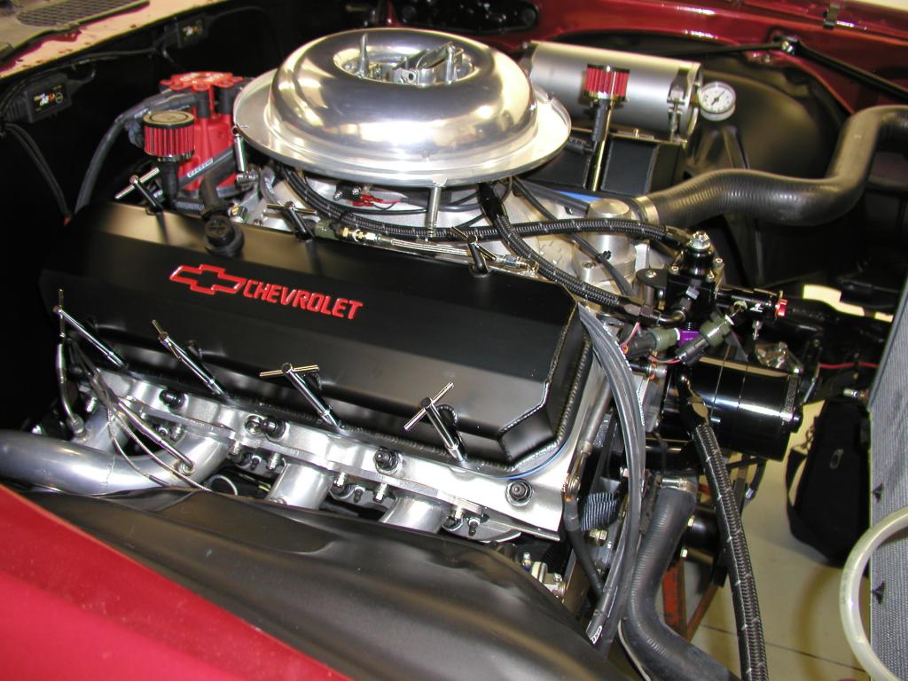

Your 70 Camaro is very nice and well detailed car. Is that a Borgeson steering box? Who sells the lower LH alternator mount. There is a lot of nice detail in your engine compartment.

Thanks, a lot of work, but I am very happy with the results. Flaming River sells the steering box, it is a kit, with a different arm and a sliding shaft with U-joints for alignment to the column. The alternator deal is from East Coast Auto Electric, they have kits for all kinds of applications.
