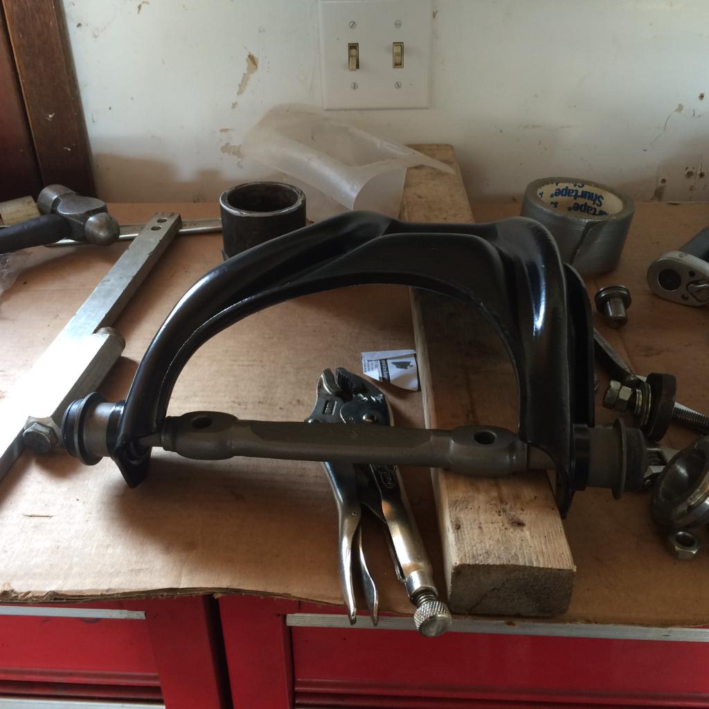

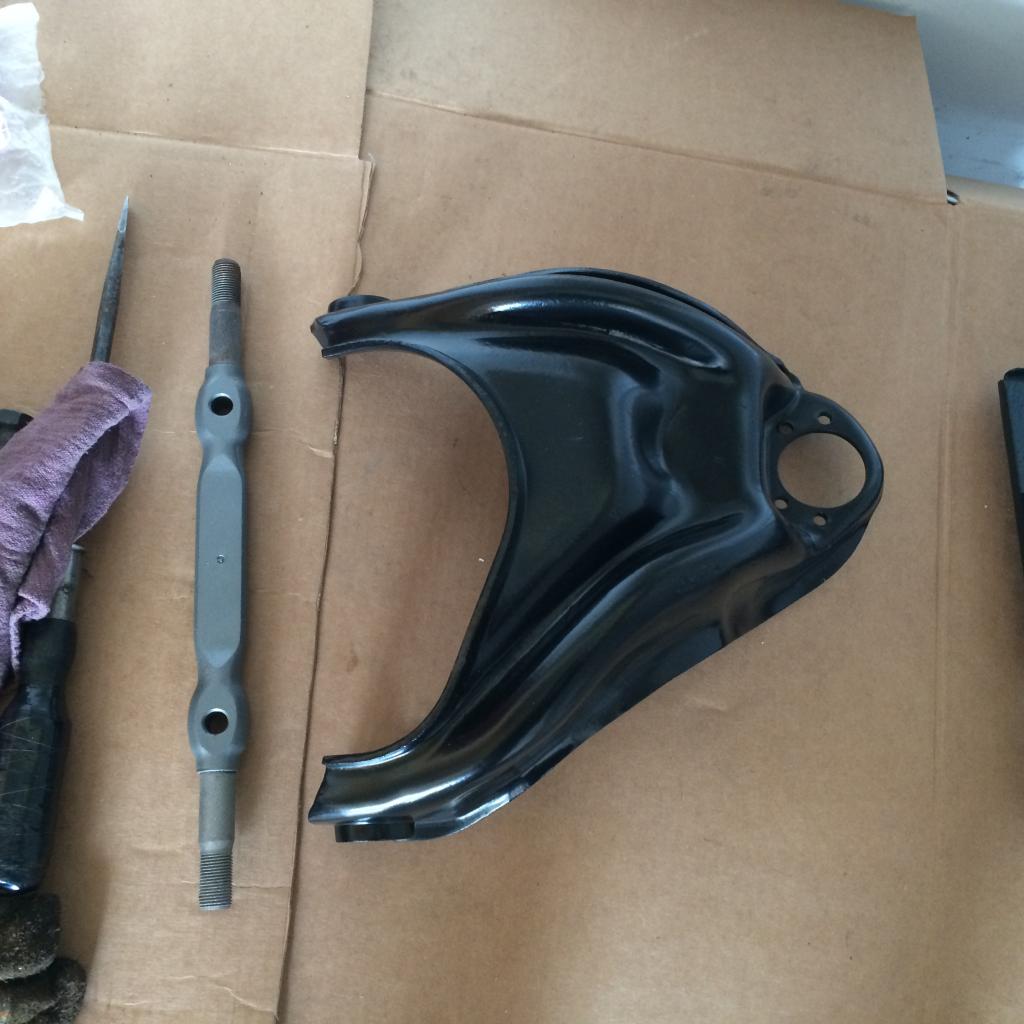

PS: Started preparing to assemble the front upper control arms, by my measurements the cross shafts are not side specific and don't matter if they are installed 180 degrees either way.......

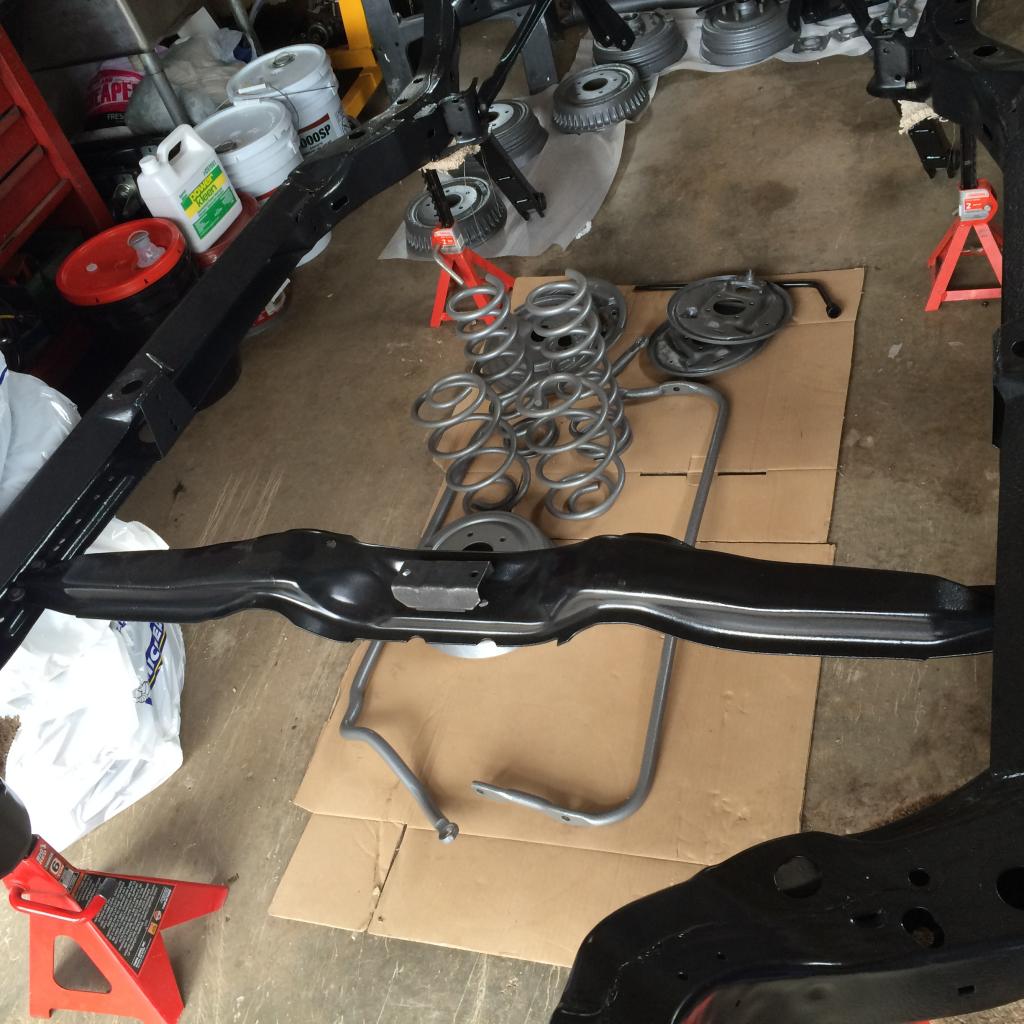

Getting ready to assembly the front uppers.
Installed the cross member.
I enjoy using the assembly manual:-)
Ryan

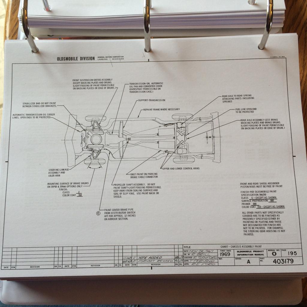

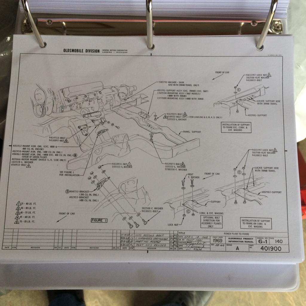

<div class="ubbcode-block"><div class="ubbcode-header">Originally Posted By: olredalert</div><div class="ubbcode-body">----Ryan,,,That assembly manual is about 100% better than the 67 manual I have. I'm impressed! Where did that come from?
----By the way, I still have that trunk divider for you. Didn't want you to even have postage on it so Ill get it to you when our paths cross again......Bill S </div></div>
&quot;67 442&quot; Paul H Sigmund on sYc reached out to me as soon as I showed off my new/old car, and this assembly manual is better than the Chassis manual in some areas it has more information. For example, do the cross member bolts go from the top or up from the bottom? This manual shows how the bolts were installed in each type of vehicle:-) I looked page by page through the chassis manual and did not find this detail.
The page that shows how each part of the chassis was to be painted is a real gem.
