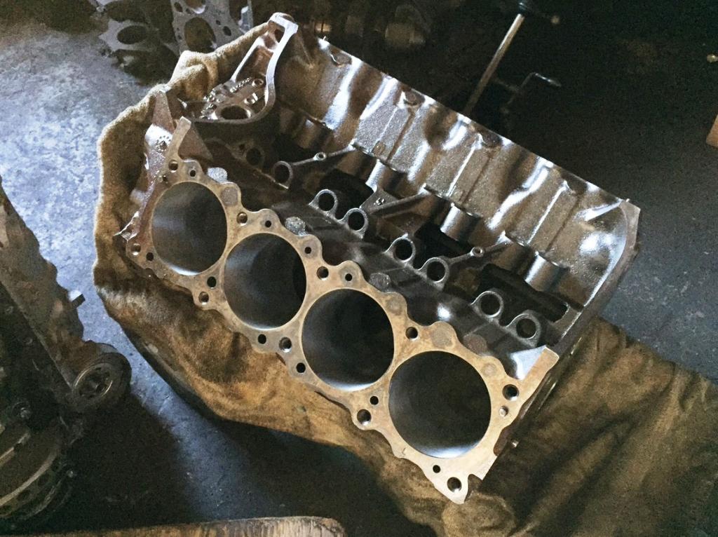

Stopped by the shop to drop off the pistons and rings. The block has been bored and is awaiting the final honing to size.

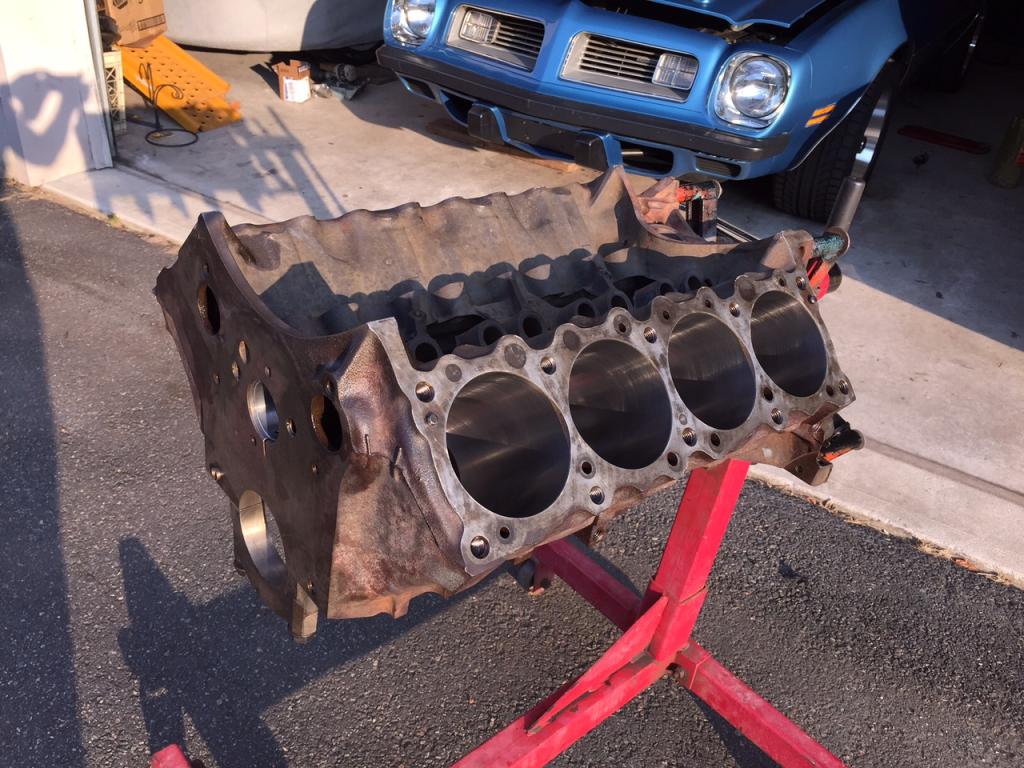

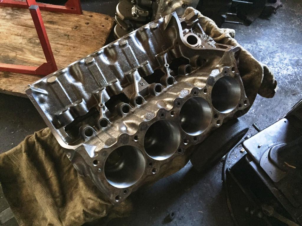

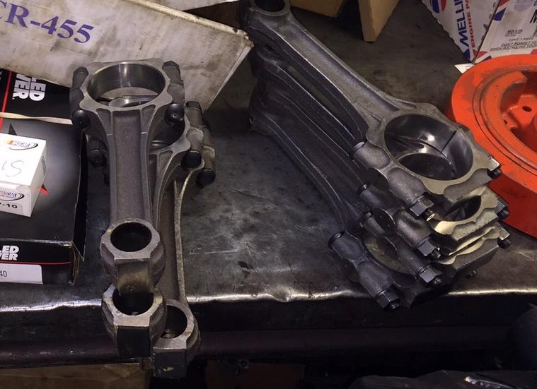

Rods are refinished and awaiting the crank to come back from cutting. Then the reciprocating assembly goes for balancing.
And the block is finished and home:

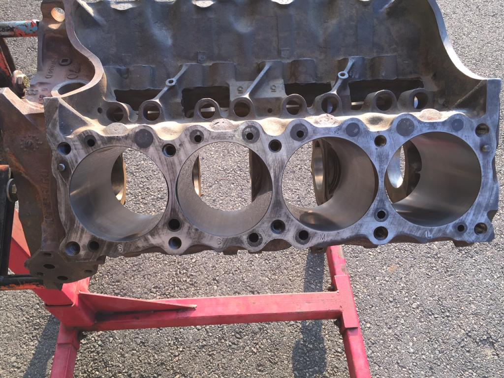

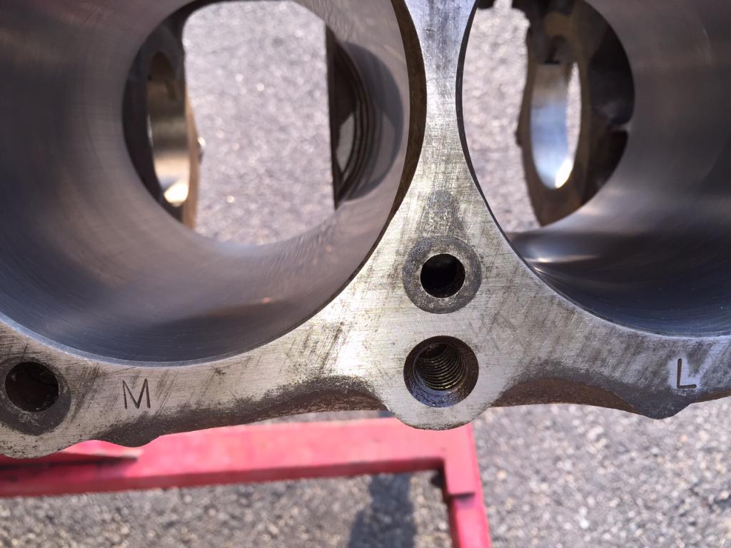

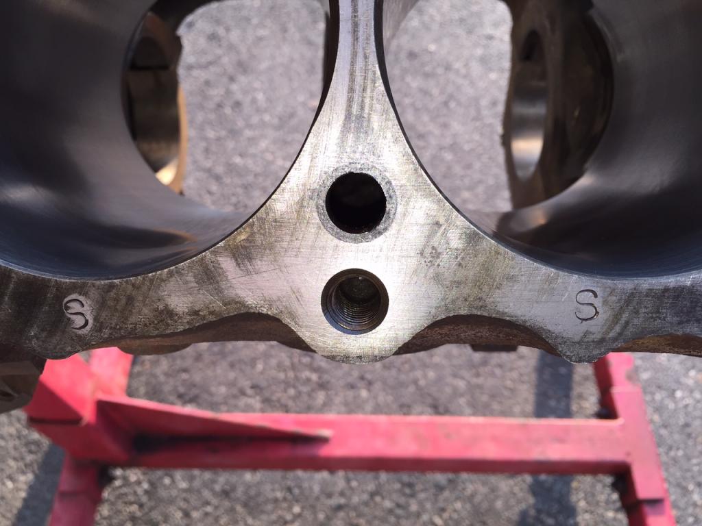

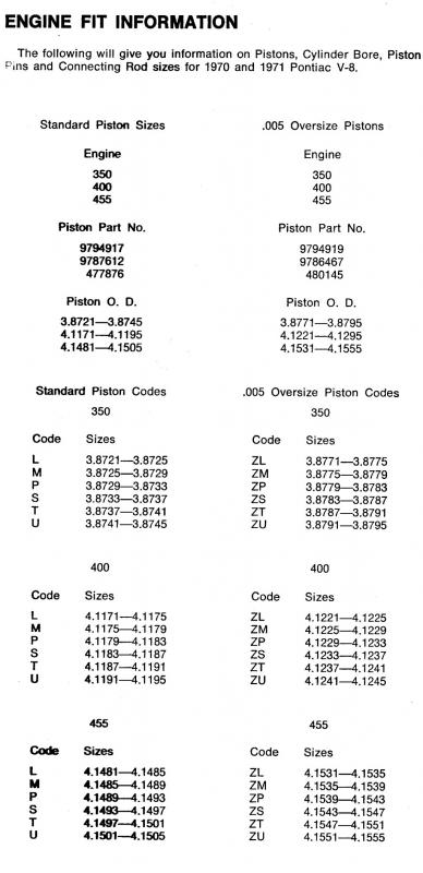

Here's something interesting. There are stamped letters next to the bores. Are these for selective fit piston assemblies? "S", "M", and "L" for small, medium, and large? The 1975 350 block in Gramma's car had similar stampings on the deck surface as well, only they were the letter "P" next to each bore. The machinist said he has seen these on other Pontiac blocks over the years.

Old 08-31-2015, 11:03 PM
Ryan1969Chevelle's Avatar
Join Date: Nov 2012
Posts: 5,959
Thanks: 581
Thanked 872 Times in 458 Posts
Default Re: Gramma's Car: the new project!
Cool, like Olds Select Fit!
One of the guys over at PY just responded with this chart for selective fit pistons for 1970 and 1971 Pontiacs. Looks like I was right!
