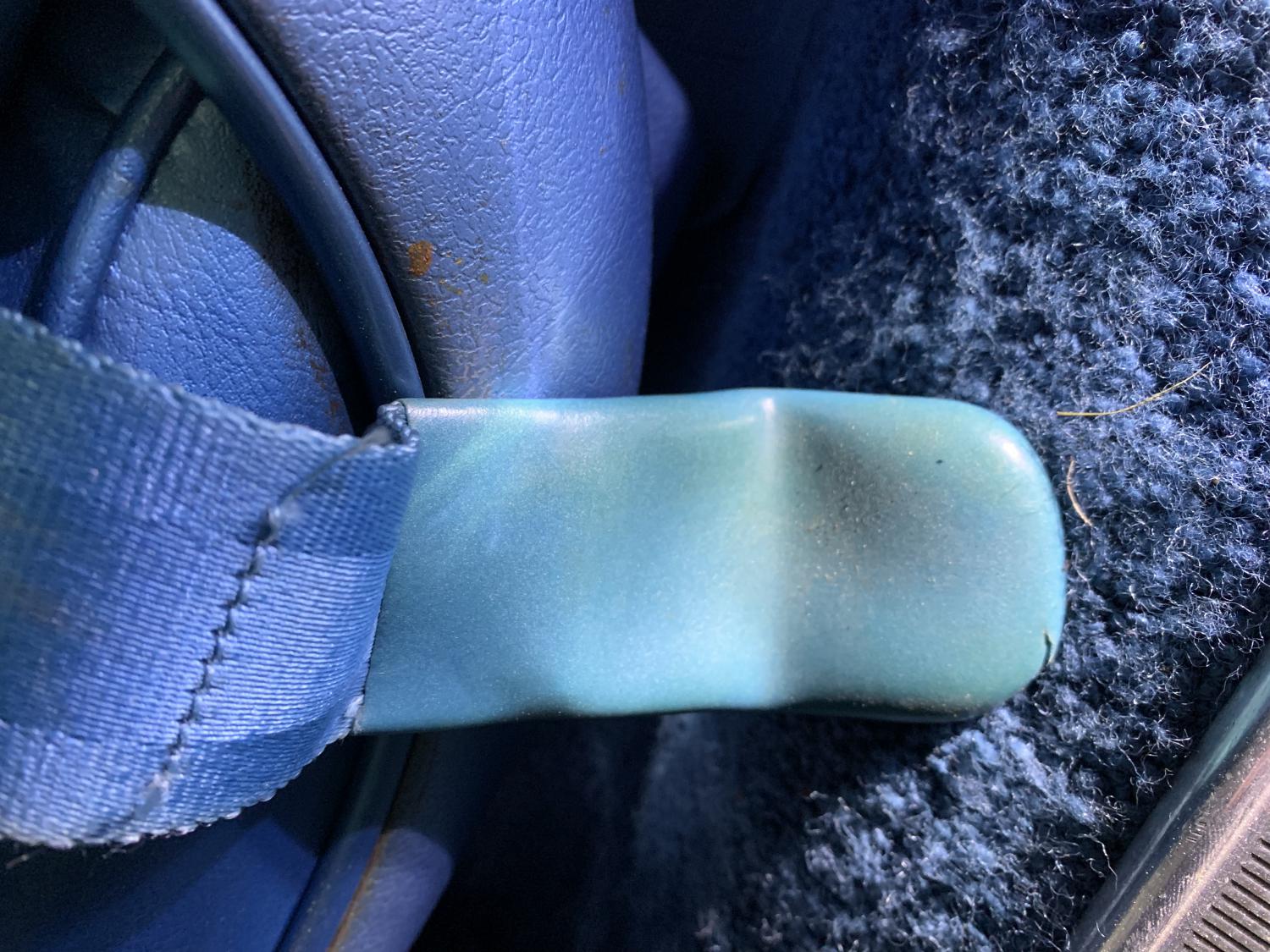

I have observed an ATL '66 L78 with the straight covers, don't recall the TT date.
Attached is my 10C ATL '66, far too early to be L78. Early '66's have several unique features. - Bill W

Thanks Bill. I think dads car is a mid to late April build. So it sounds like the tear drop style vs the straight may have been more of an early vs late? BTW I love the picture of the seat bottom highlighting the seat colored pipping. I have to wonder sometimes if the knowledge has been lost that they are suppose to be color and not chrome.

My Marina Blue 66 SS L-78 04C Atlanta with Deluxe Belts
