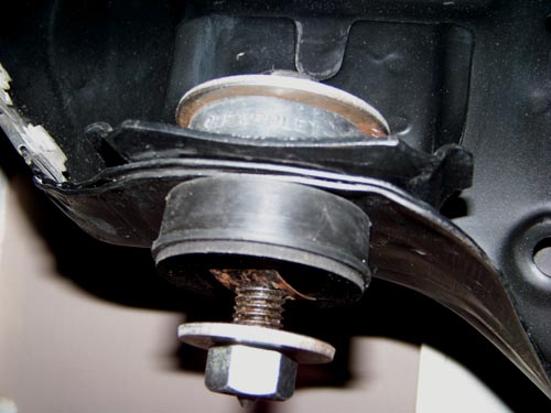

Installing the rad support with the bushings is an easy one man job IF you use the factory speed nuts or push on retainers, otherwise you feel like you are at least ONE arm short.
FWIW these are called out and illustrated in the AIM, it's just no one puts them in the hardware kits.
