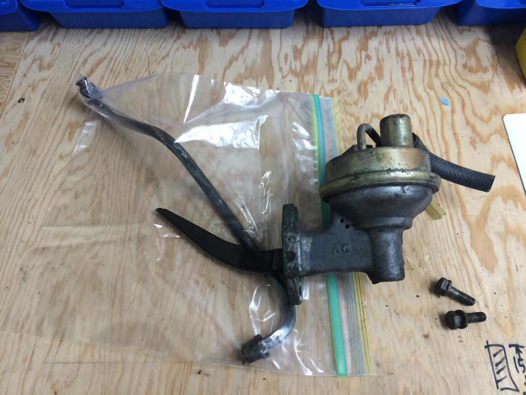

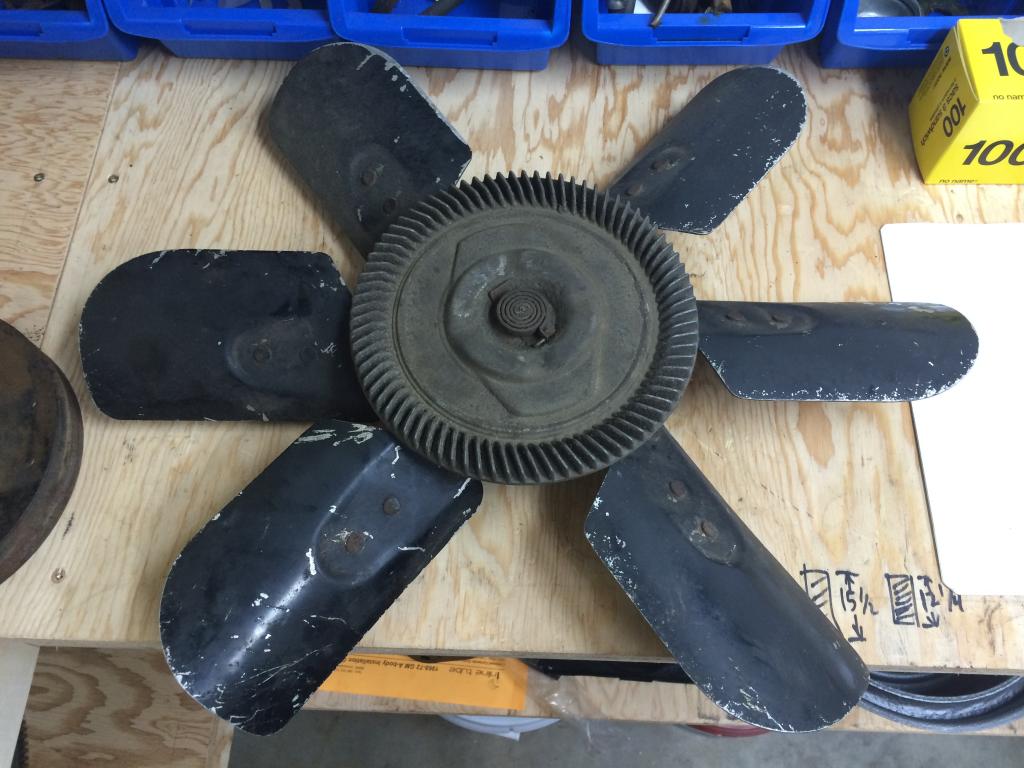

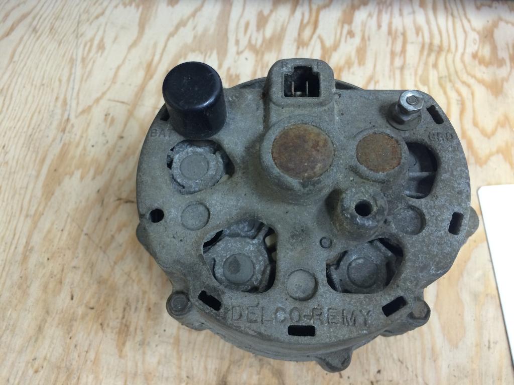

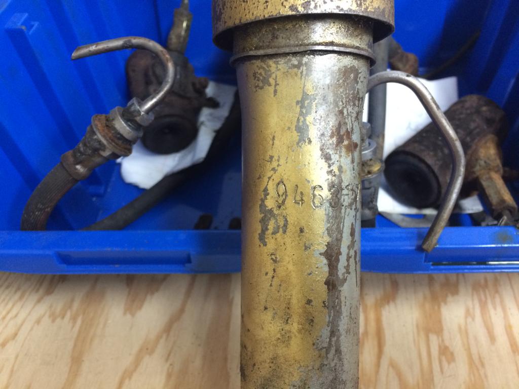

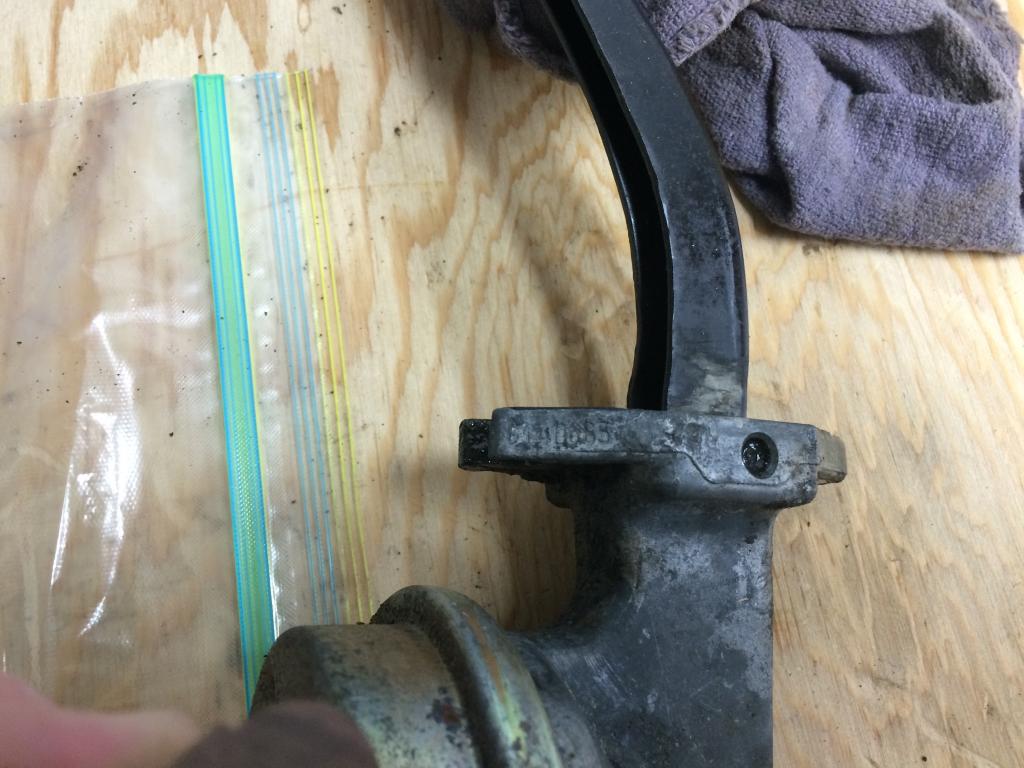

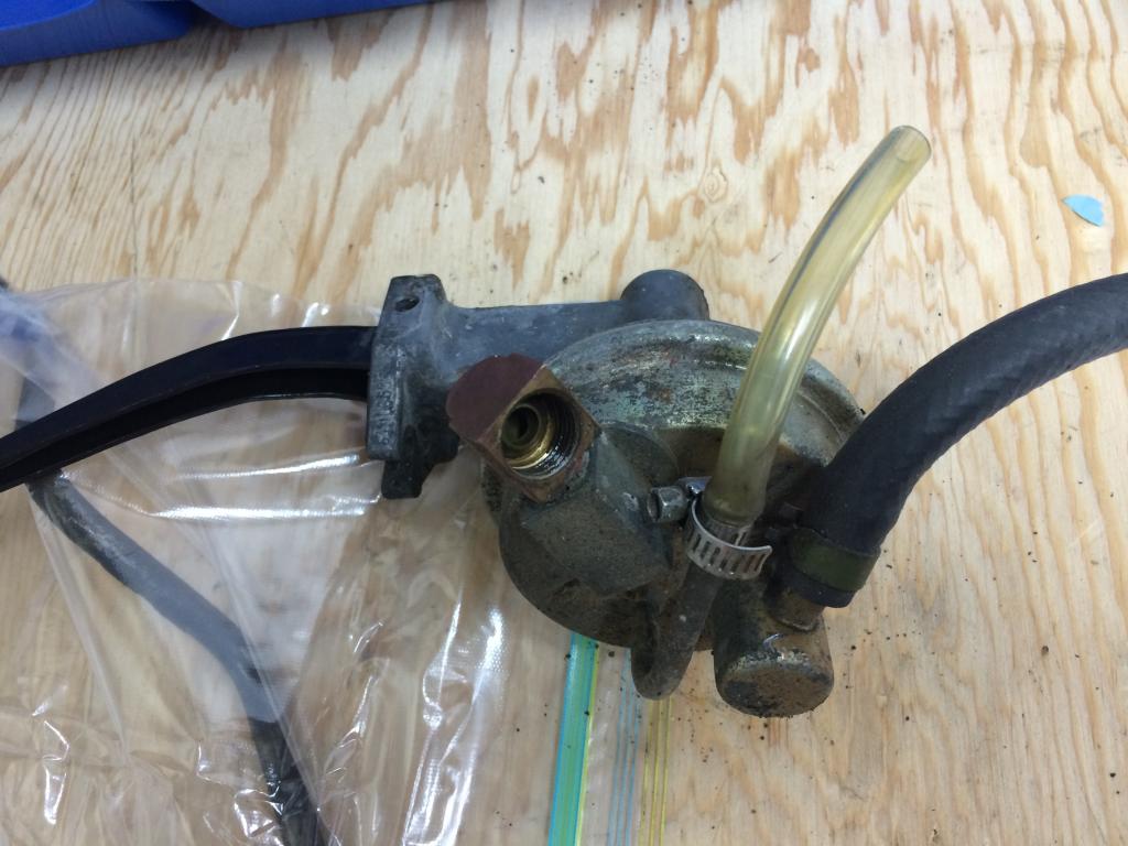

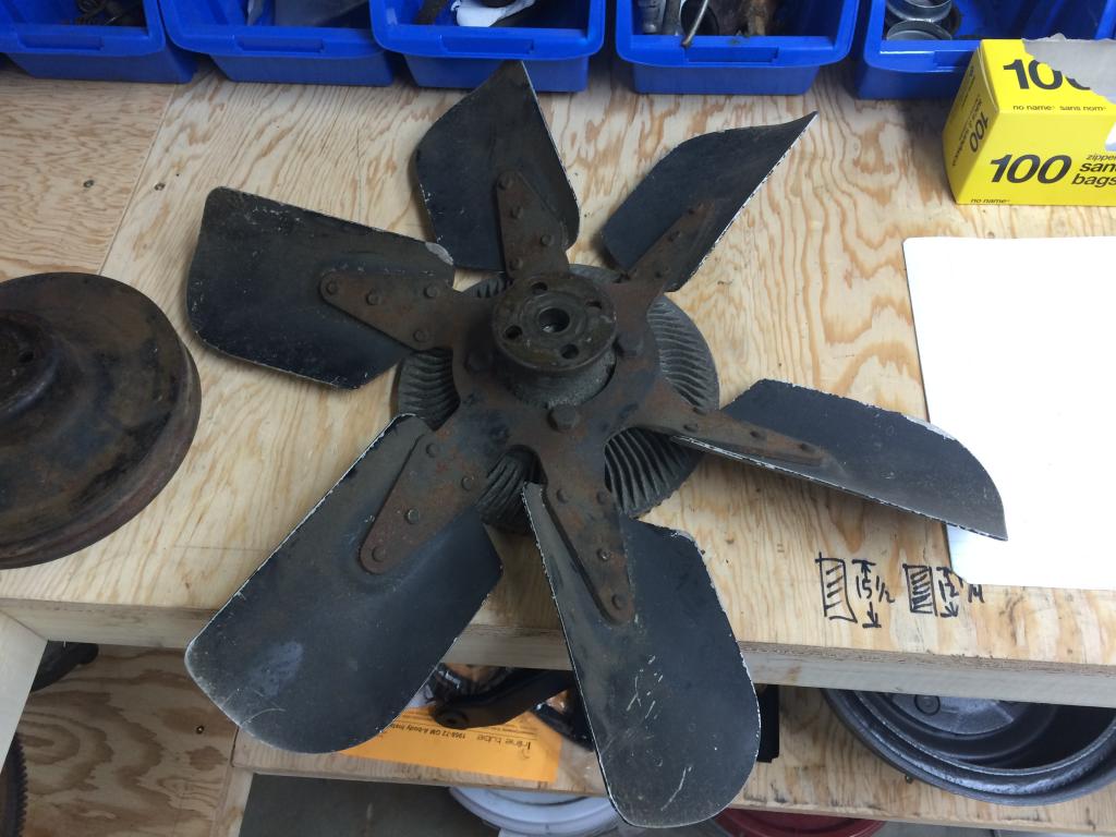

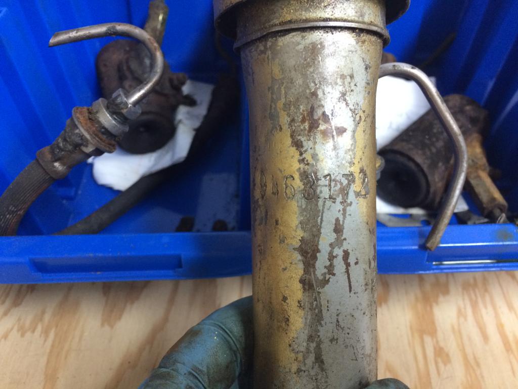

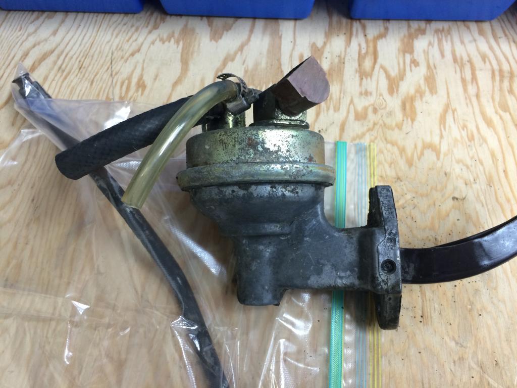

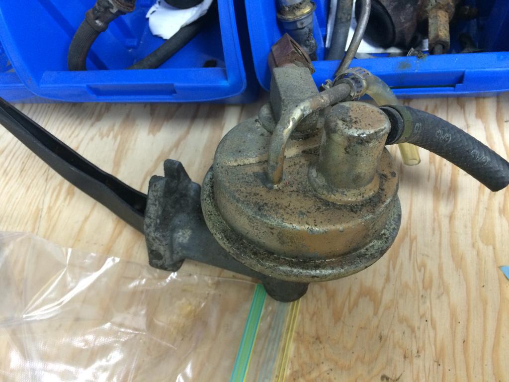

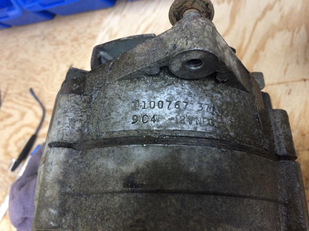

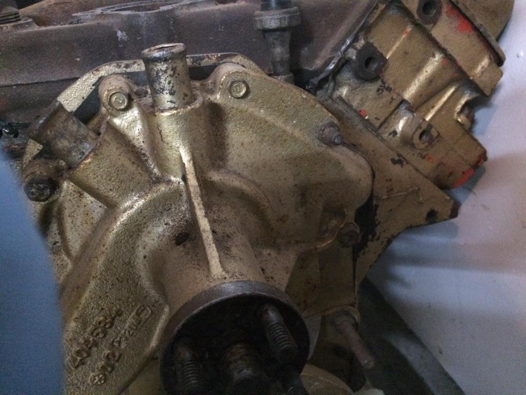

Original alternator. (I remember checking the numbers a while back)
Original fuel pump (checked numbers in the pink charts in my assembly manual)
I will check for numbers as I gently clean the fan, I think it is to have a U0 stamp?
Original pulley KA:-)
Ryan

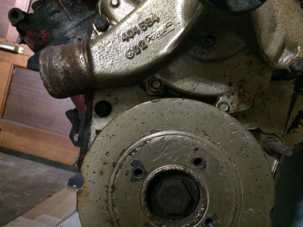

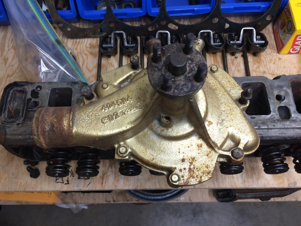

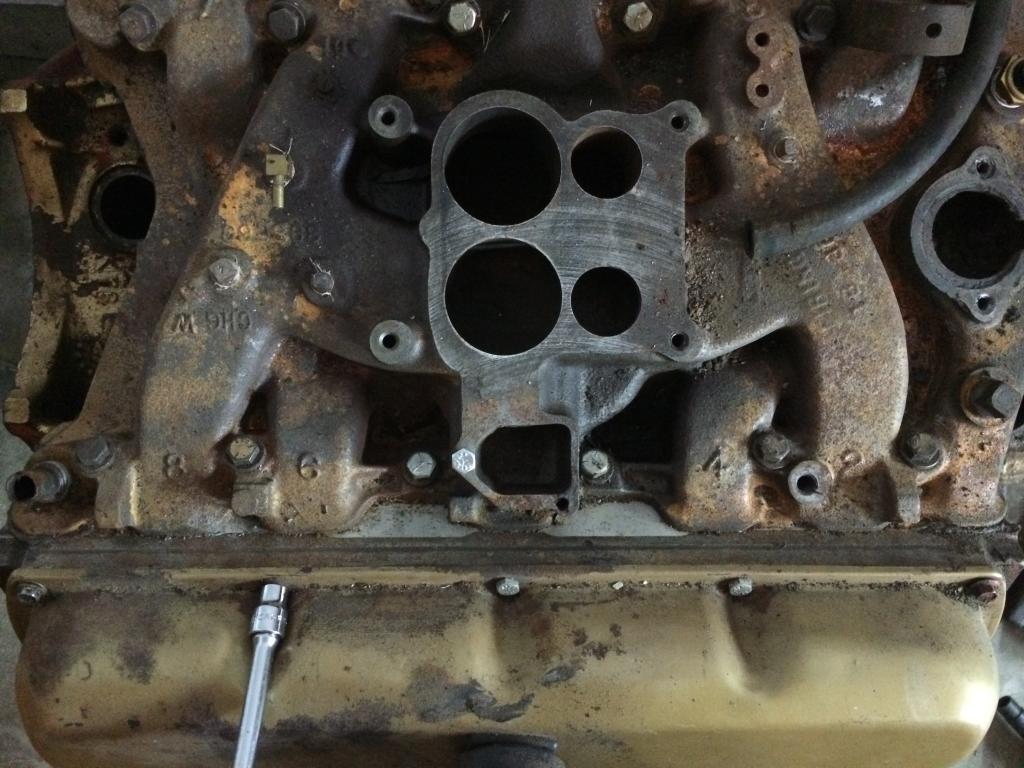

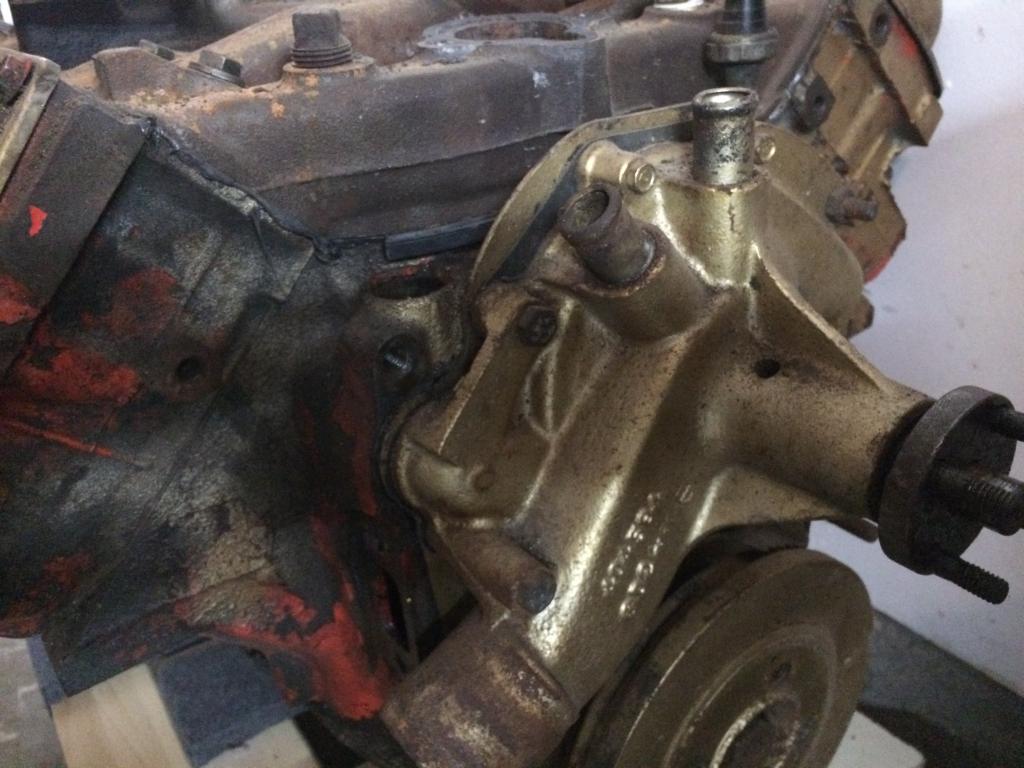

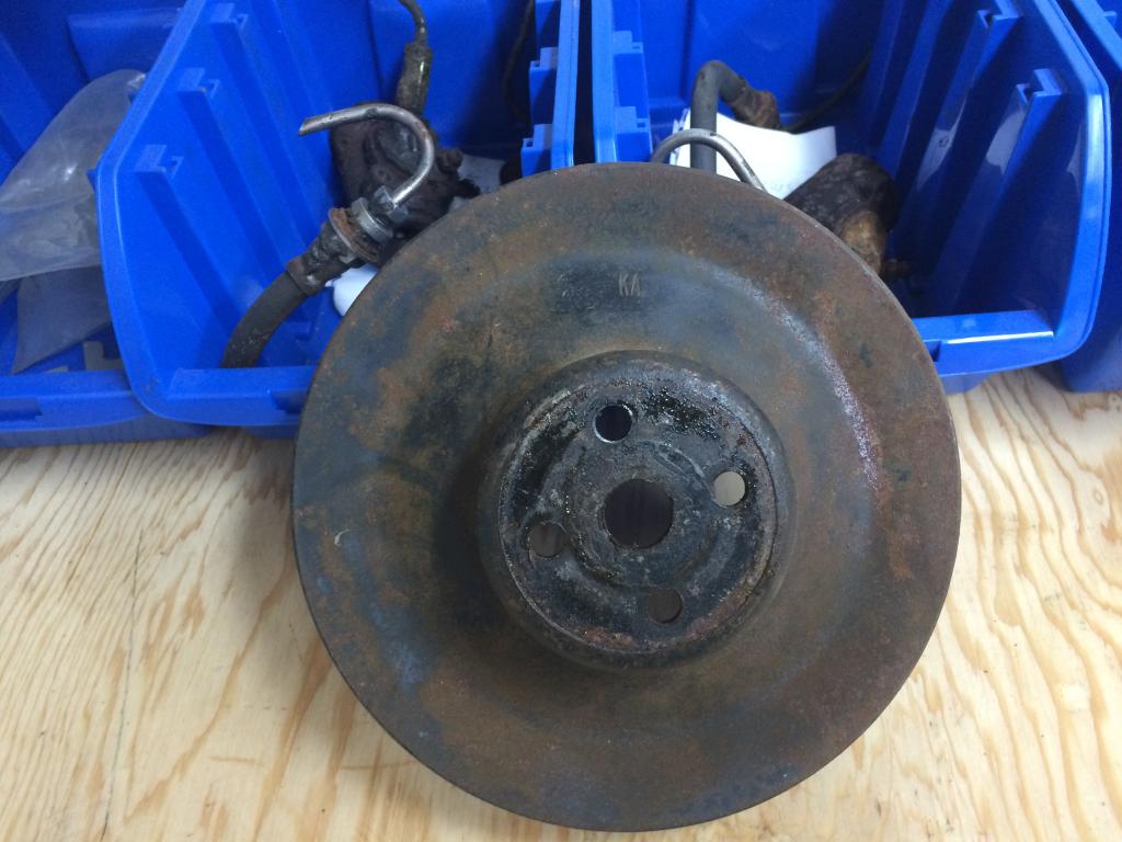

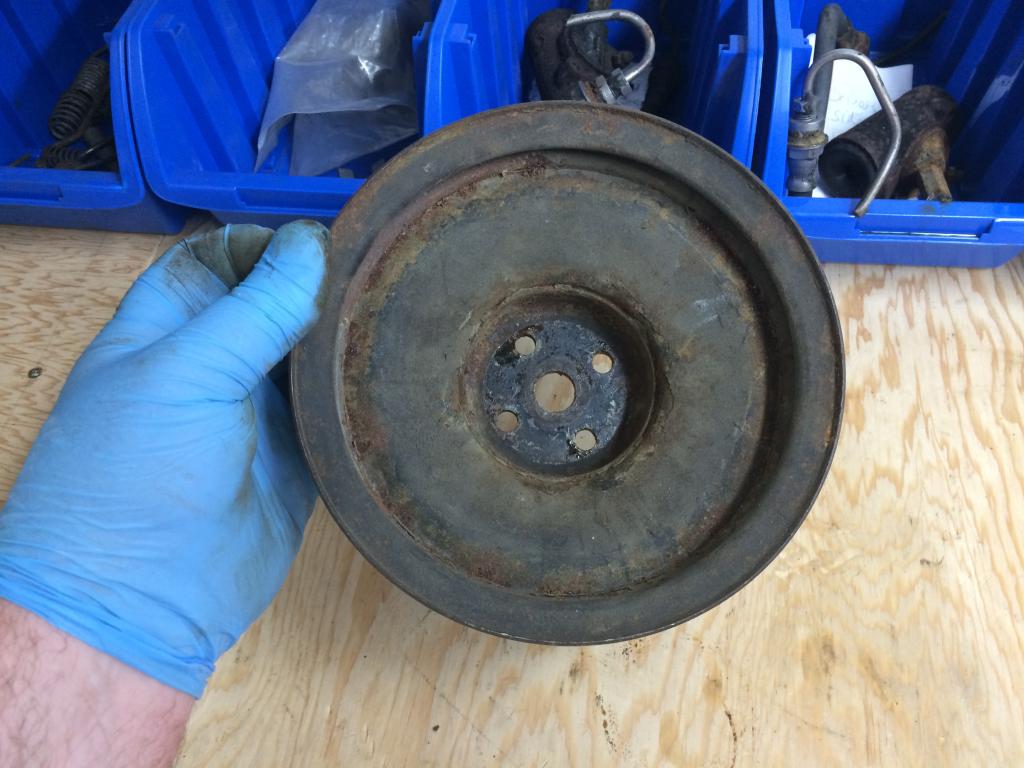

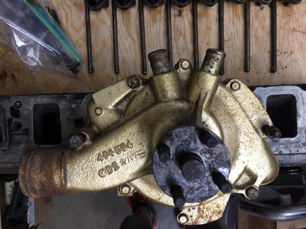

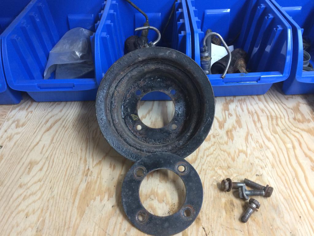

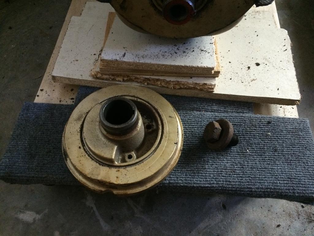

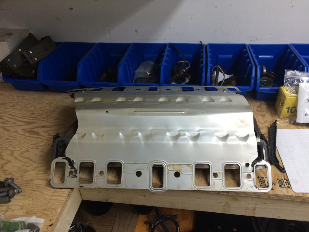

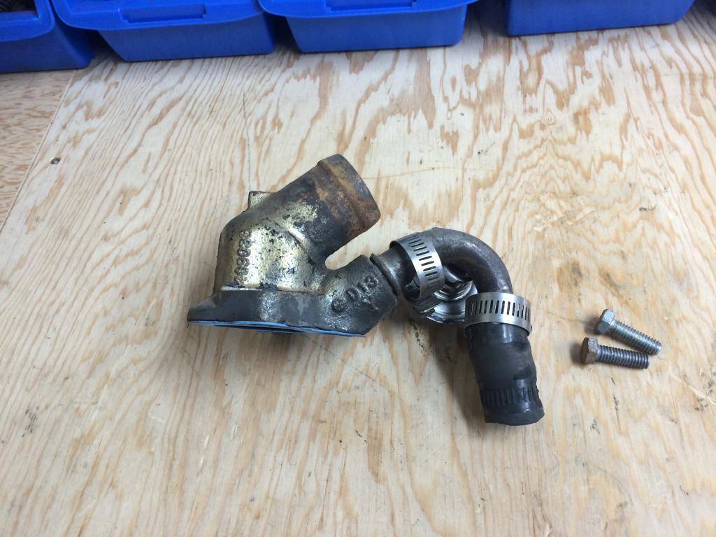

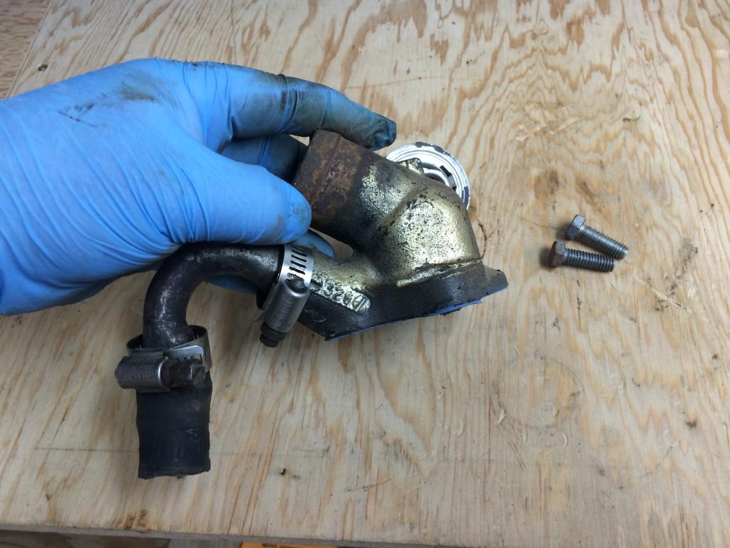

I need to figure out if this is off the extra engine or original

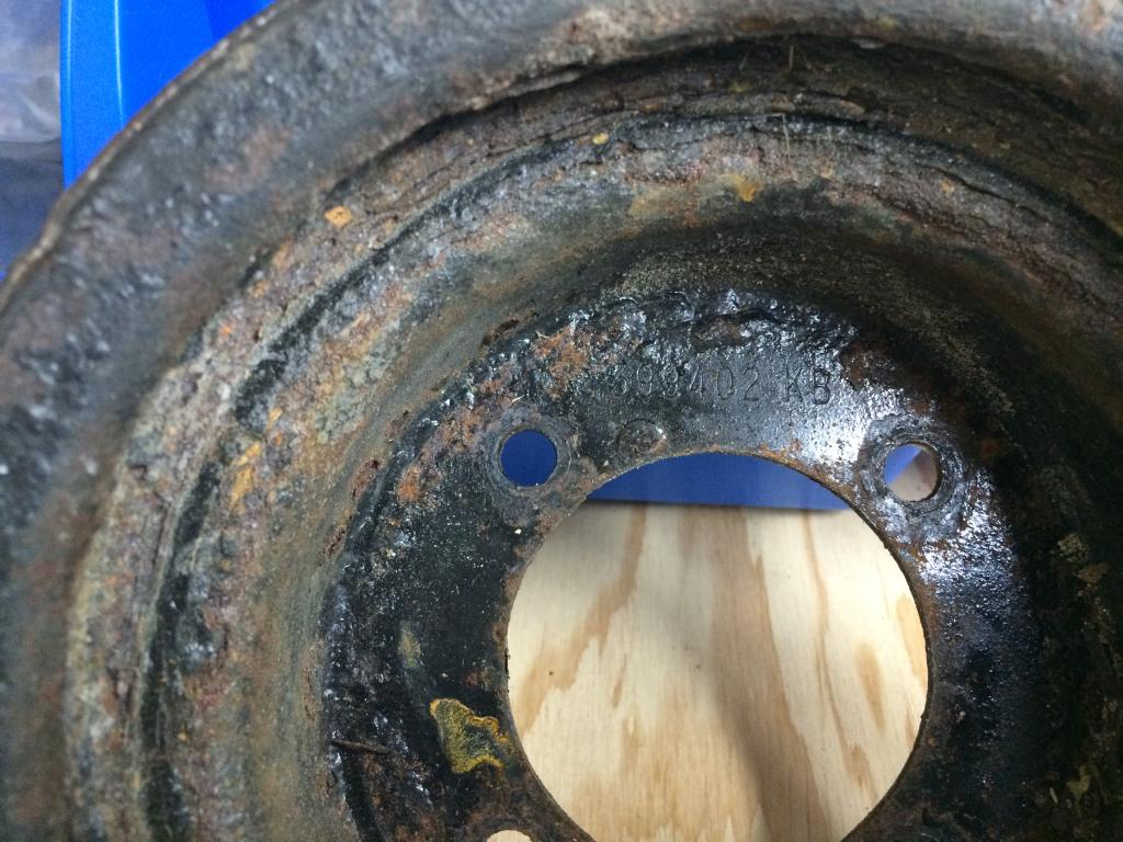

KB Crank Pulley
Again, need to check if this is original? (I could tell by all the damage that it was taken out at one time:-(

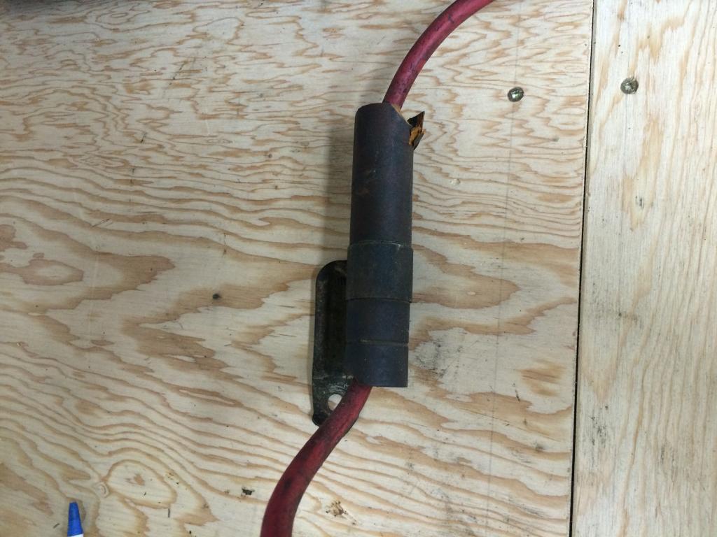

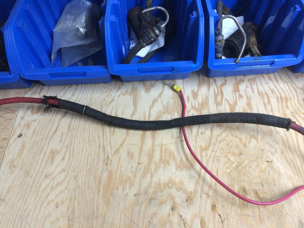

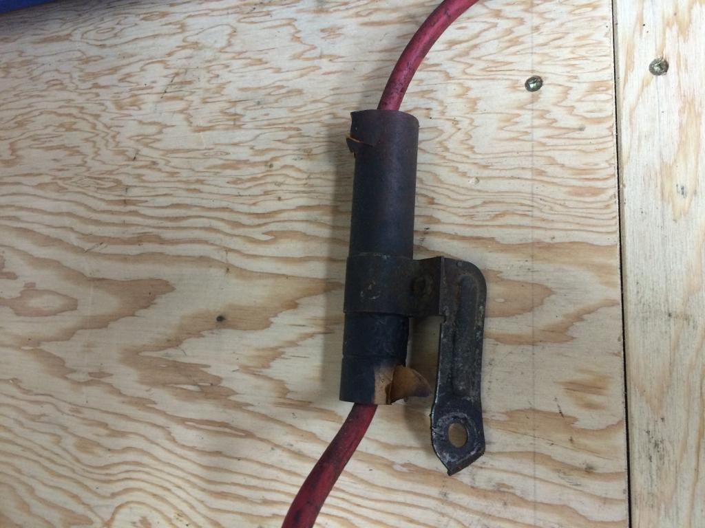

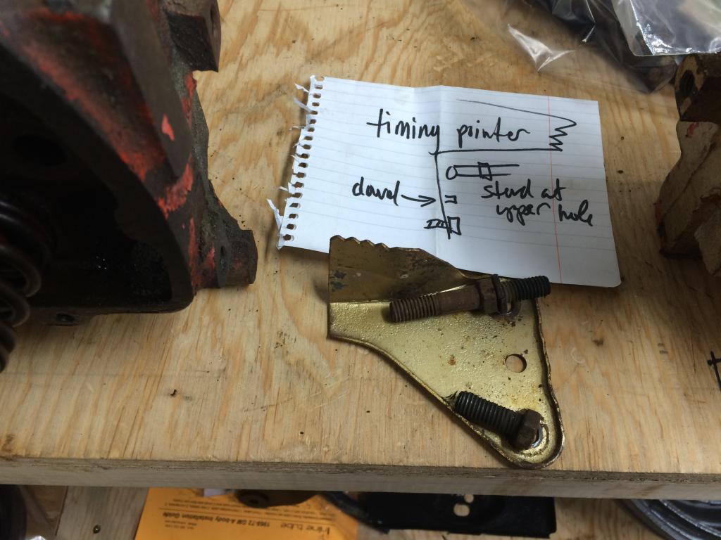

4 speed specific item to route the positive battery cable.

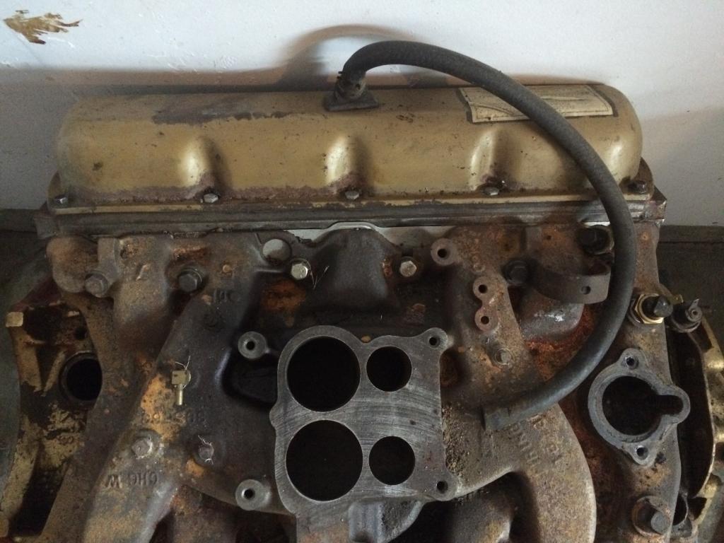

Intake
Water pump
Ryan

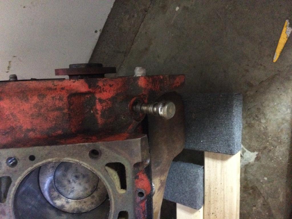

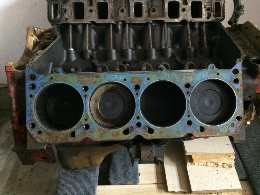

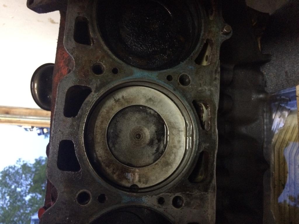

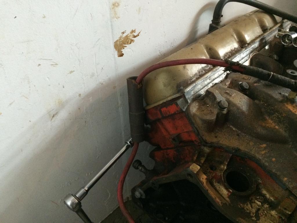

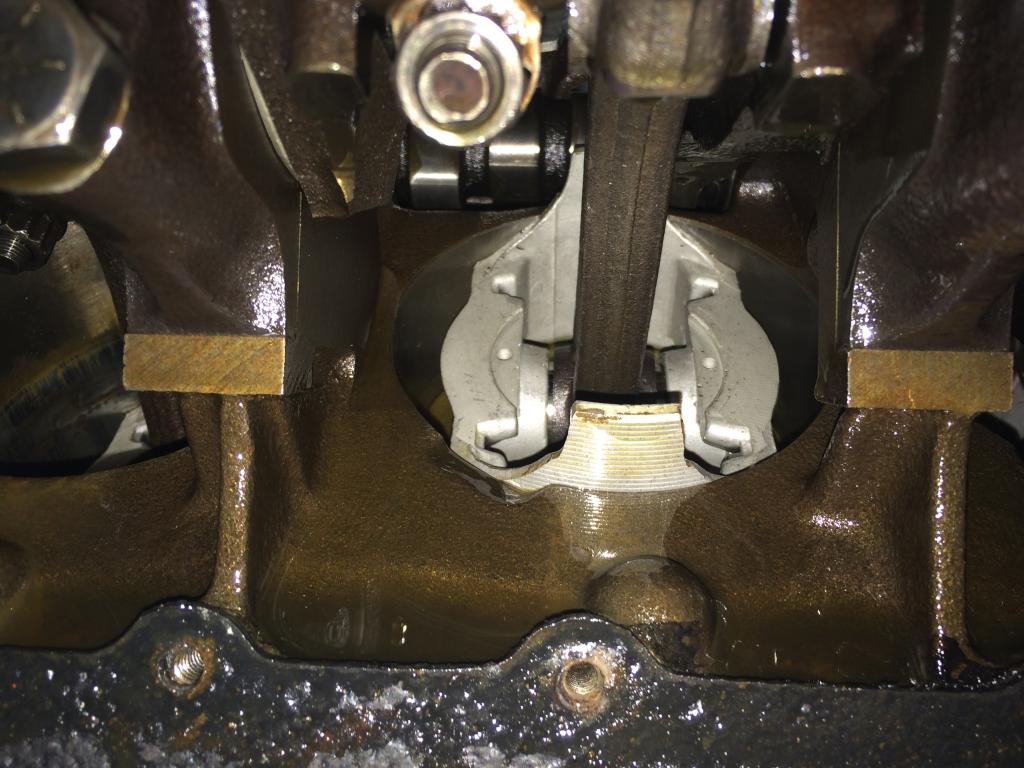

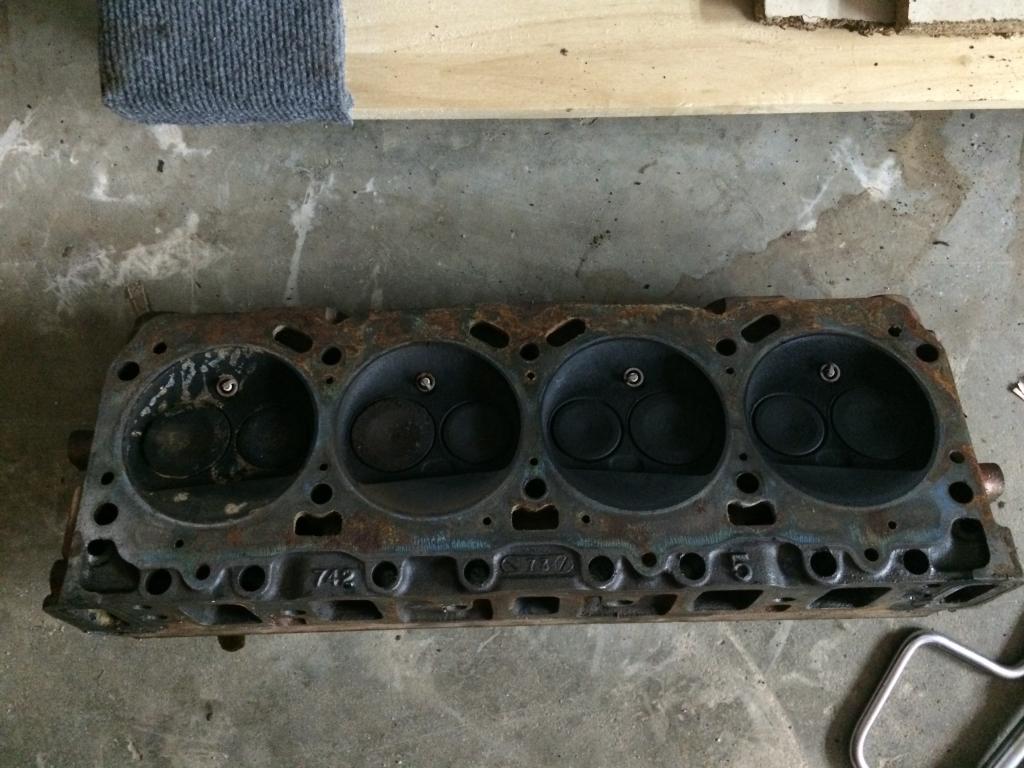

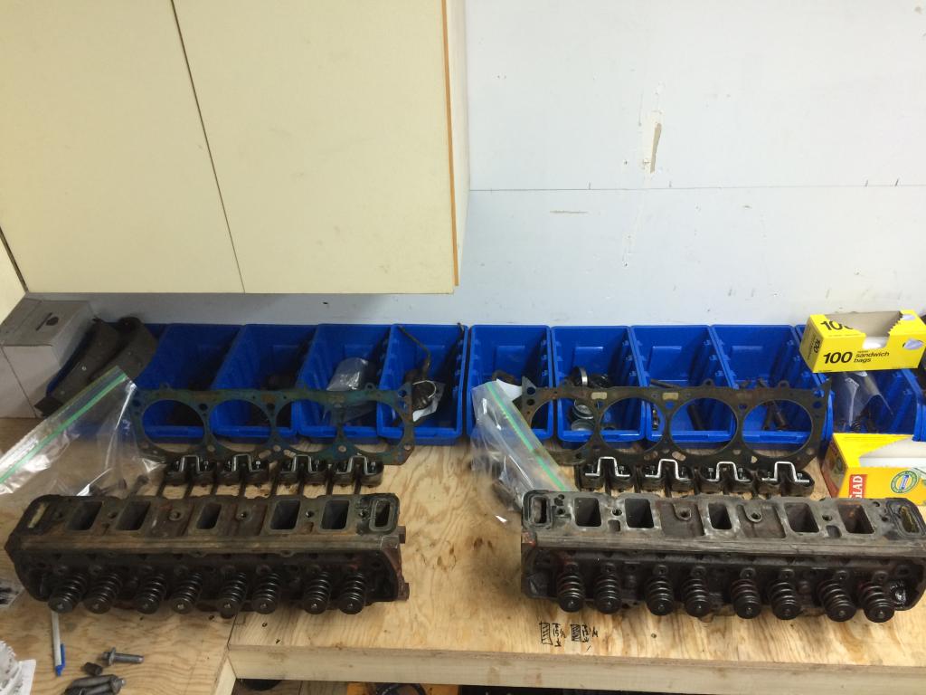

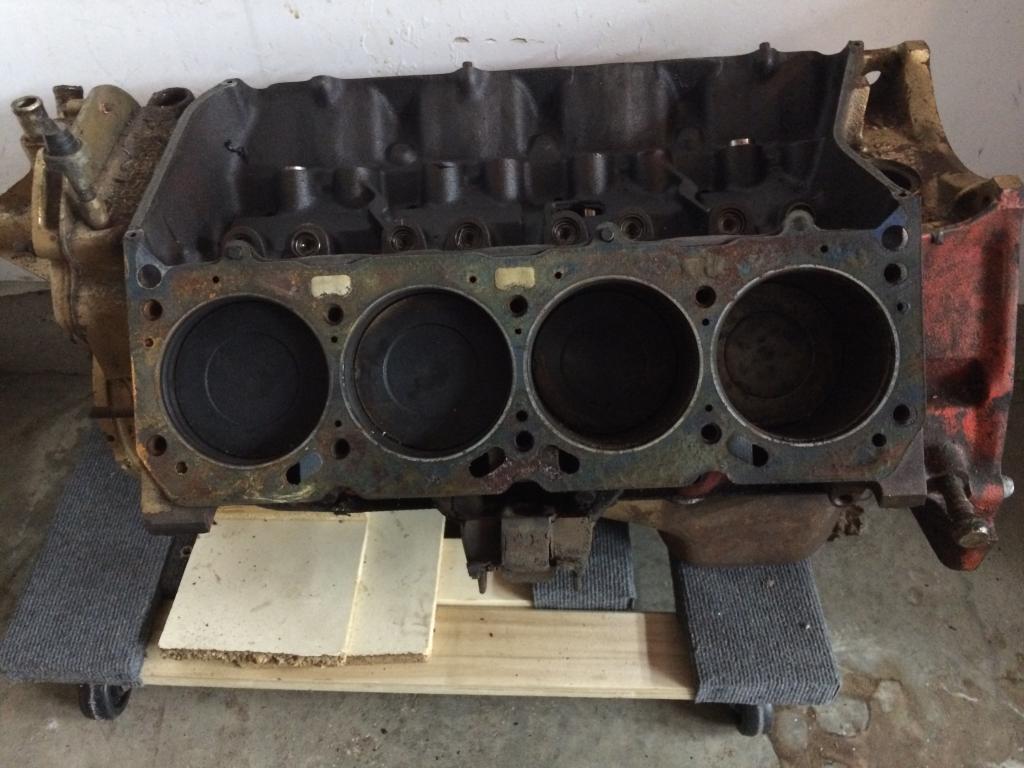

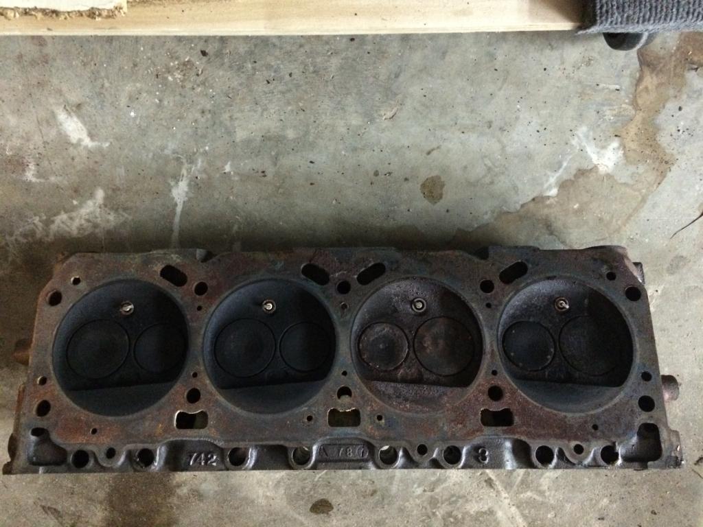

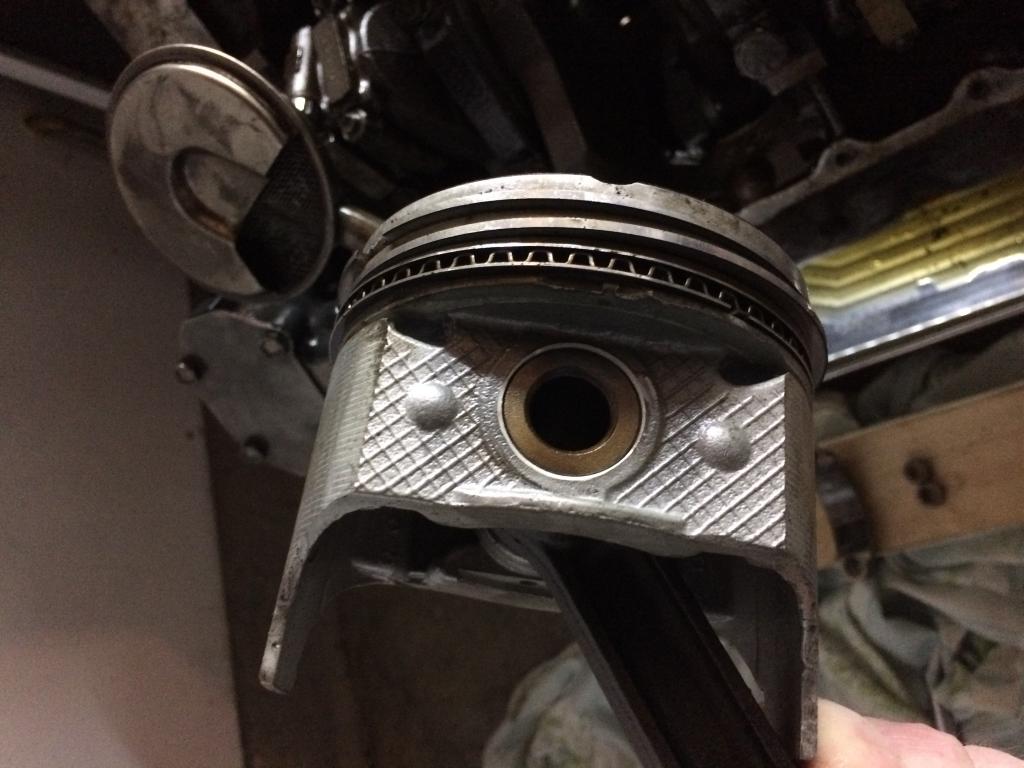

Now the meat and potatoes:-)

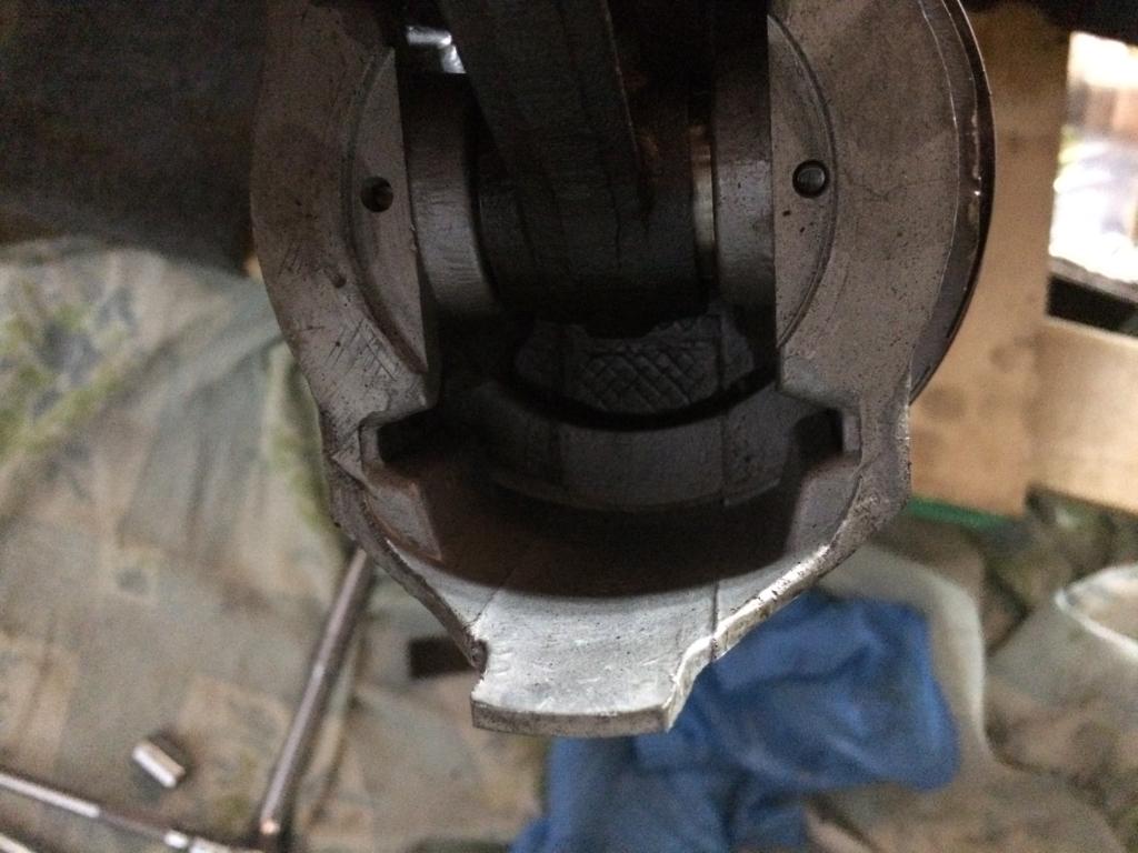

Dished pistons, but condition is good, small valves, but condition is good:-)
Al bought this as a running engine "with a cam" half the head bolts were stinging tight and half were finger tight, some were painted and some were not so the heads were off before he bought it or during the installation a few high schoolers forgot to use the pattern to torque?
All the rockers, and bolts, and pushrods, looked very good, just some surfaces with a tiny bit of wear in the normal locations such as in the bottom of the rockers. All even and all good.
  #1604
Old 06-09-2016, 10:43 AM
Ryan1969Chevelle's Avatar
Join Date: Nov 2012
Posts: 5,957
Thanks: 576
Thanked 871 Times in 457 Posts
Default Re: Ryan Weaver's 1969 Olds Cutlass S W31 Club Coupe

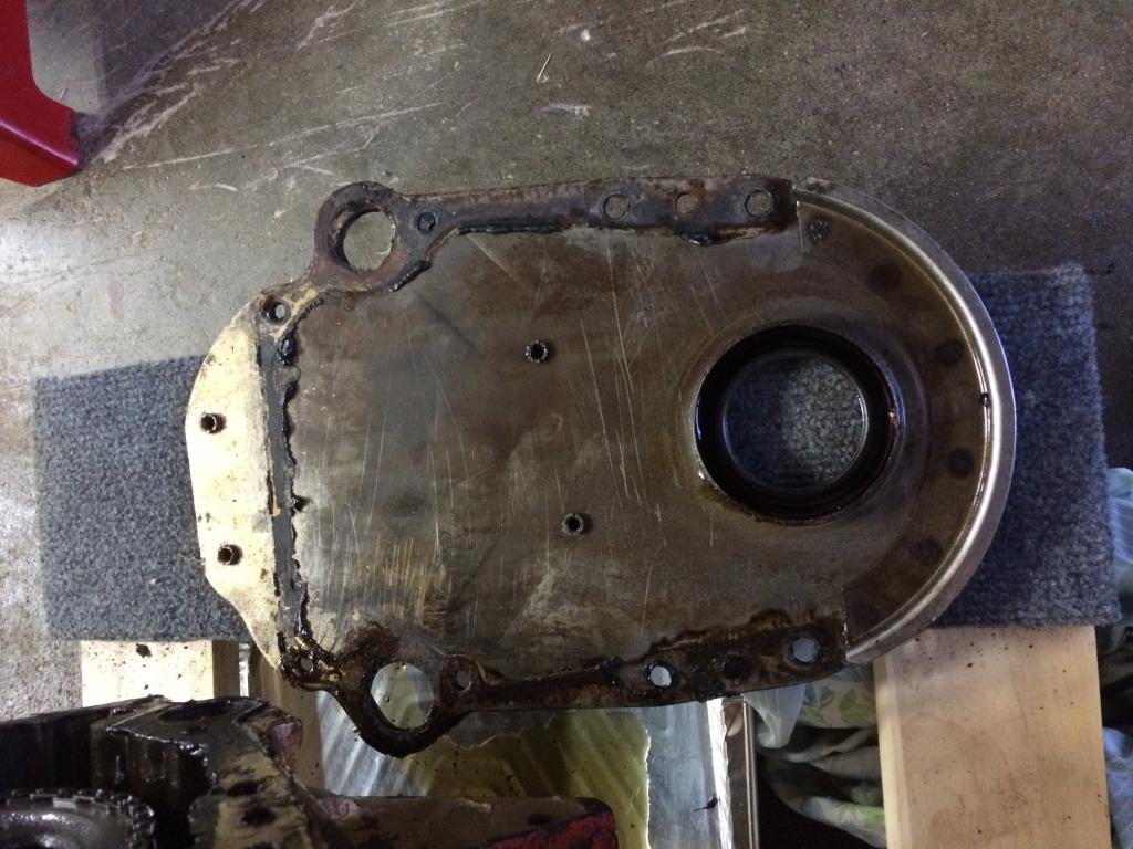

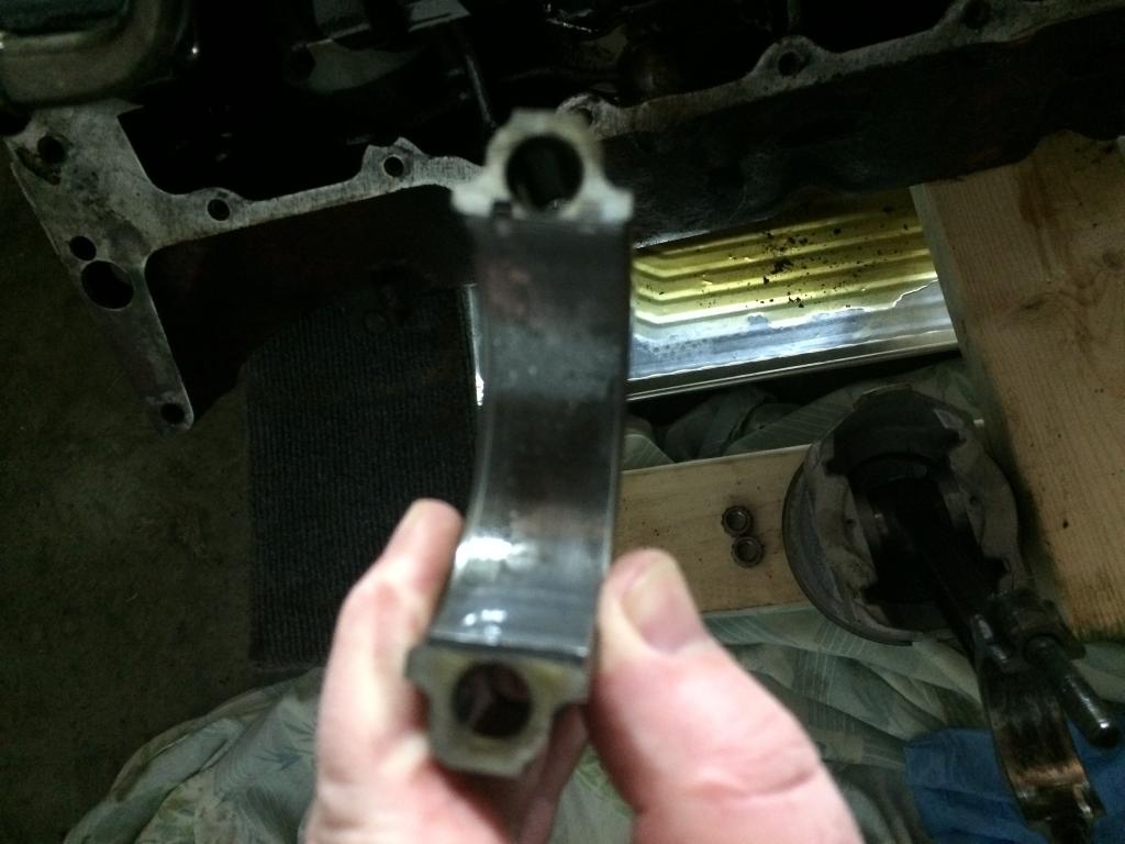

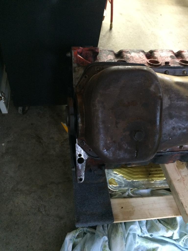

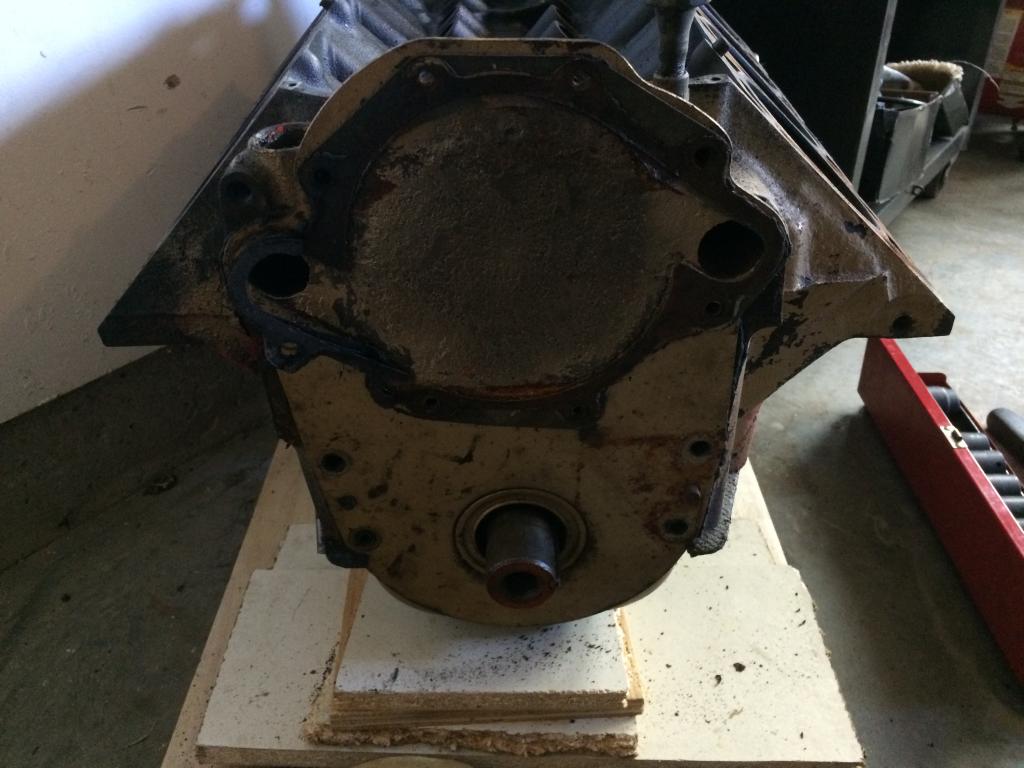

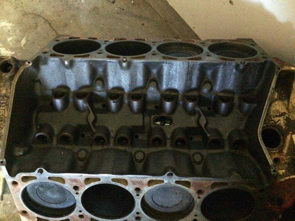

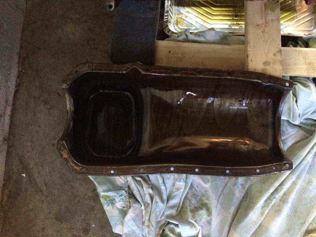

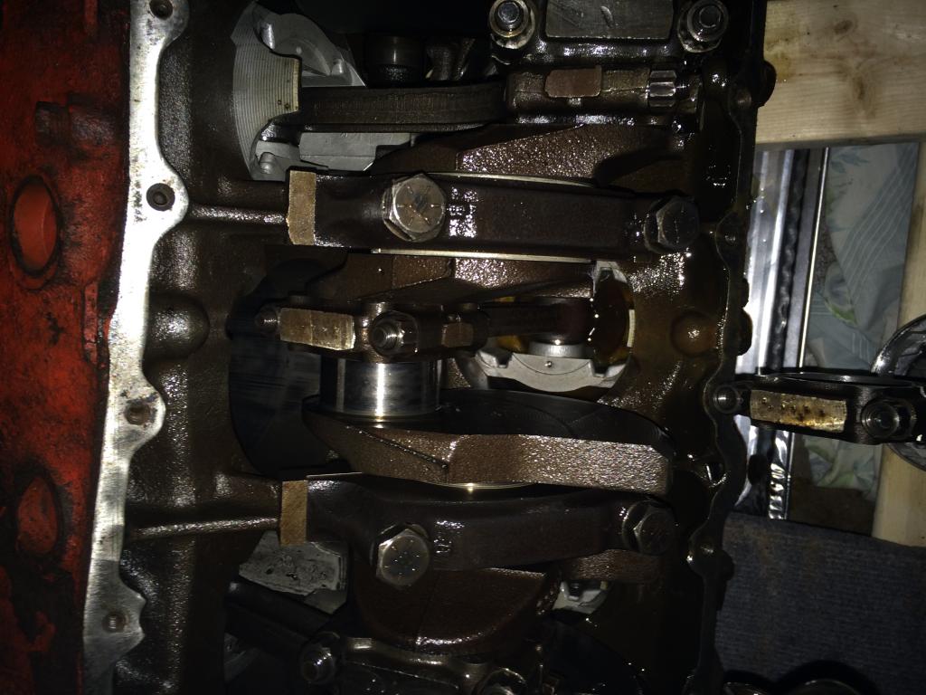

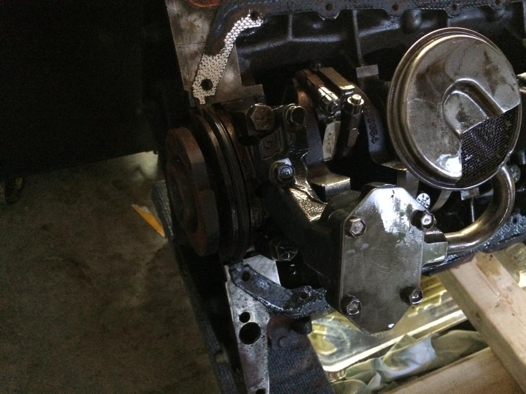

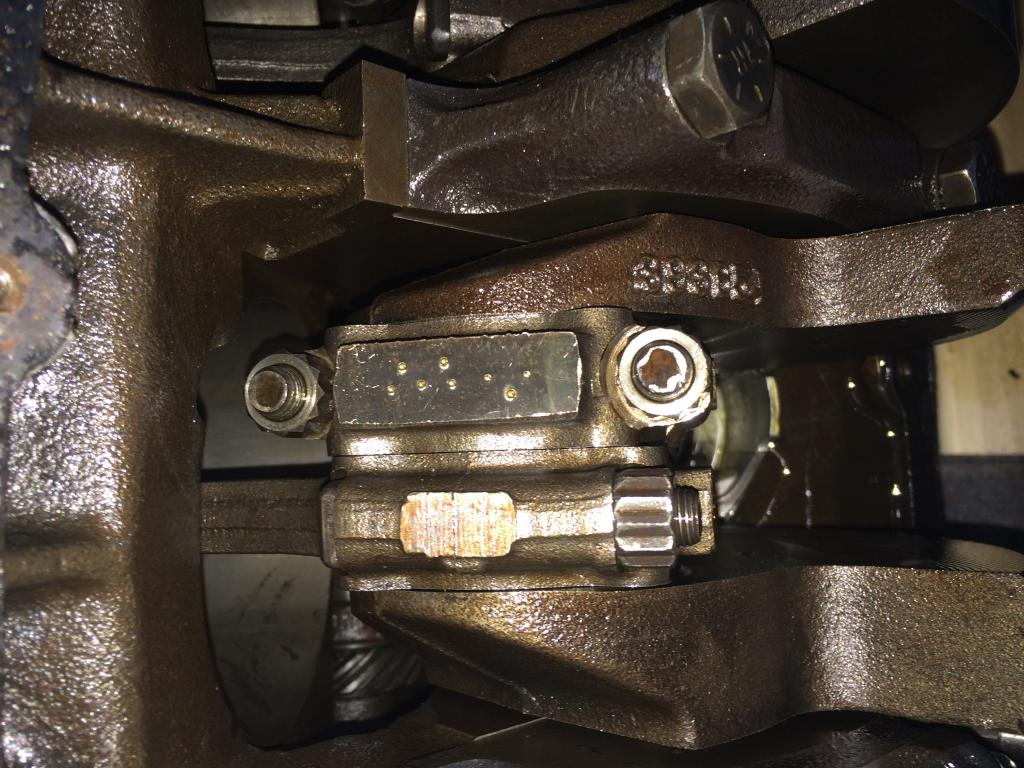

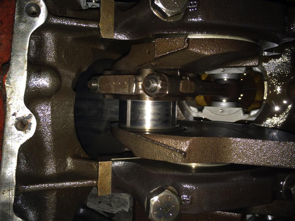

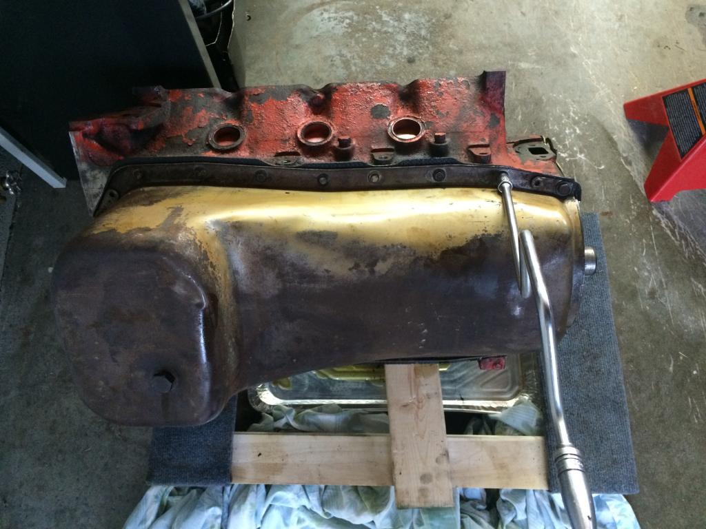

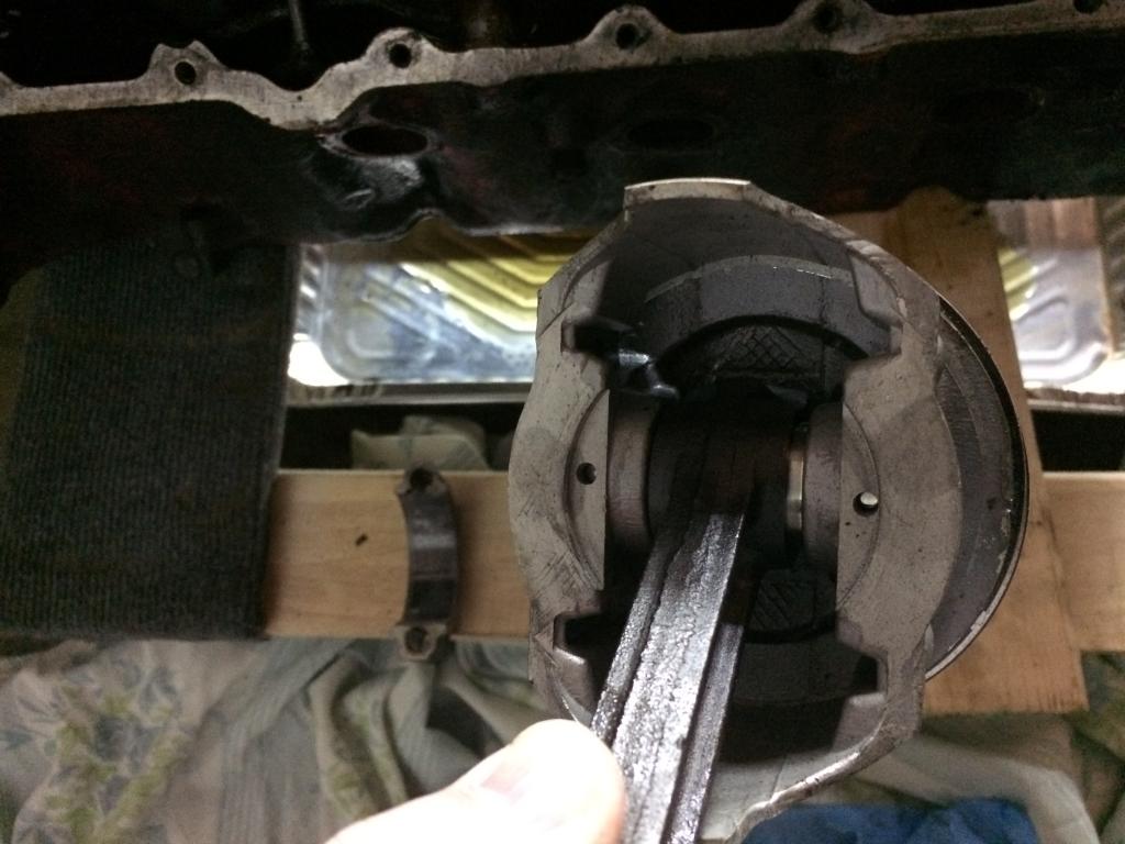

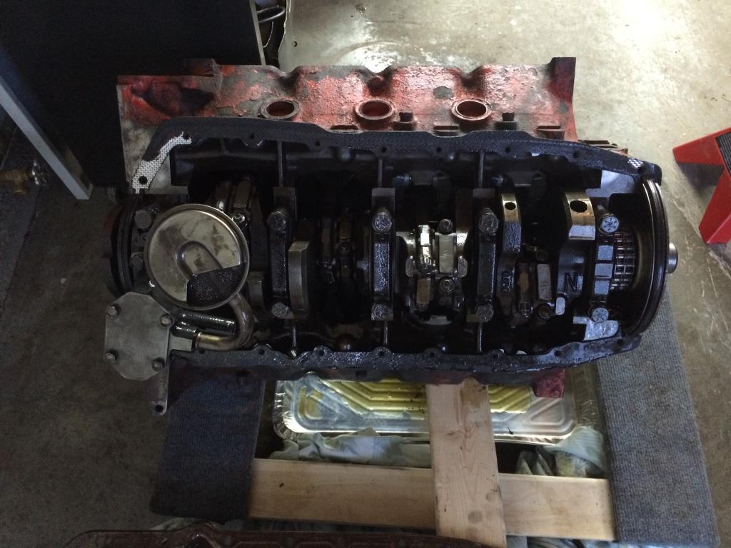

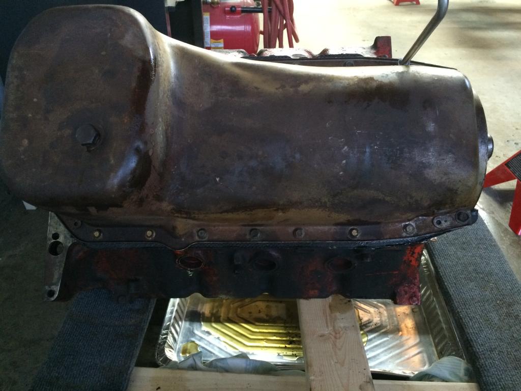

I spent some time in the garage last night:-)
Removed the:
Water pump
Harmonic damper
Timing cover
Oil pan
And one piston and rod

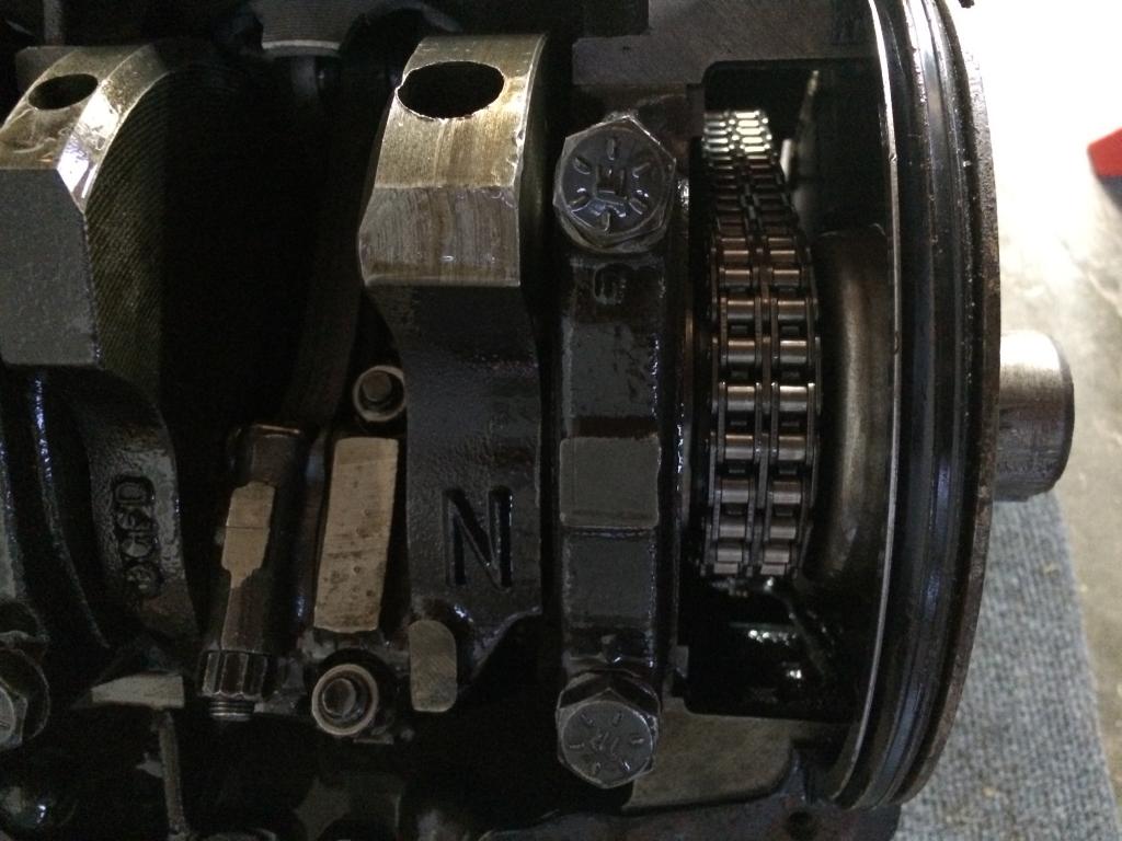

Found the bottom end to be clean, rotate freely, and has been rebuilt previously. The Pistons are 0.030" over and the timing chain is a dual roller.
I was happy with what I have seen so far, looks like a fine candidate for rebuild and use.
Spent a good deal of time cleaning up oil off the floor, I couldn't drain the pan easily and missed the tray I prepared:-(
I will contact the machinist to see what dimensions I should check before disassembly, I took a middle piston out so I can check piston to deck height at all four corners, I also plan to check end play at the thrust bearing.
Ryan

Just a suggestion -- if the .030 out bore will not clean up or out of tolerance you may want to go to .040 out. Your machine shop can hone to that instead of boring to say .060. Also, if something were to "happen" you still have room to bore further. TAZ
  #1606
Old 06-09-2016, 01:14 PM
DW31S's Avatar
DW31S DW31S is offline
Join Date: Dec 2010
Location: Maryland
Posts: 2,103
Thanks: 387
Thanked 296 Times in 190 Posts
Good suggestion. Oldsmobile stuff isn't as readily available as other brands, so "saving" a good '69 vintage block is a wise thing to do.
  #1607
Old 06-09-2016, 02:22 PM
Join Date: Nov 2012
Posts: 5,957
Thanks: 576
Thanks for the suggestion.
0.040" would leave one more boring for future. (My the "interweb" I have read many accounts of sonic checking and boring 350 Olds up to 0.125" without issue so 0.060"-0.070" should be no problem next time.
Ryan

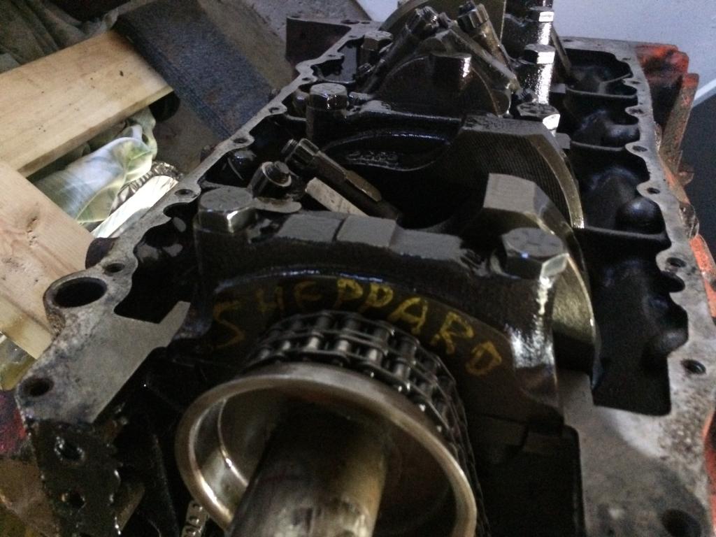

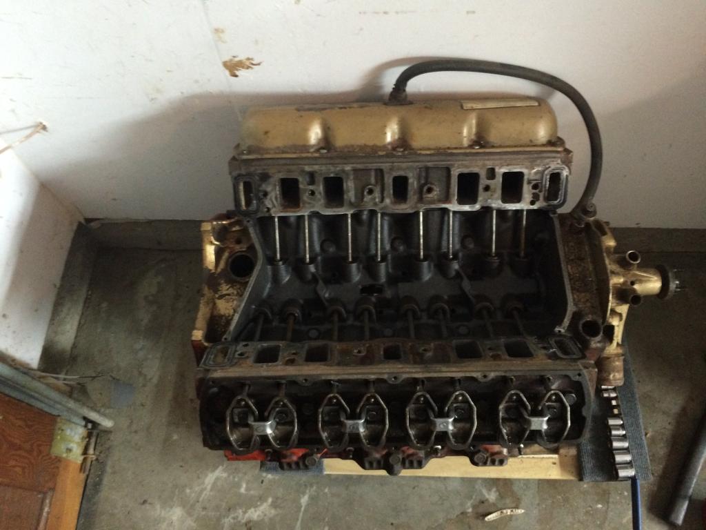

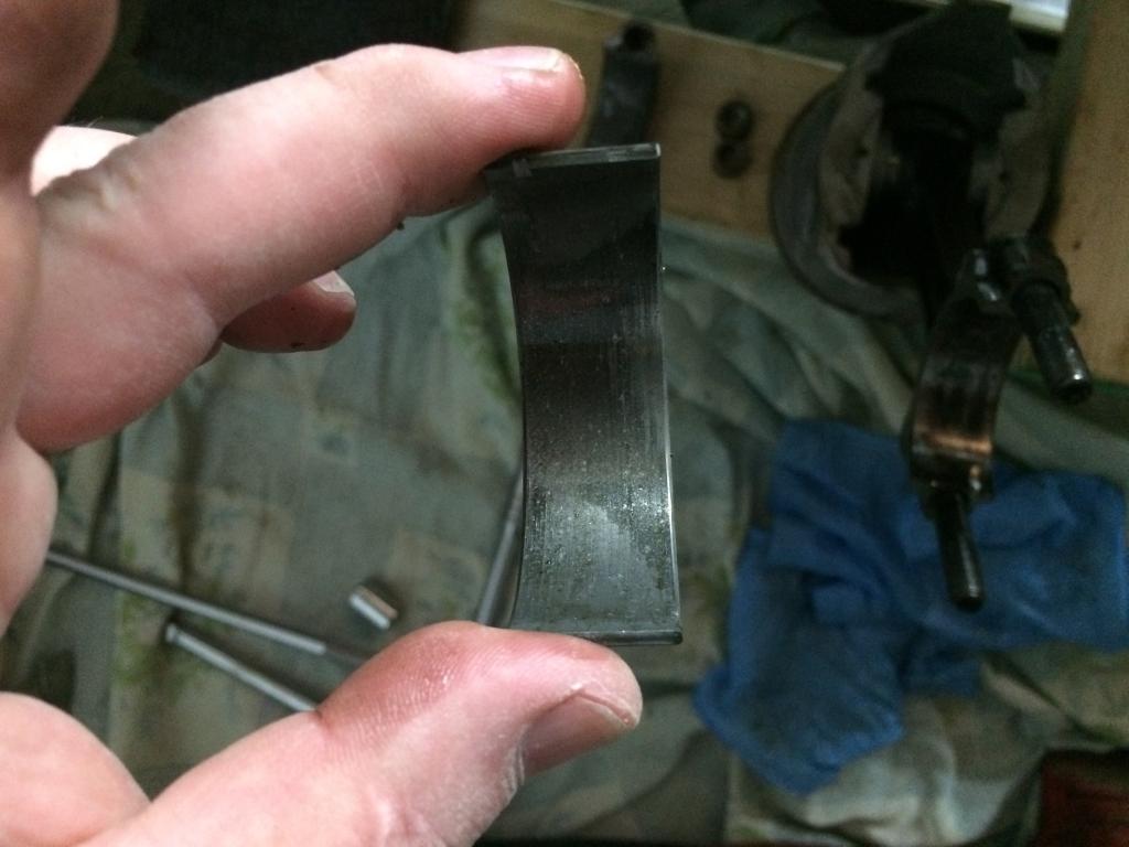

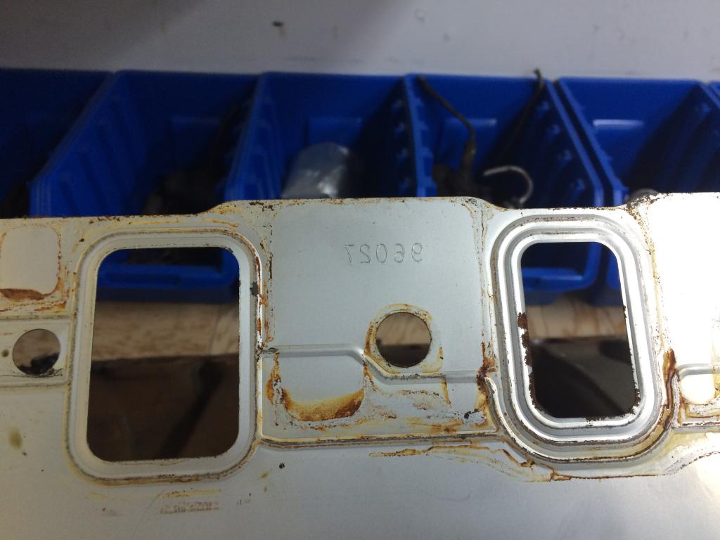

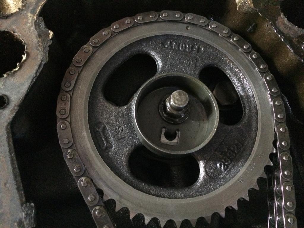

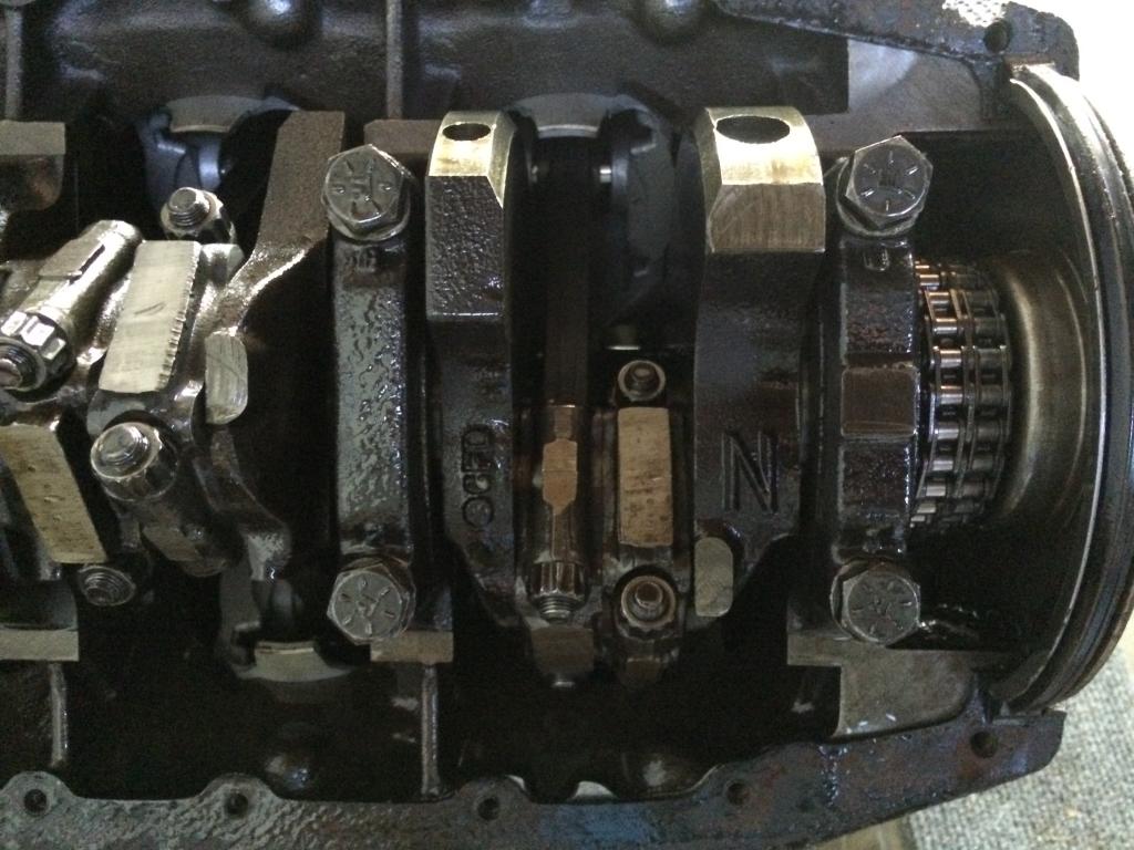

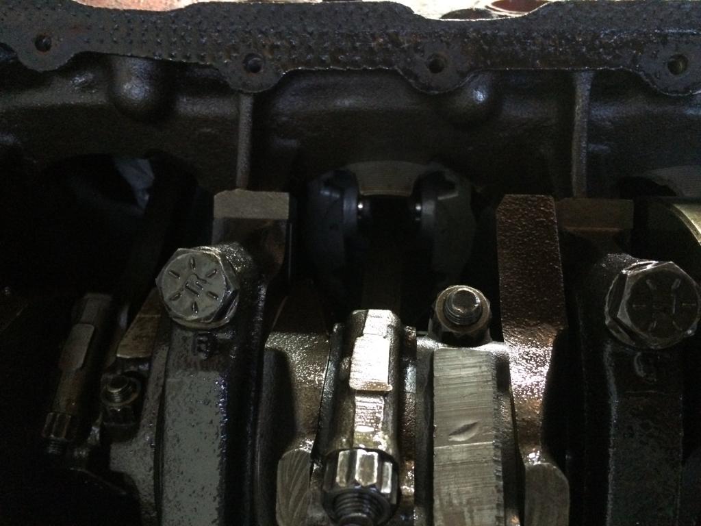

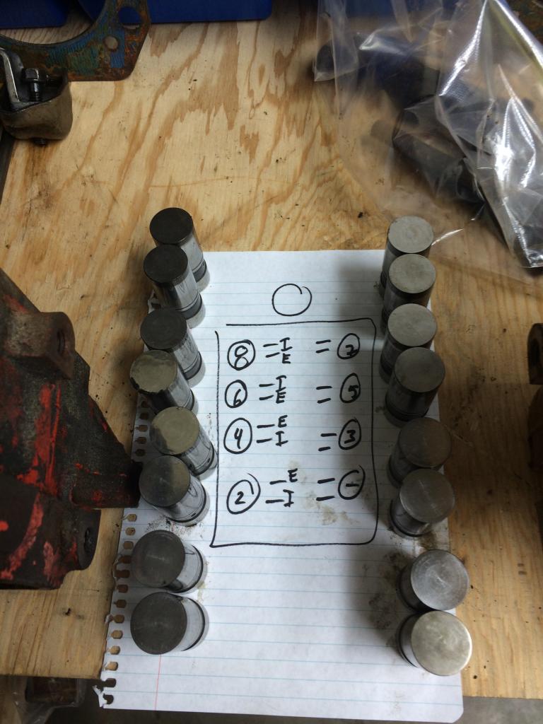

More engine disassembly pics.
Lifters looked new
This is the bottom end of my W31 Warranty short block, I think the timing chain is the original style?
