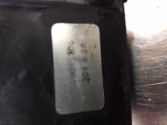

Started working on the wiper motor today among other things. Anyone tell me how to decode this tag? Seems to be an original foil tag that is on the wiper motor housing. Covered in black paint...used some acetone to get to the printing.

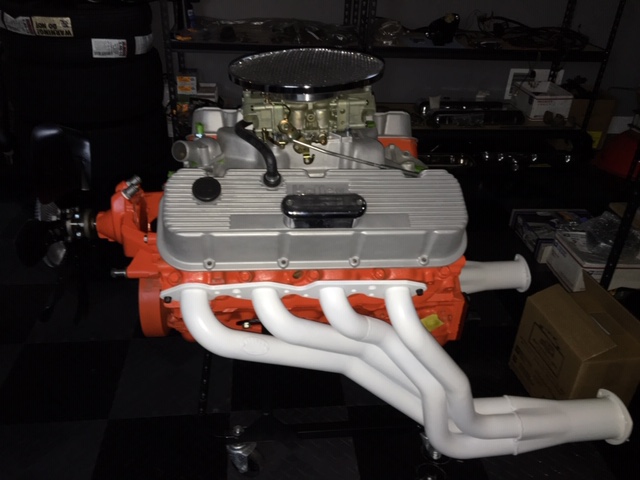

According to NCRS, 9/26/69 is the day my car was built. It was a Friday back then.....probably why they missed the window track mounting nut on the rear drivers side qtr window
Here's a shot in her birthday suit along with a couple of shots just playing around with the engine mockup. Whatcha think.....Stock or Super Stock?

Wow, body and engine look great.

Nice to see some new progress pictures. Those white headers look great. I wish I had the nerve to do that with mine.
