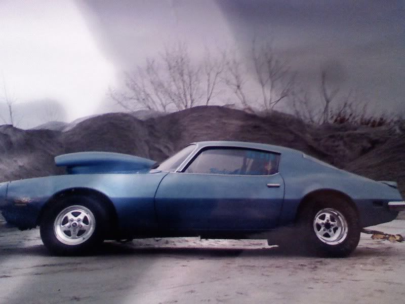

Here are some pics of my car right now
I run a real 1965 dated 427 with GM l88 replacement heads and a real GM L88 cam from 1969. The car ran a best of 10.49 thru the mufflers at 3475#. The wheels always come up.
Back in the day I ran it as a full race car with fiberglass nose and doors and lexan windows,but if you look you will see the low Camaro spoiler on the back.The car is now all steel except the hood and front bumper,has a full interior and all real glass ect.
