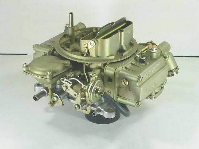

Some of Eric's work:
And a link to the thread about the carb restoration...from the best guy in the business!
https://www.yenko.net/ubbthreads/ubbt...opics/185401/1
