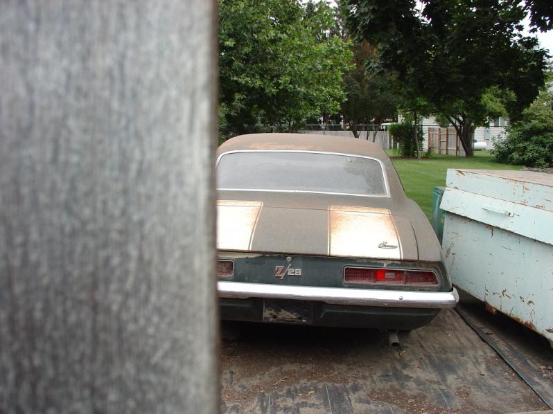

Default Re: 69 Z28 Rear Stripe detail
<div class="ubbcode-block"><div class="ubbcode-header">Originally Posted By: William</div><div class="ubbcode-body">The normative practice was for the rear stripes to be positioned .62&quot; from <span style="font-style: italic">either</span> molding. There are plenty of original paint cars around to verify. The 5.2&quot; dimension shown is likely incorrect. However there were a small number of Van Nuys Z/28s painted that way. I do not know of a Norwood Z/28 with the short rear striping.
</div></div>
Here is one of those LA cars William is refering to. Picture compliments of the Interweb [img]<<GRAEMLIN_URL>>/biggthumpup.gif[/img]

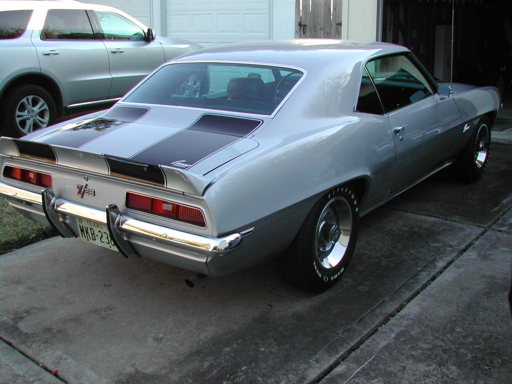

Here is a rear shot of my original paint Norwood 69 Z-28, appears to be around 5/8&quot; gap from the molding. I will get a dimension today.
Paul
Paul
Thanks for the picture. Nice looking ride.
How long have you owned the car?
By the way, who added the right side mirror?
Ervin W
<div class="ubbcode-block"><div class="ubbcode-header">Originally Posted By: 70 copo</div><div class="ubbcode-body">If the stripes pictured are original there are a variety of issues in plant to cause a minor deviation like that.
If that is the way it was I would leave it as is.
IMO..With each car that gets reworked to meet the &quot;normative practice&quot; more of the authentic and unique human influenced detail of the build is then lost to history - forever. </div></div>
I agree 100%...
Here is an early 9B LA never restored original owner Z with the narrow 68 Style rear stripe layout.
~JAG~
I have owned the car for about 6 months. The previous owner added the mirror.
BTW, I measured 5/8&quot; from the stripe to the rear window molding.
Thanks, Paul
