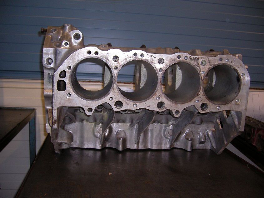

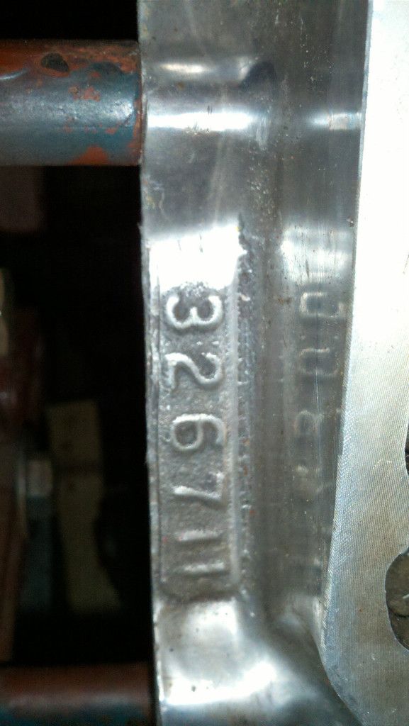

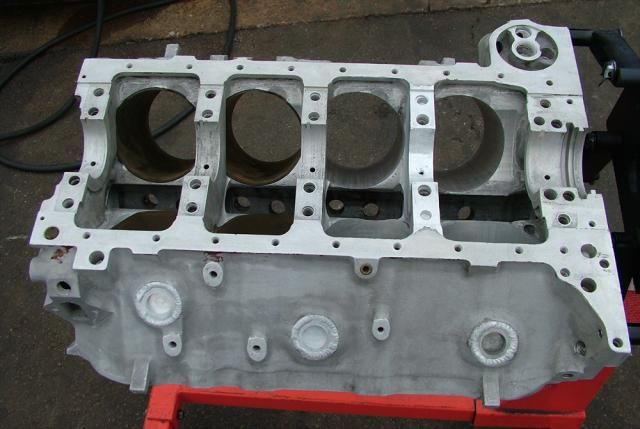

Front, Back. Top, Side.

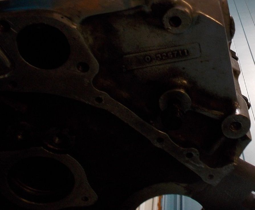

Here is all the info that I have: casting #326711 Reynolds 68/69 Can Am block 4.44" bore with steel liners

<div class="ubbcode-block"><div class="ubbcode-header">Originally Posted By: 69SSZL1</div><div class="ubbcode-body">Here is all the info that I have: casting #326711 Reynolds 68/69 Can Am block 4.44&quot; bore with steel liners </div></div>
Im sorry but thats my Block. not the last Picture.
I wanted to show what Pictures we need to see

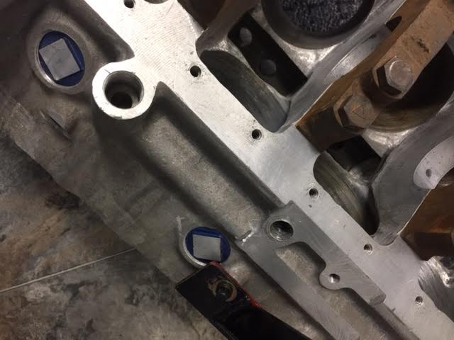

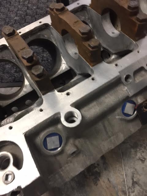

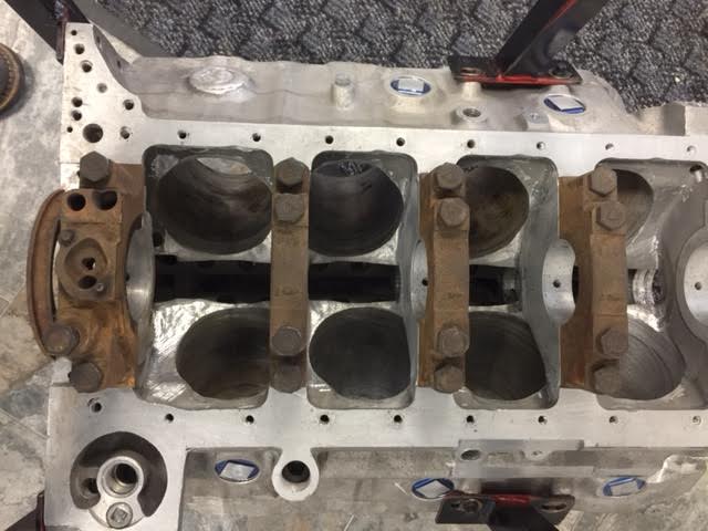

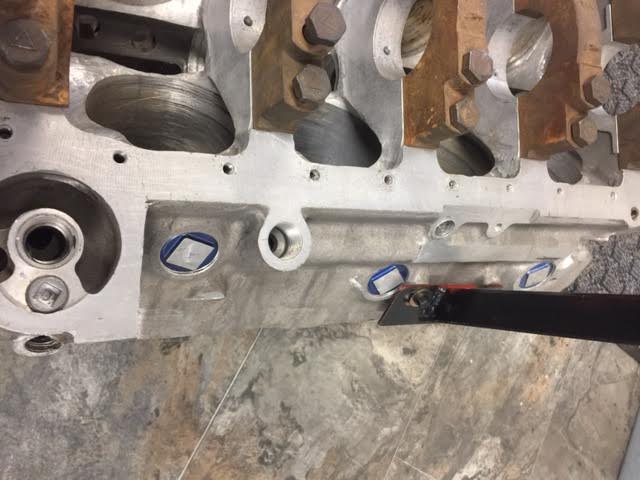

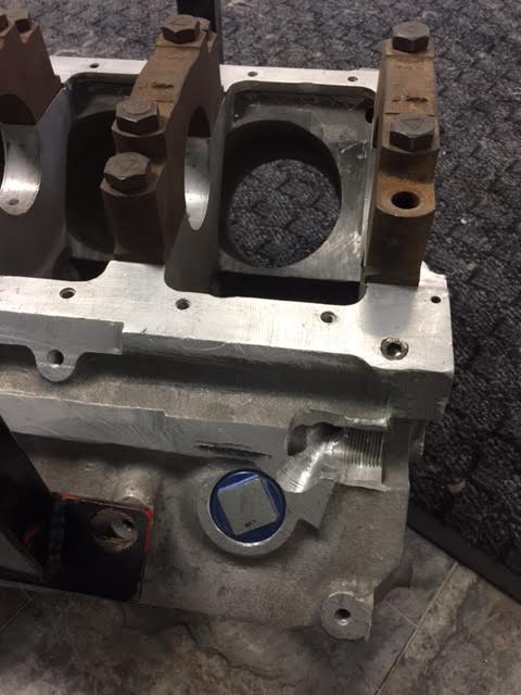

I will take some pictures tomorrow and post them. Guinn was convinced this was one of the early experimental blocks because of the crude casting and no numbers anywhere. Not quite sure what happened to him. Also, the fact that it was a dry sump block with the fuel pump boss and liners. Will post pics tomorrow!

here are some more...
