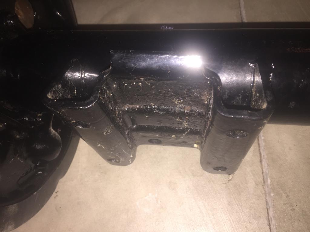

Does it have multi leaf or mono leaf perches. I do not see the mount for the 67 traction bar

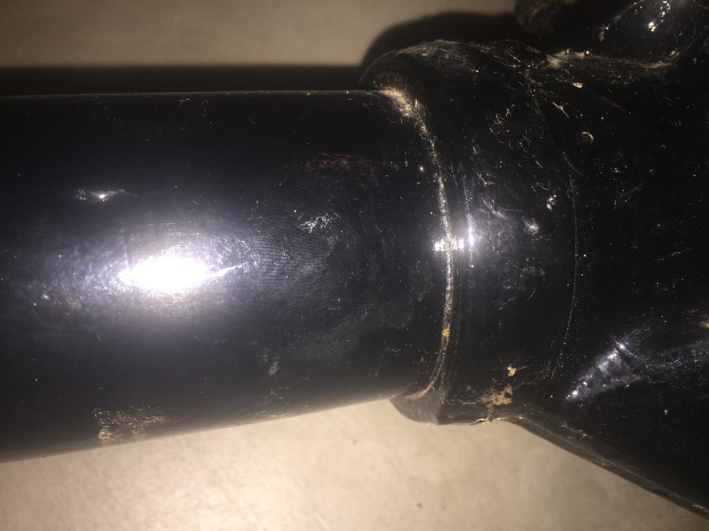

Can you post a pic of the axle tubes going into the center section? BTW Im not a fan of the stamping but I could be wrong at this point..

Looks like a 67 axle. Should have monoleaf perches.
Is there evidence a radius rod bracket was attached? http://www.camaros.org/radiusrod.shtml

It does not have the bracket for the traction bar. I'll get pics of the the spring mounts.

By that date, a 4.10 axle should have a bracket.

Here are the axle tubes and the spring mounts

After a lot closer inspection it looks like the traction bar bracket had been removed.
